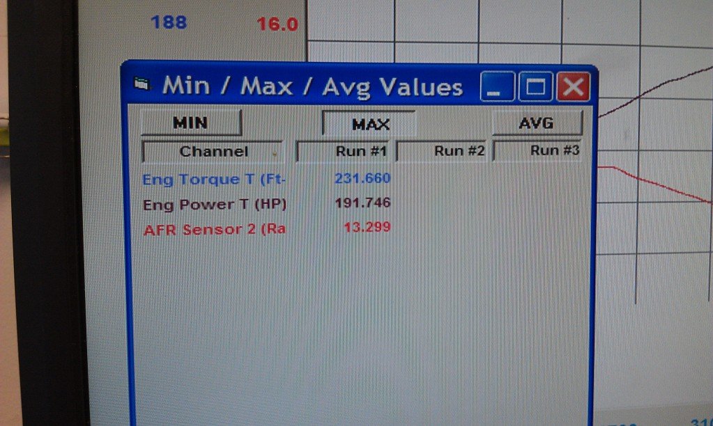

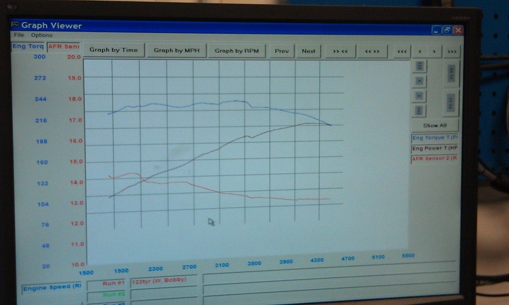

    Mustang Dyno base run on stock XRunner of Scoutdeed69: 191.7 WHP 231.6 WTQ

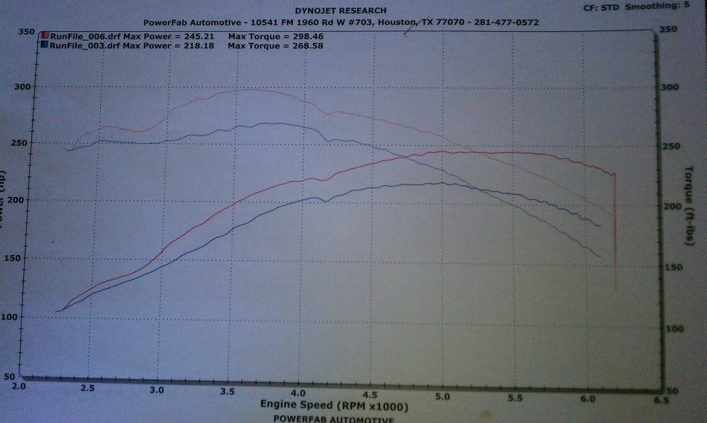

    DynoJet of Nupeprime's XR:
    Red file: current mod list on 93 pump, jba lt, APR y-pipe, URD fuel pump & 3" Maggie w/res
    lue file: before exhaust upgrade... with only TRD intake, NST pulleys, and APR X-1
    218 WHP 268 WTQ
    245 WHP 298 WTQ

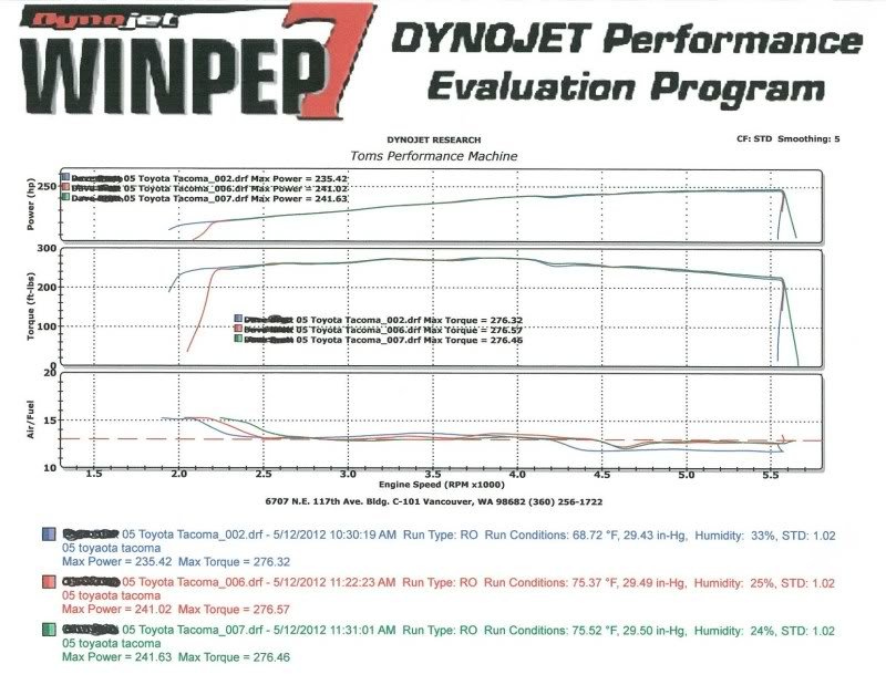

    sixstringdaves's XR on a DynoJet:
    Mods: Hayden E-fan ~ NST Pulley ~ URD Shifter ~ TRD cai ~ 2.5 inch Magnaflow Catback and Resonator ~ Doug Thorley LTs ~ URD O2 sim ~ Tuned URD Maf Cal
    241 WHP 276 WTQ

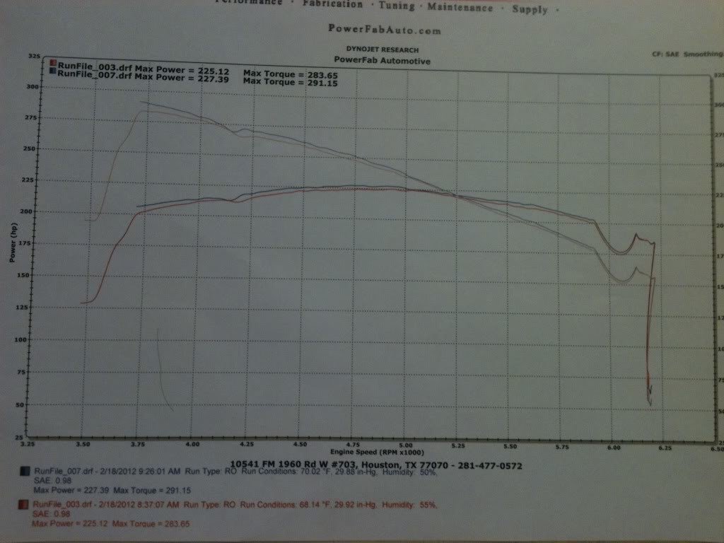

    Lucario Runner's 4Runner on a DynoJet:
    1. AFE intake
    2. APR X1
    3. NST intake manifold spacer
    4. TB coolant bypass
    5. Doug Thorley long tubes
    6. URD fuel pump
    227 WHP 291 WTQ
    EDIT**** Lucario Runner's after the addition of the URD Y-Pipe. Take special notice of the gains at the end of the curve. HUGE Increase in HP and TQ.

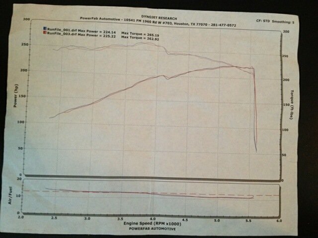

    Motonxruchick184's XRunner on DynoJet:
    TRD Gen 1 CAI
    NST Pulleys
    Magnaflow muffler
    (Will update with new dyno including JBA short tube headers and JBA catback)
    225 WHP 262 WTQ
