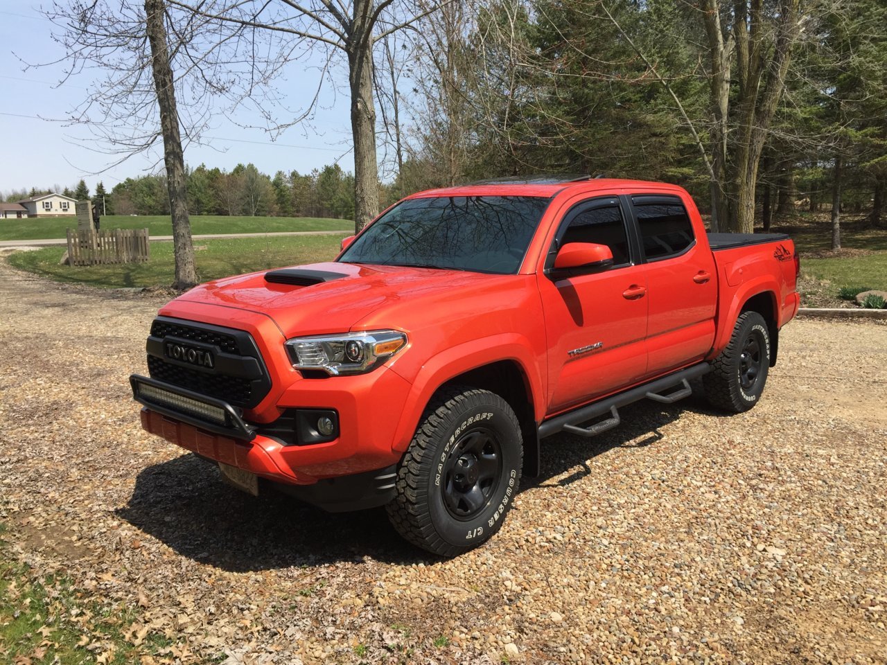

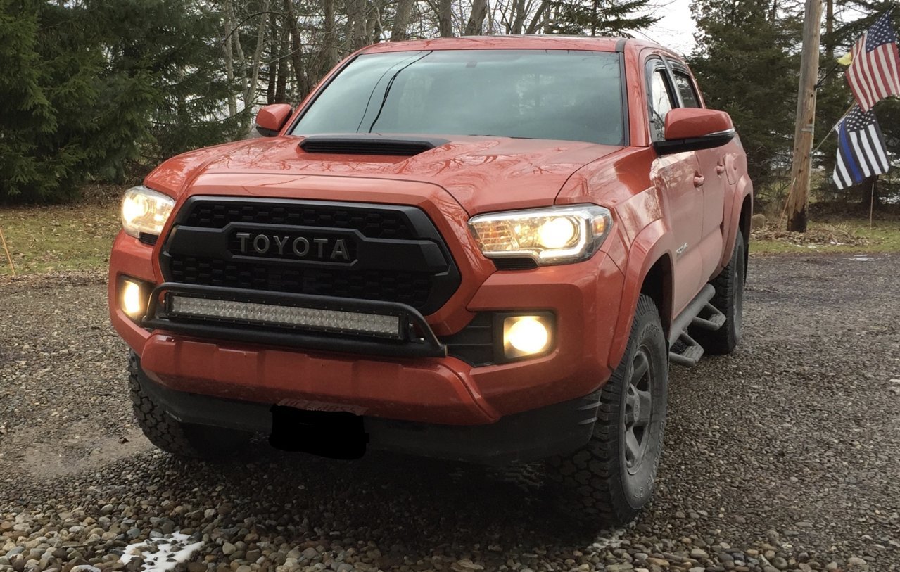

    Ok, couple more questions. So the parts that you actually cut and that can be cut with the hack saw blade, without removing the lower grill, what parts are those again? Do brackets come with this mount that attach to the truck to the two existing bolts on the outboard side of the aluminum impact attenuator? Then you attach the light bar mounting assembly to those brackets? And those brackets require cutting the air flow channeling trim pieces? Also, you originally said you had the mount forward as far as it would go. Did you ever move it closer to the grill? Oh, and I'm sorry for all the questions, did you have to relocate your license plate and remove the OEM bracket to mount this product?
    Thanks again Doug. :thumbsup:
  20. May 29, 2018 at 8:53 AM
    #40
    smugly
    smugly [OP] Well-Known Member
    Jul 20, 2015
    #159900
    5,425
    Doug
    2005/2009/2016 4x4 TRD double cab taco, and now a 2024 Trailhunter
    some and more and more and more and
    The questions are fine, that’s why I started the thread!
    I will try to answer them in order. The first question, the part you’re not removing and are cutting with the hacksaw blade, is the lower grill that the light bar mount is passes through. And I cut just a sliver out of the horizontal rip to let the bracket pass through.
    Yes all of the mounting brackets come with the N-fab light bar.
    Yes the airflow channels do need to be cut for clearance of the brackets in behind the front grill, but where I show it being cut not the way they show it so that you can still use all of the locking tabs that are originally there.
    I ended up leaving the mount out all the way forward like I started.
    I had originally mounted my license plate where you see it. So that was not an obstacle for me, but it does look like it would clear.
