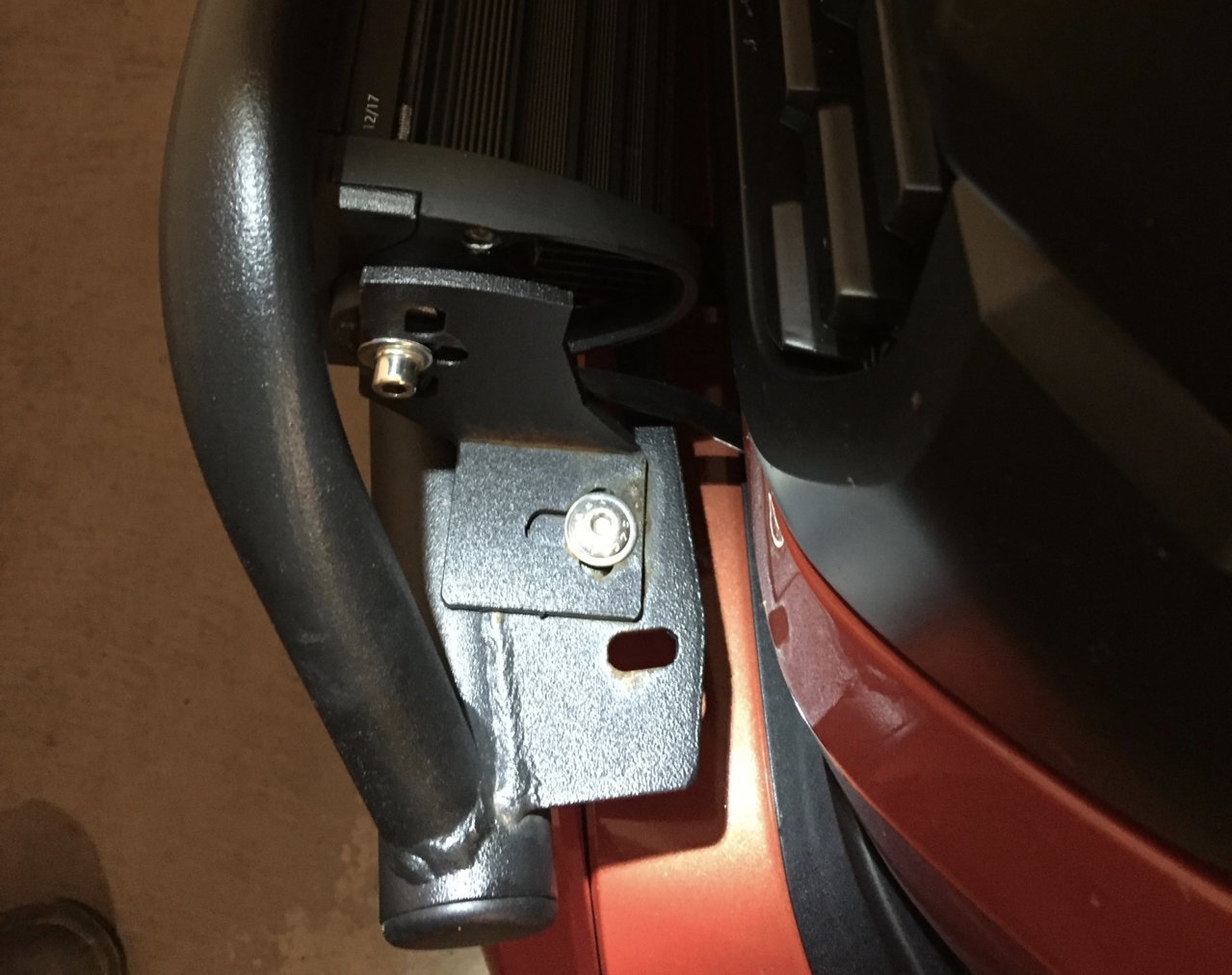

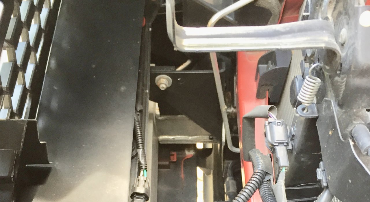

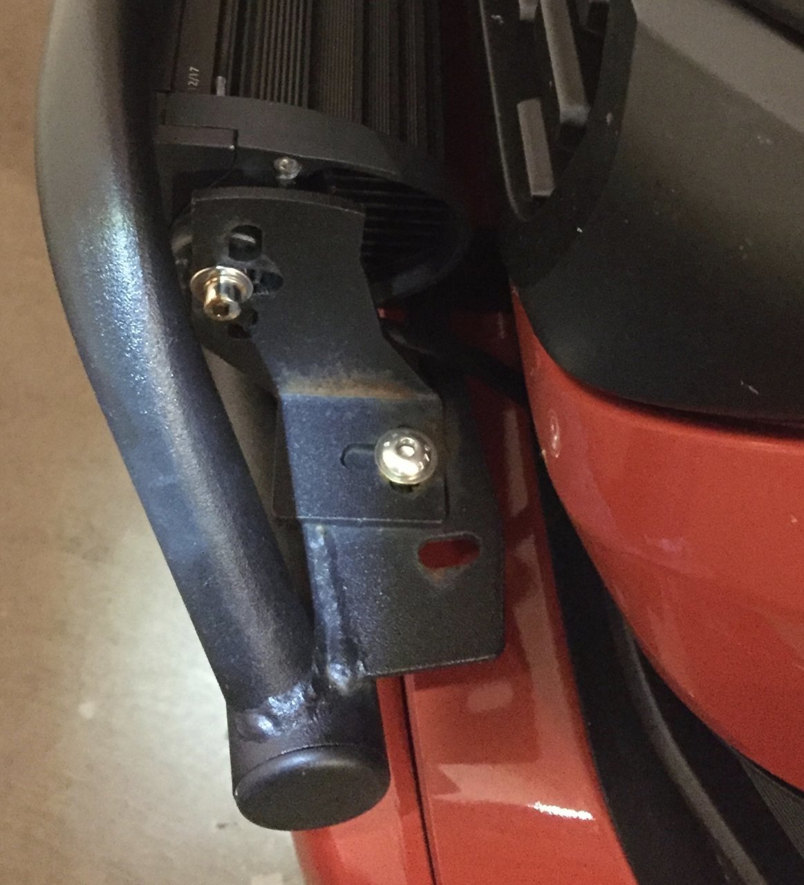

  4. May 29, 2018 at 1:47 PM
    #64
    smugly
    smugly [OP] Well-Known Member
    Jul 20, 2015
    #159900
    5,425
    Doug
    2005/2009/2016 4x4 TRD double cab taco, and now a 2024 Trailhunter
    some and more and more and more and

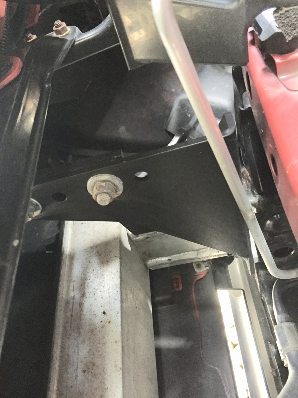

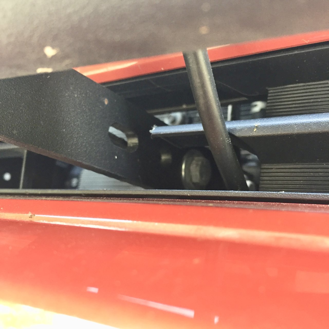

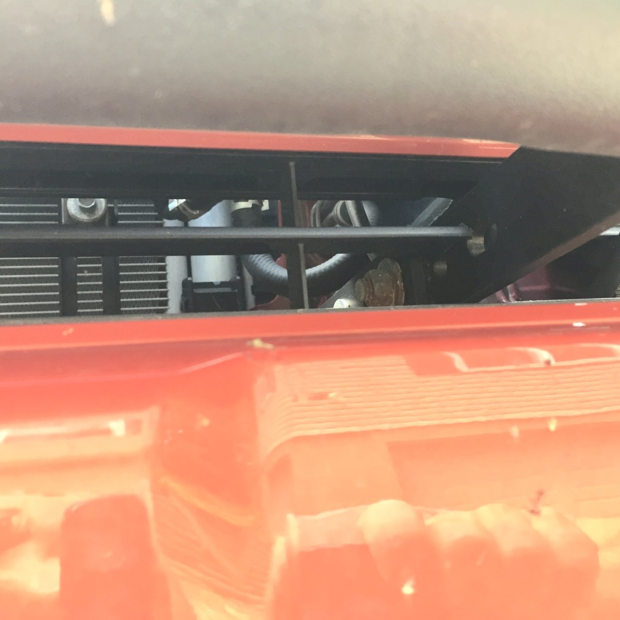

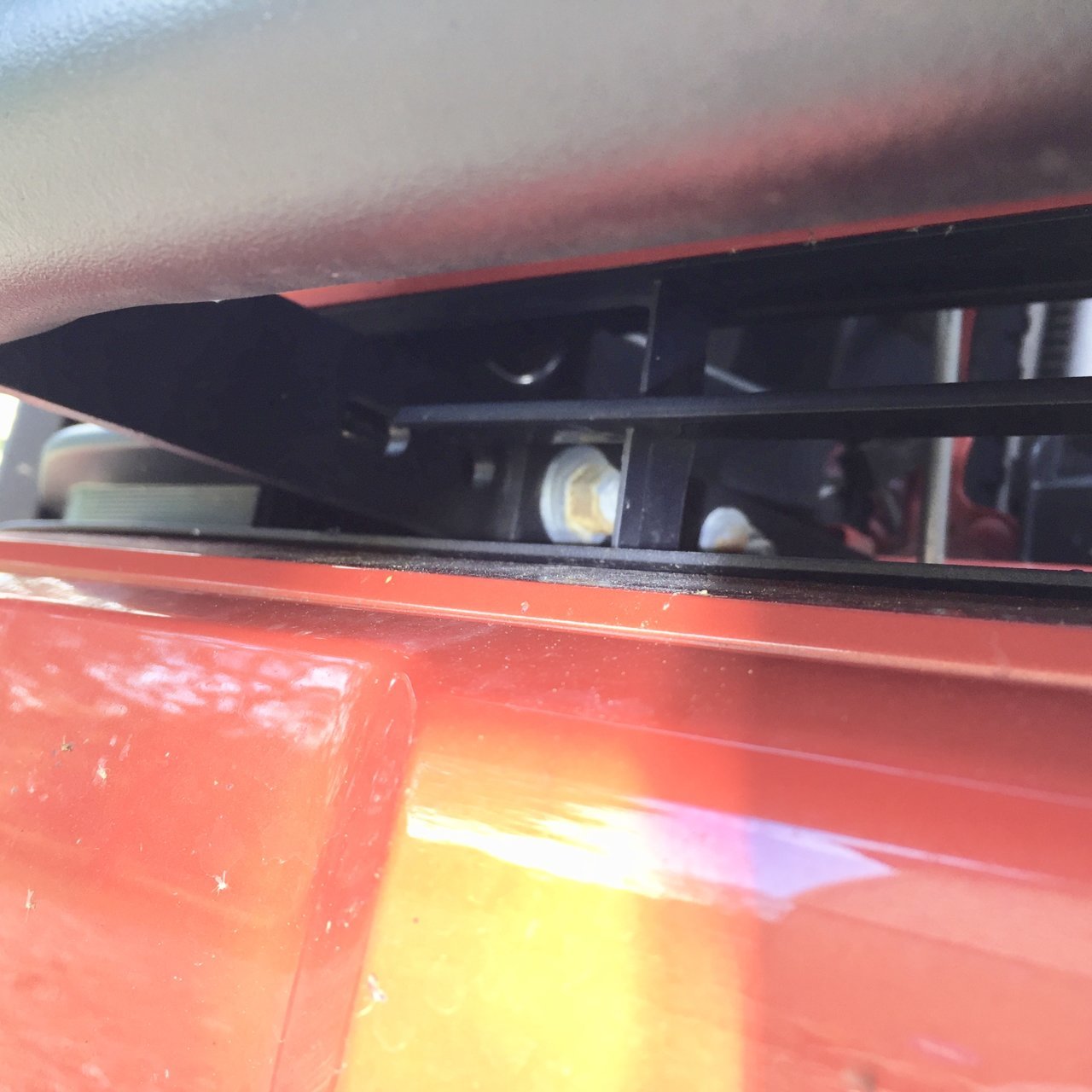

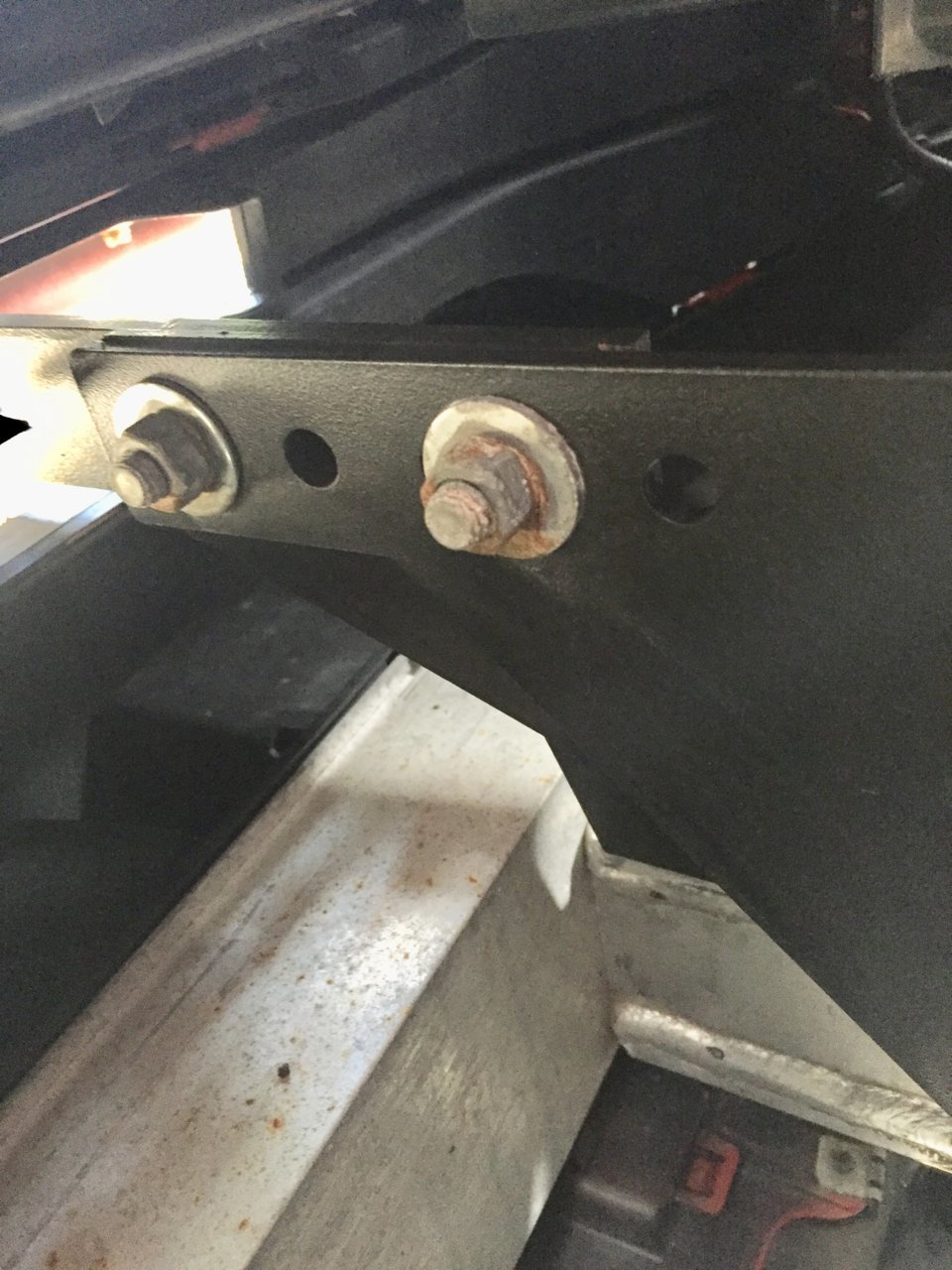

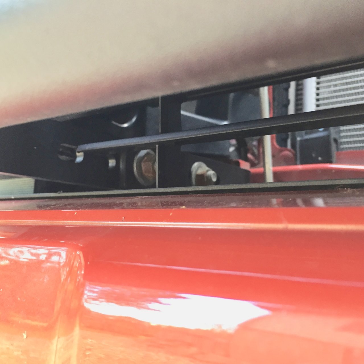

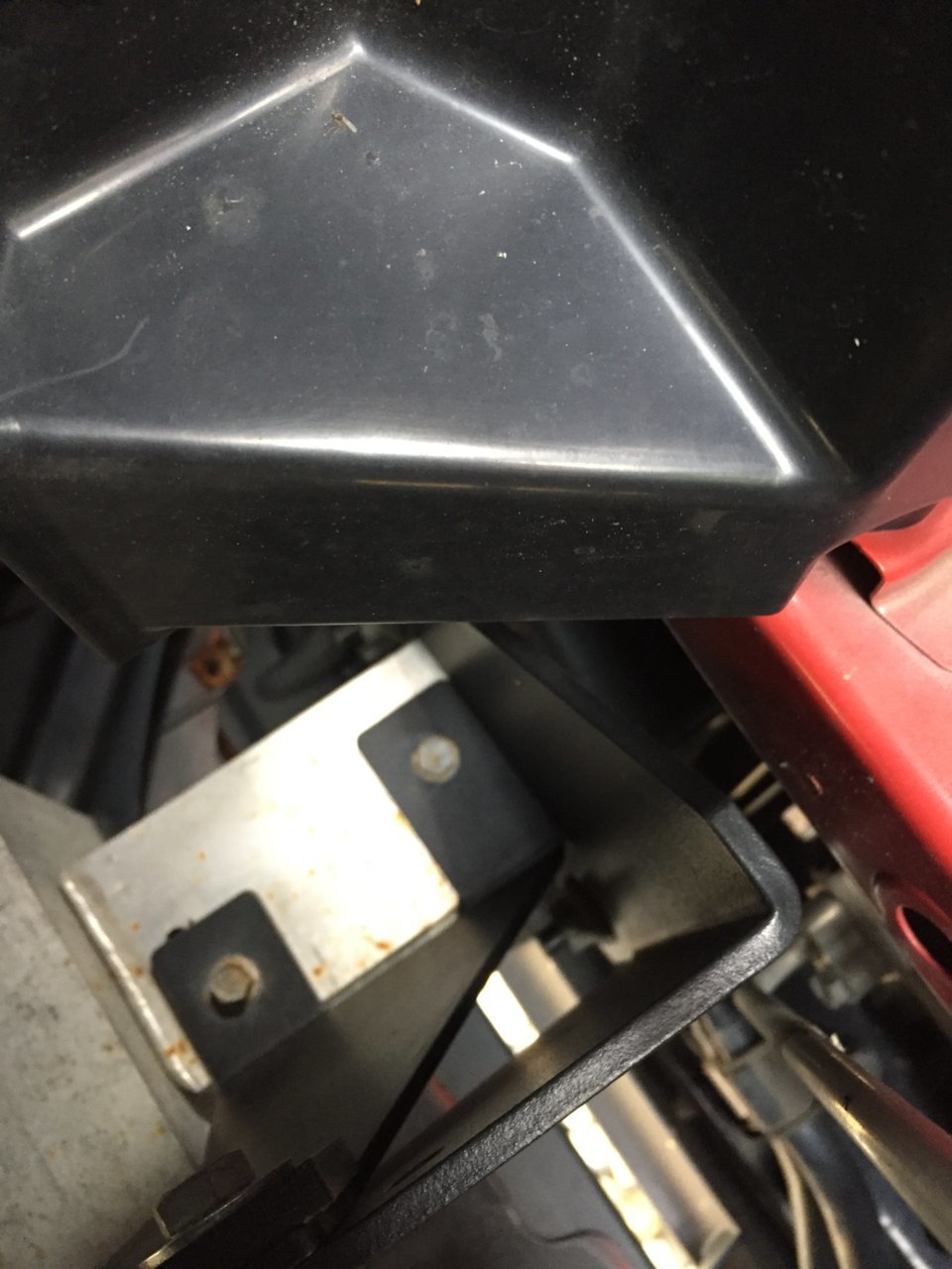

    IMG_0273.jpg IMG_0274.jpg fullsizeoutput_ca0.jpg fullsizeoutput_c9e.jpg fullsizeoutput_c9f.jpg fullsizeoutput_c94.jpg IMG_0287.jpg fullsizeoutput_c93.jpg fullsizeoutput_c92.jpg fullsizeoutput_c95.jpg fullsizeoutput_c97.jpg fullsizeoutput_c99.jpg fullsizeoutput_c9c.jpg

  6. May 29, 2018 at 1:51 PM

    Ok, that's what I thought you were talking about. "Tubular" sorta threw me for a minute. So it sounds like these screws are the last thing to be drilled in then?

    Yes, in the 7th photo down you'll see the 2 screws

    hopefully the photos help. its kinda hard to get in there now that everything is back in.
  9. May 29, 2018 at 2:03 PM

    ok Bro, these are freaking excellent shots!!!!!!!! Now I get the idea!!! So what I thought were two long slots in that mounting bar that goes through the lower grill are actually just a bunch of holes used for different distances front to back! Way cool! Now I see exactly where you had to cut that lower grill center rib. Perfect.
    I also see how the bracket attaches to the vertical member of the radiator support sub-frame and the aluminum crash bumper sub-structure. Man, this is like I am there looking in!!! Perfect Doug, thank you so much!!!

    I have a one-row slim light bar I was going to use for this, rather than pulling the trigger for a dual/quad row lightbar. Confirm there's several different points (maybe 3) on the NFAB bracket (the free ones they send out) so you can set the level on how high you want the lightbar mounted?[/QUOTE]
    yes there is slots all the way across the back of the bracket so you can mount individual lights also like one guy did in our photos. and yes, you'll have to repaint them at some point

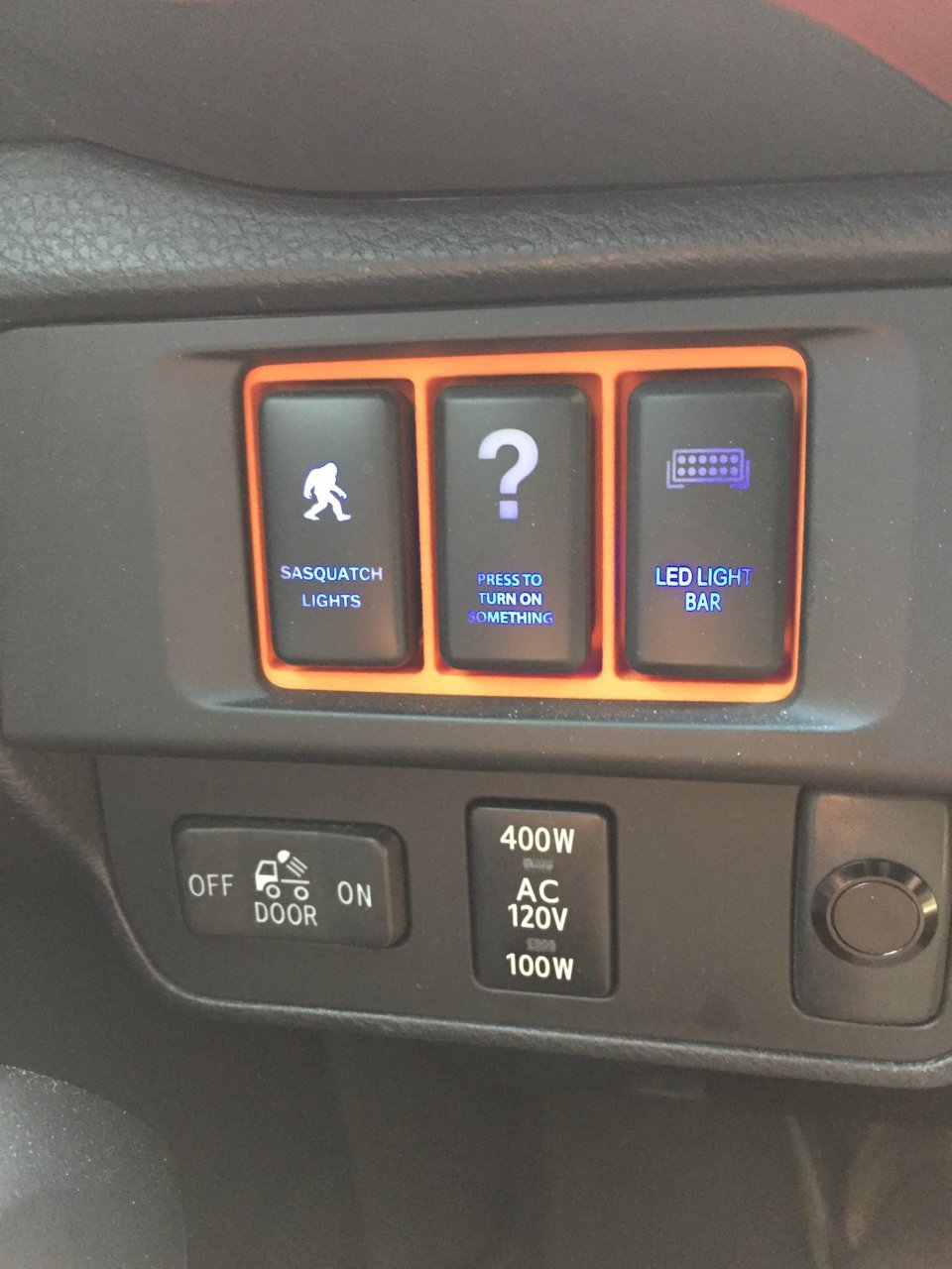

    Doug,

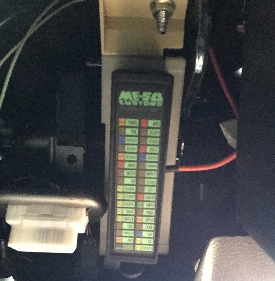

    Oh, Love the Press To Turn On Something switch! One of my favorites!!!! I haven't made up my mind if I will ultimately wire both to one switch or go with two. The switches that come with the light bars are ok, but you know we need to mod shit. I have one blank and this will most likely be the end of my lighting mods for a while so I could wire them both to one CH4x4. If so I will pay the $30 bucks to have them make me a custom switch with both lights shown. If I feel like I can just attach the brake controller to the dash panel down by my right knee with heavy duty velcro how I had it in my Tundra, and I feel like I will have more lights, I will just buy a Meso switch panel for that cubby area.

    yes, you actually take the bolts out that hold the bumper on and the main bracket gets put there and the bolt go back in. also with the light I chose, with the bracket all the way out. the back of the light barley cleared the front of the truck, so I notched there L brackets little more than they even had it.

    Thanks for the offer. Let me see where this takes me first. It is tempting though. I see you made your blank into the garage door opener mod. I have thought about doing that myself. So many mods, so little time. I still have an extra set of door badges and all the supplies to paint them and the chrome tip just waiting to be done. I also want to take that left roof rack rail back off and check the tab insert connection. I feel like there is a some play in that and the roof mounted led bar I have mounts to brackets that are riveted to that. That has to be 100% before I can mount that 42" bar up there.
