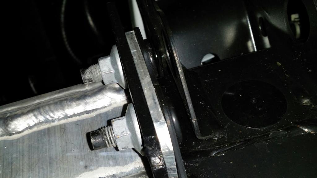

    I'll do my best to explain this. I took these pictures at night with my phone so you may or may not be able to tell what you're looking at. If so, sorry about that. I'll try to get better pictures tomorrow. You Do Not need to remove the lower valance to get to the bolts. They are semi hard to remove but not overly so. Please don't take this the wrong way but make sure you are turning them in the correct direction. I only say this because when you are laying on your back and looking at things upside down it's easy to do. I'm not saying you are just pointing out that I've done it before.
    Passenger side nuts you need to remove. You should have enough room to get a socket or wrench in there to remove them without any issue.

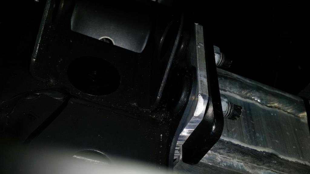

    View from the top of the passenger side with the bar installed on the mount bracket

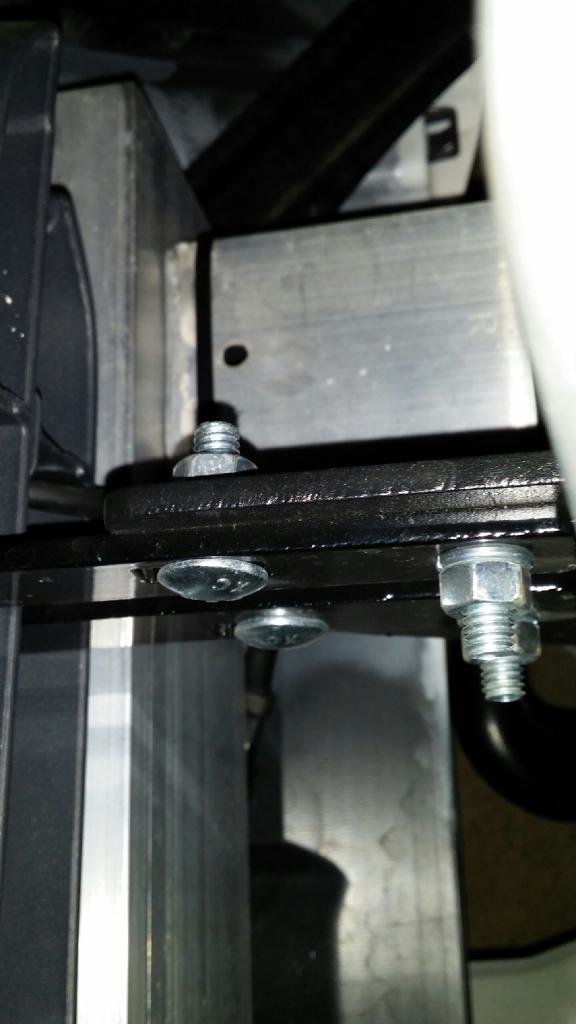

    Drivers Side Nuts that need to be removed just like the passenger side.
    Same thing, Place the "L" shaped bracket and replace the nuts but not completely tight. put the bar through the lower valance (it will make sense when you see it) and bolt everything up.

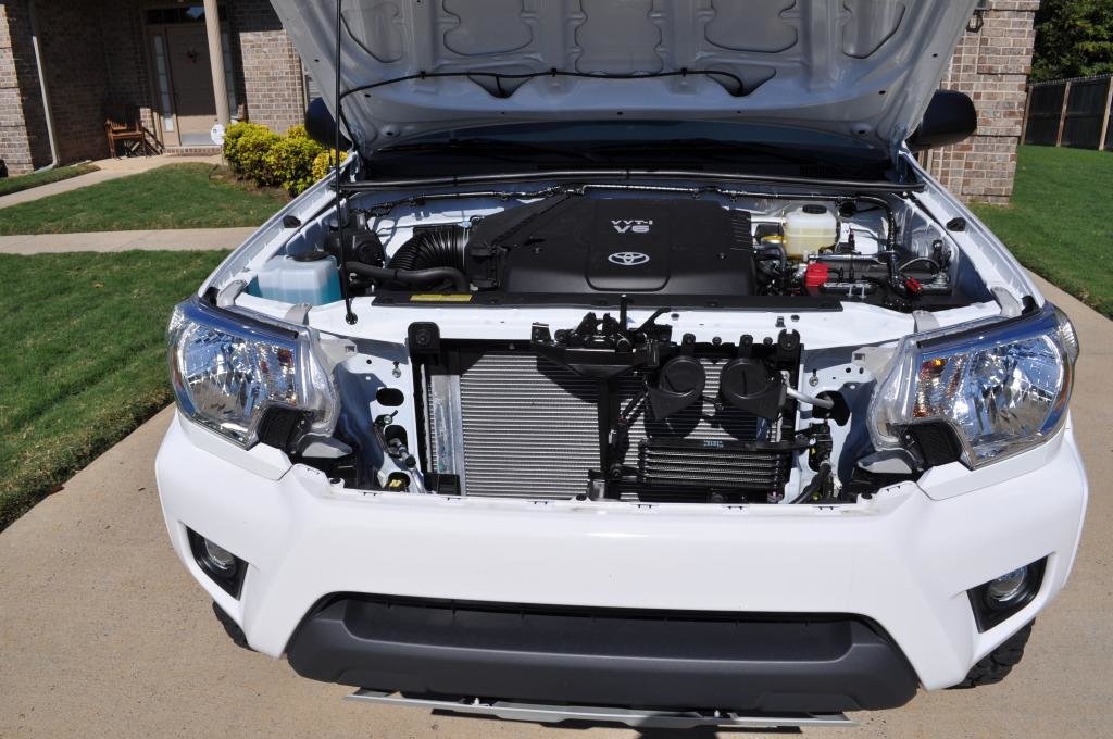

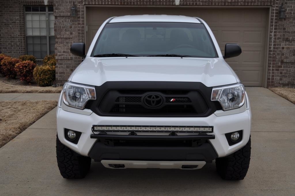

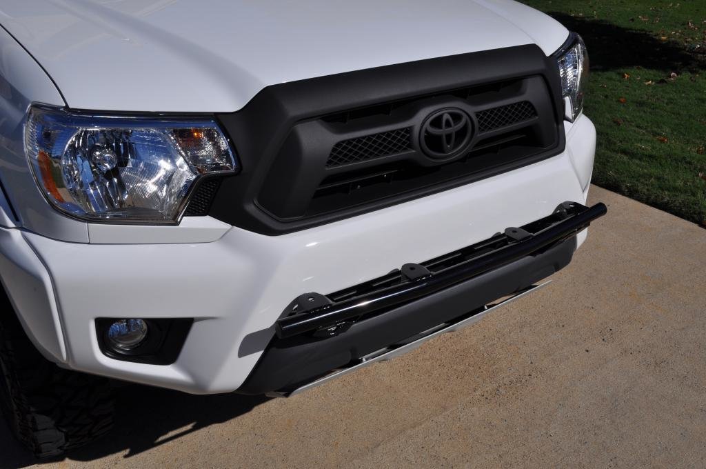

    What it should look like once it's in place

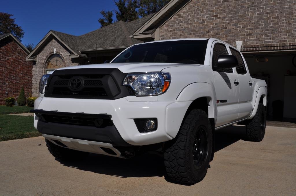

    Then with the light bar mounted

    One thing I forgot to mention. It makes it easier if you remove the grill while installing the bar. Just gives you that much more room to work with.
    Two bolts and two plastic "Push Tabs" hold the top of the grill in place. On the bottom of the grill there are two tabs on each side. Just kind of push down on the tab and pull the grill toward you. You might have to pull kind of hard and it will sound like you broke something. You didn't It's normal.
    You can see where the tabs are on top of the bumper in the pictures

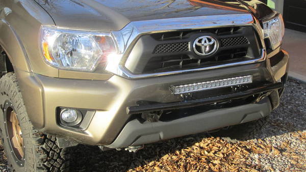

    Thanks again for the assist. It came out pretty good I think.
