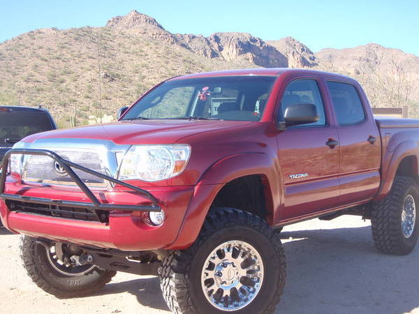

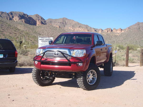

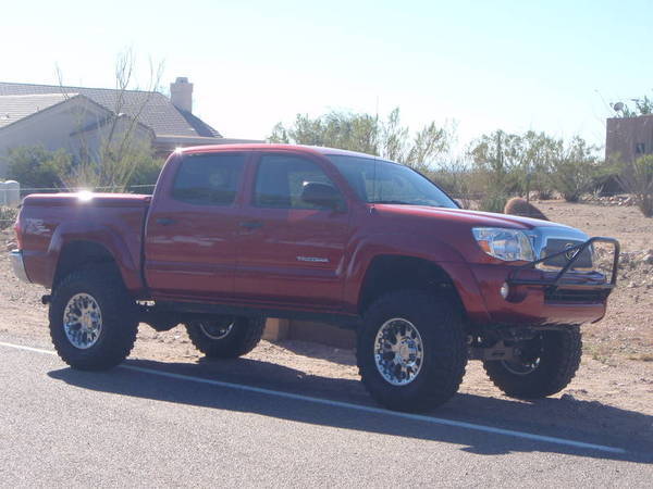

  12. Dec 9, 2008 at 1:45 PM
    taco@you123
    taco@you123 [OP] Well-Known Member
    May 30, 2008
    #6989
    263
    mesa, arizona
    07 toyota tacoma prerunner sr5 with
    6" pro comp lift, moto metal rims, front grill
    heres a couple of pics of my truck with the prerunner light bar, i still have to get the lights.

  14. Dec 9, 2008 at 1:57 PM
    Dark Knight
    Dark Knight Well-Known Member
    Jul 18, 2008
    #8006
    9,613
    Jeff
    NC/SC
    4Runner Trail
    the brackets go on the outside of the aluminum cross bar right behind the bumper, then the bar slips through the lower grill and bolts with two bolts on each side. I'm pretty sure the brackets on both sides of the aluminum cross bar mount with the bend towards the inside. If this makes sense, the part that the actual Pre-Runner bar mounts onto will kinda reach upward toward the opening in the lower grill from its mounting point at the side of the aluminum crossbar.
