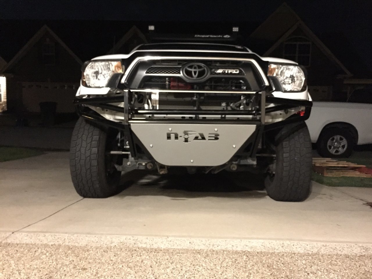

  3. Jun 28, 2018 at 12:39 PM
    #23
    qjwright
    qjwright Well-Known Member
    Jun 9, 2017
    #221077
    97
    Quintin
    2015 black Tacoma TRD sport
    Did you have to cut off the drivers side tow ring?
  4. Jun 29, 2018 at 4:57 AM
    #24
    TreyStewart
    TreyStewart Well-Known Member
    Feb 7, 2015
    #148140
    276
    Trey
    Tigerville, South Carolina
    2013 PreRunner
    URD everything, nfab front bumper with 2 LED bars, maxtrax spindle lift, Baja rack
    No... You need to get some heavy duty washers to space out the bumper. Then it will fit. That's what I had to do with mine
  5. Jun 29, 2018 at 6:21 AM
    #25
    qjwright
    Jun 9, 2017
    #221077
    97
    Quintin
    I wasn’t even able to get the right side of the bumper on to th mount at all because of th tow ring, I called nfab and they said cut it off, but I’ve seen other 2nd gens that didn’t have to.
  6. Jun 30, 2018 at 7:19 AM
    #26
    qjwright
    Jun 9, 2017
    #221077
    97
    Quintin
    Does your bumper hit your fenders when you go over bumps on the road?
  7. Jul 13, 2018 at 4:15 AM
    #27
    TreyStewart
    Feb 7, 2015
    #148140
    276
    Trey
    2013 PreRunner
    Yes... That's why I got the spacers so they wouldn't rub
