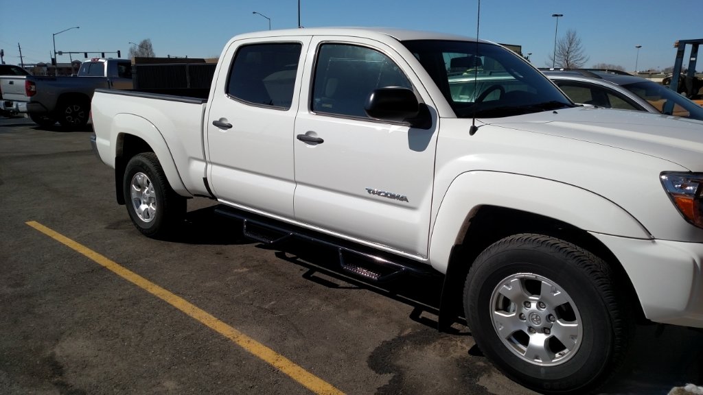

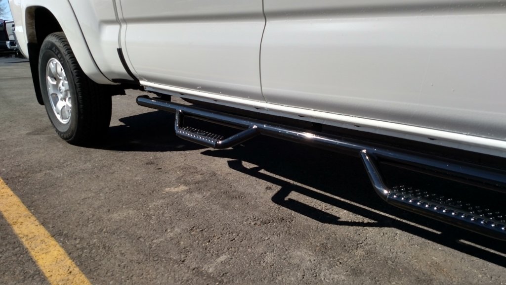

    Hey Taco fans! I just installed a new set of N-Fab 2" Nerf Bars on my 2015 Tacoma Double Cab. I haven't seen a ton of up close photos of these installed on Tacomas so I thought I'd post some to share.
    I ordered mine through Amazon.com for like $329 with free shipping. Arrived very well packaged. From unbox to complete install was about half an hour. I'm NOT a handy do it yourself type and this was a piece of cake. All you need is a 13mm Wrench or Rachet/socket. I just parked my truck in the garage, lay down underneath it and hooked it all on myself. Five bolts for each side. Pre-drilled factory holes are already in place. You just pop out the plastic fillers that are fit into the holes (which you can do with your finger tips) and screw the bolts in.
    One piece of advice: lay a blanket down. I scuffed my driver side nerf bar on the concrete floor and left some scratches in the powder coat.
    I've had them on a matter of hours so far. But I like how they look. Should make my kids happy as they complain about having to climb into the truck without a step!

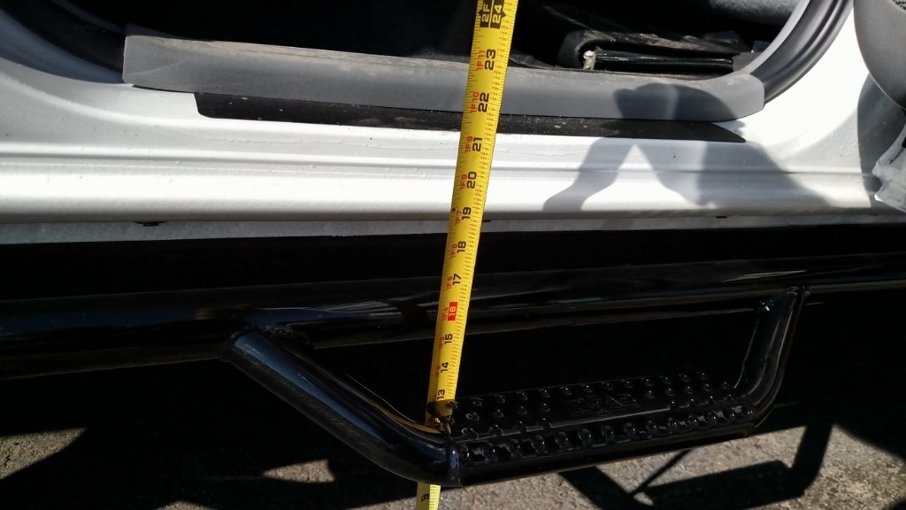

    In case anyone is interested in the height of the step relative to the threshold of the cab here's a photo for you! None of the manufacturers actually tell you how their step measures relative to the vehicle itself. I find this to be kind of annoying. If you're trying to decide which step is going to work best for your needs this seems like an important point.
    It appears to be that you reduce the step height about 9-10" total.
