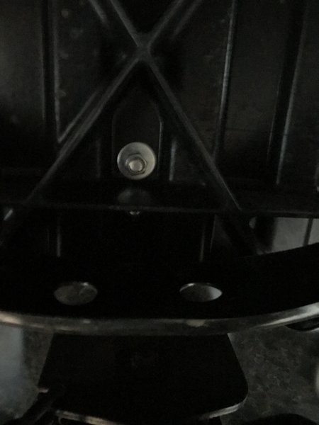

    Hey guys,

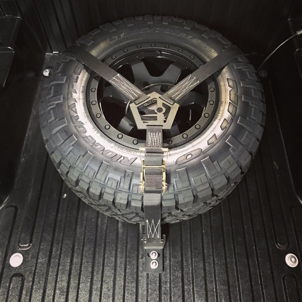

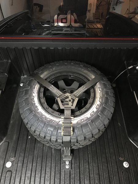

    Just sharing some completed photos on the "N-Fab Universal Bed Mount Rapid Strap" I got on eBay. 99 bucks, no tax, free shipping. I thought about mounting my new spare and tire underneath the car, seems like there's enough space, but it feels a lot heavier than my stock spare so it might snap and break. The other alternative was either new bumper with a spare system, or a tow hitch spare carrier, but the truck would no longer fit in my garage. I think this method doesn't take too much space, nor do I haul during my everyday. I did order my All-Pro bed rack a week or two ago along with the gear rack, so it should tuck away nicely underneath that.

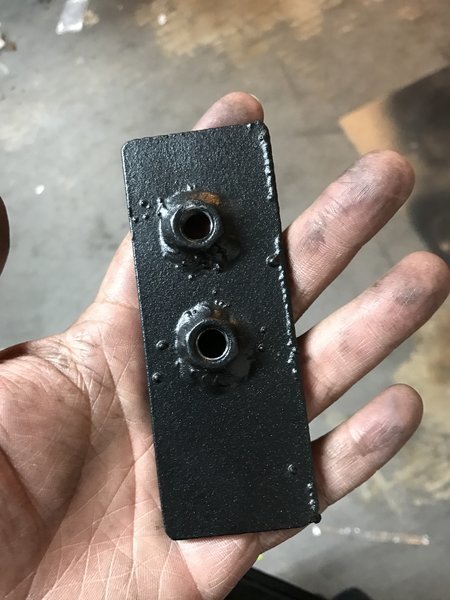

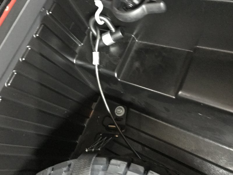

    Again, this is a universal setup. So things might not go to planned, just like it did not with me. I did not use any of the provided brackets that you mount underneath the truck bed (Photo shown above). There is not enough space underneath and you'll see why in the photos below. Even if I were to use them, seems like whoever fabricated the brackets was in a rush. Some of the weld was inside the lock nut.

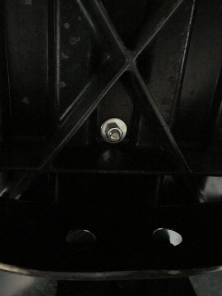

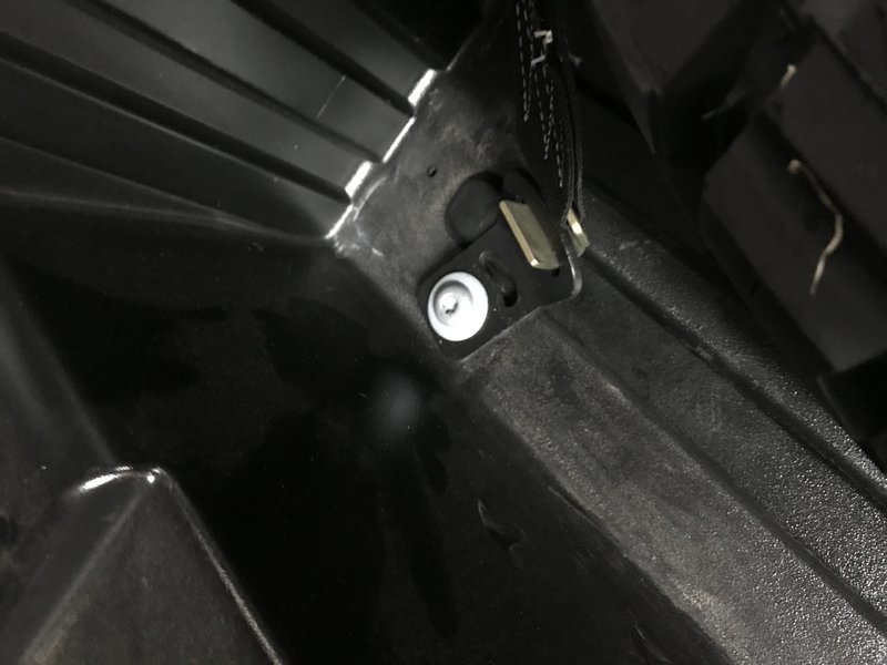

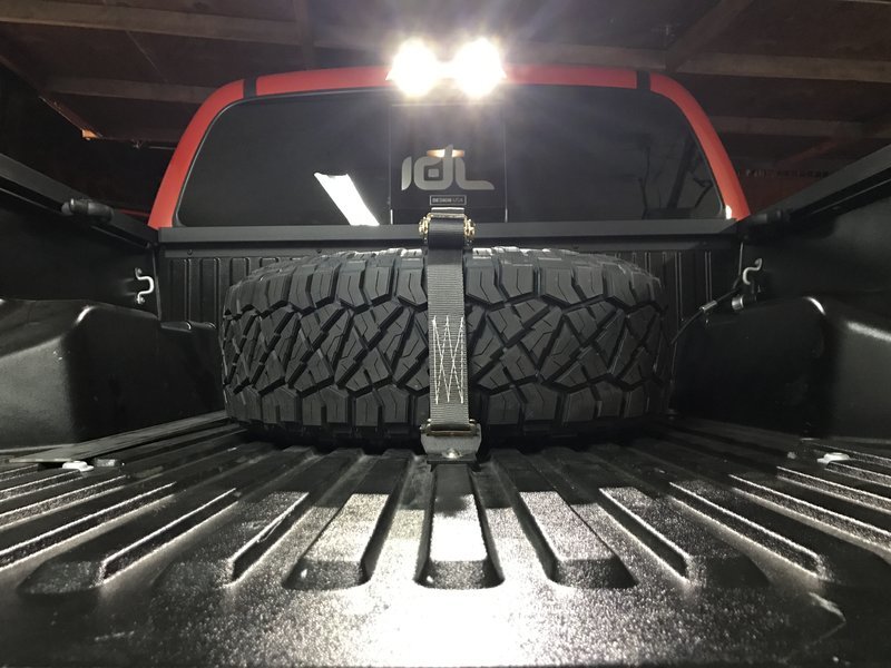

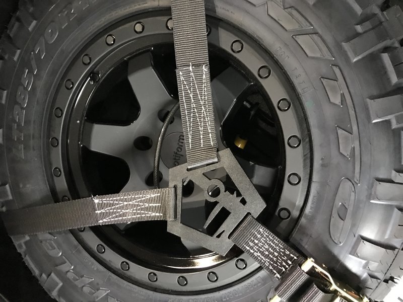

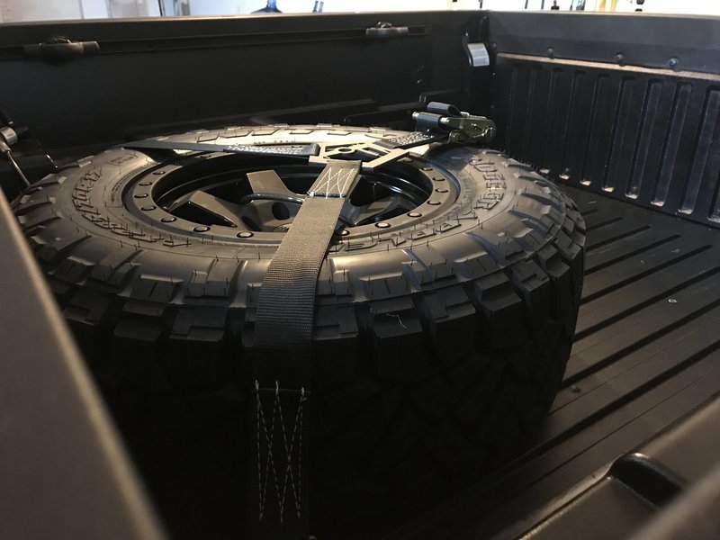

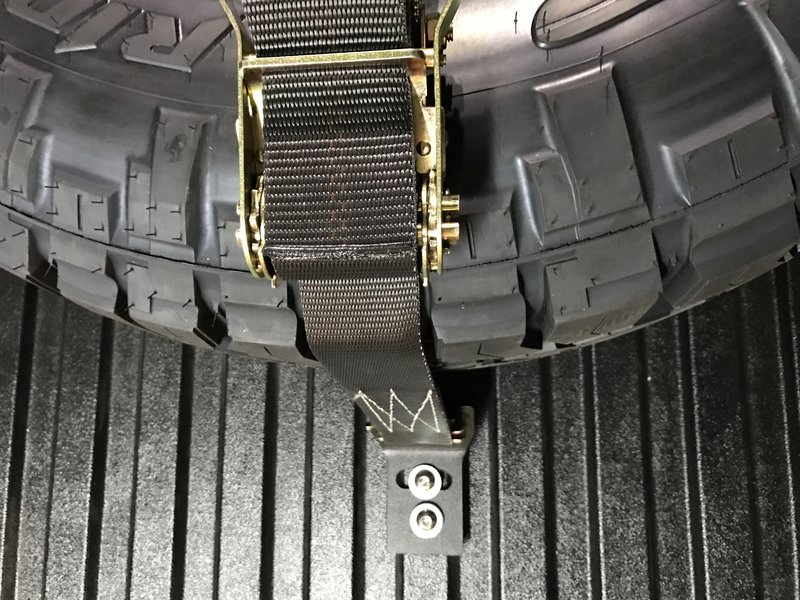

    So I used the two existing holes on the very inside of the bed. All you need is a T55 socket to loosen. You will need to bore/drill out two of the matching mounts provided in order to insert the OEM bed bolts. I used a 1/2 inch drill bit to open it up. After thats all done, I threw 2 fat washers to raise up the mounts so it levels with the higher parts of the bed, easy peezy. Now for the 3rd strap. I did drill two holes an inch or two away from the tire and I used the provided bolts and placed washers on both ends. Enough washers come with the kit, but you need to purchase two 9/16 nuts at your local hardware store. Before you drill through the bed, measure! Look underneath the bed to see whats in the way and stuff you want to avoid. I was about 1/8-1/4 off from where I wanted, but I made it work. It's much easier to do this without your OEM spare in the way. Luckily for me, I sold mine last week, so it was already out. Normally you would use the brackets it comes with, but the construction under the bed does not allow you without doing some major cutting, but it might affect it structurally. After all the mounts are placed, just strap up, ratchet the tire tight and you're good to go. If you look hard enough, I did add a bike chain just incase someone wants to pull a quick one. I may get something thicker soon, but for now this will do.
    Enjoy my friends.

    Digging up an old thread here...how flat does the mount in the center of your bed lay? Curious how usable the bed is if I take the tire out to carry something?
  5. Feb 17, 2018 at 7:53 PM
    Phaze2Yogi
    Phaze2Yogi [OP] Well-Known Member
    Feb 27, 2017
    #211784
    223
    Daniel
    Los Angeles, CA
    Inferno 2017 Tacoma TRD Off-Road
    its still useable, but the tabs will stick up as they're angled upwards.
