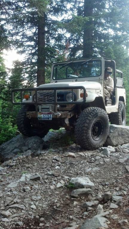

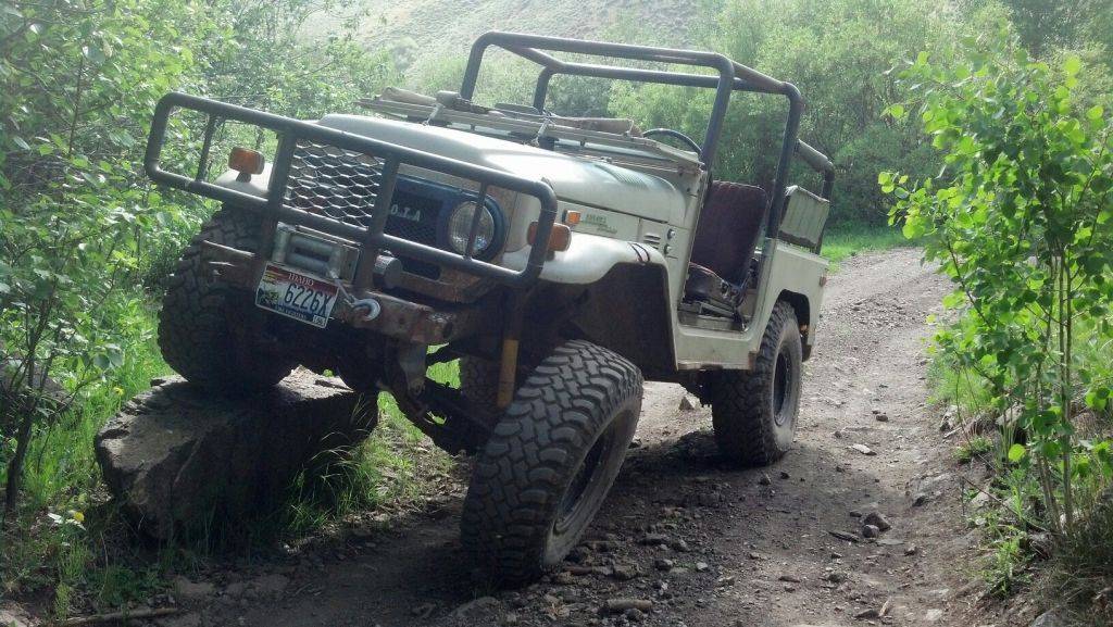

    Looks like a fun rock garden and good thing you don't have to fiddle with the wiring on the Taco too much.

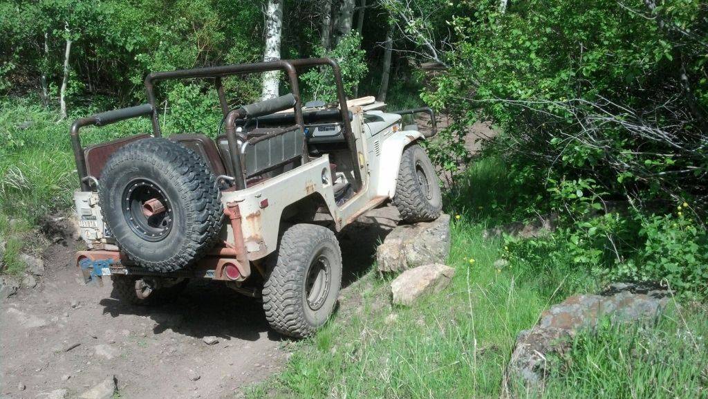

    Pretty good little rock pile for sure, and just a few miles from my old house I have since moved but have some new spots that I will get some pics posted up soon. I hate wiring it just isn't my thing the tail lights were new but being sealed units I could not check the actual bulbs they tested good when we started trying to track the problem down I believe because the blinker was completing the circuit (it was stuck on but not blinking). Anyways I still have to work out the 4wd ecu on the Taco and install the ADD switch but have been holding off since I hate wiring and the set up I have now is working.
    A few pics of the lights all worked out from last month.

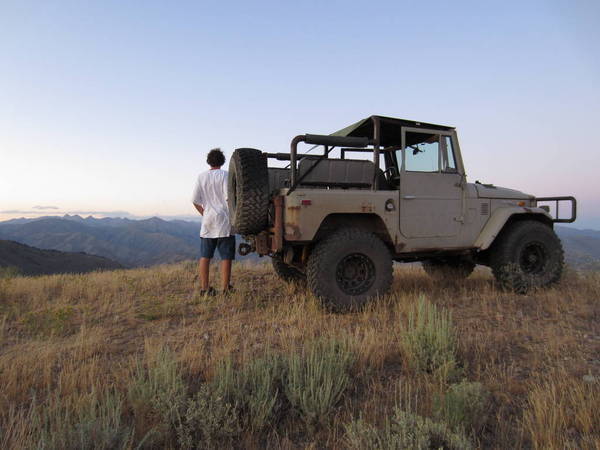

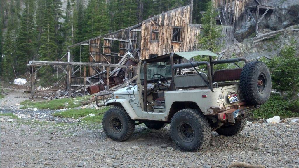

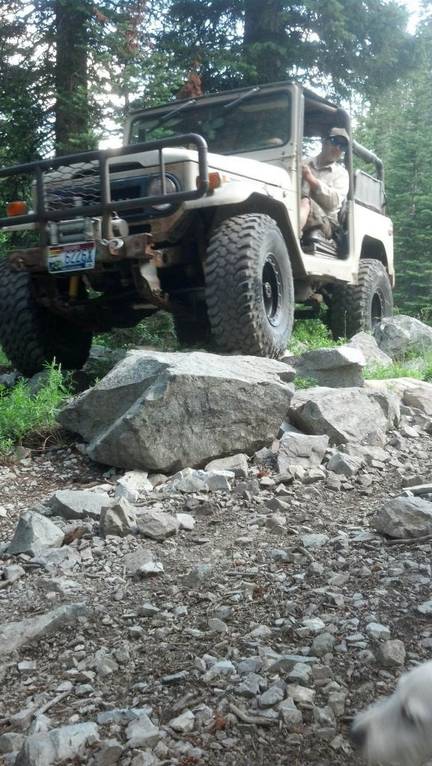

    :DSome pics from this summer that I found on another camera.:D

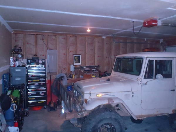

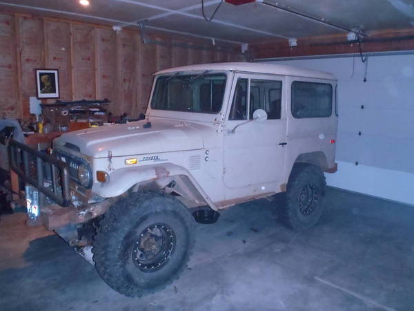

    Put the hard top back on and cleaned the garage

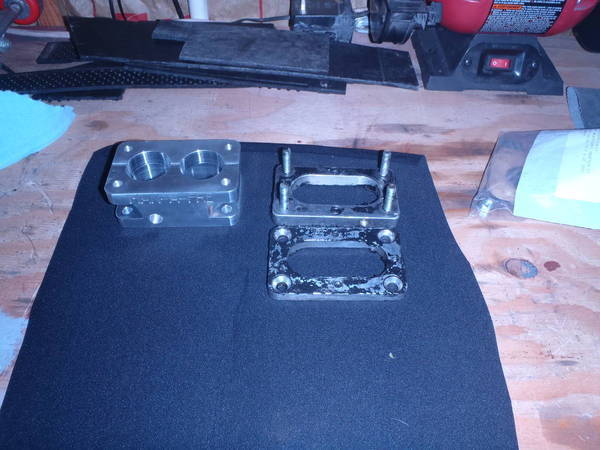

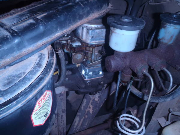

    So I have had a intake leak on the cruiser, I've tried several things to take care of it and finally think the issue has been solved. Its the old 2 piece stack style adaptor for the Weber carb so I picked up a Manafre one piece adaptor.
    Old adaptor
    On the bench side by side

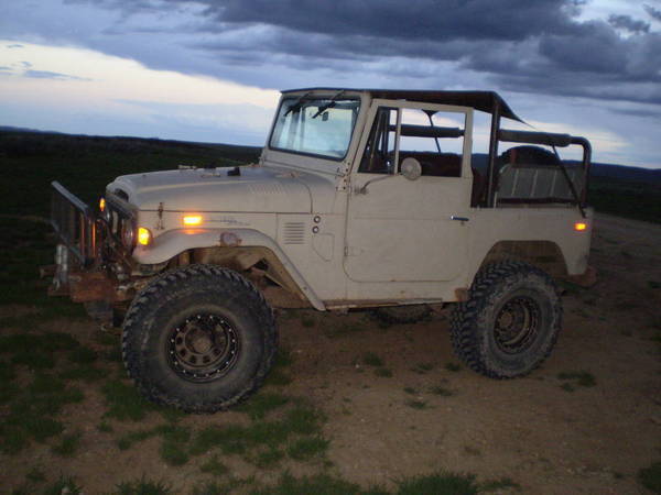

    Did a little work on the FJ today replaced the master cylinder with one from a buddies 74' that he upgraded to 4 wheel discs and pulled the roof summer must be here.
    Went out and played around a little this afternoon it was fun to wheel the old pig ran like a top and finally has some stopping power again with the new MC.

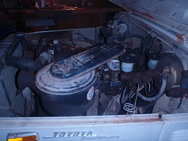

    So was looking around under the hood this evening, in 2012 I replaced the radiator and installed all new hoses. Turns out that 2 years later the hoses are all shot and cracking not losing coolant but I'm going to replace all the hoses again..... I purchased the kit from CCOT and am debating on what to purchase next.
    Last set of hoses
    http://coolfj40.stores.yahoo.net/radiatorhoses.html
    Interesting reading
    http://coolfj40.stores.yahoo.net/hosetest1.html
    Maybe I'll try these next or just order a set from Napa
    http://www.cruisercorps.com/engine/cooling/radiator-hoses.html#%21___SID=U&limit=all

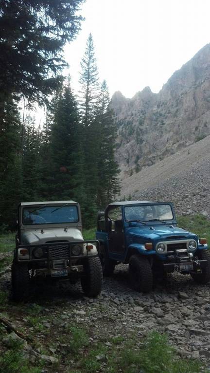

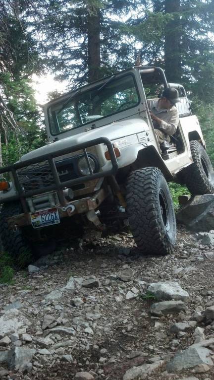

    Finally took the Cruiser out for a little more than a spin, we went to Boulder City for the first time this year. A tired iron run of sorts invited some other jeeps, IH scouts but only myself and my buddy ended up going super fun trip hopefully have some video later as well as a few more pics.
