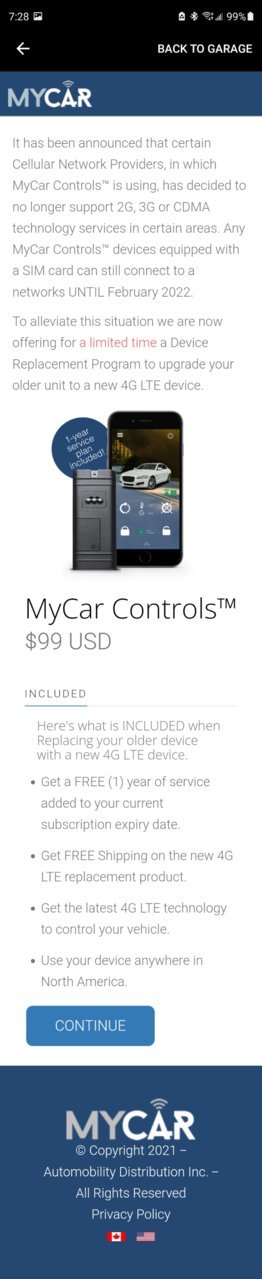

    @N2DesignsInc I just got this notification on my phone this morning. I'm not sure which module I have but I was definitely one of your first buyers when you started selling this. I bought the H key remote start with the smart module. Any idea if I'll need to upgrade?
