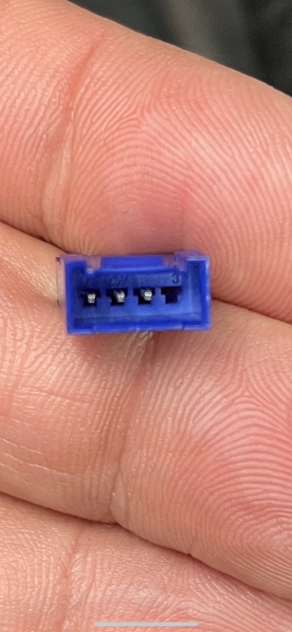

    Is this normal or did I break it.
    Installed it easily enough and both fob and phone app started the truck. I accidentally yanked out the blue smart module connector and after failing to sync it again I noticed a missing pin. Are there supposed to be 4? 4540739E-E19E-4BFE-BD77-842F2E846B2E.jpg

  7. Nov 6, 2022 at 5:50 PM
    #2027
    Ferbag1972
    Ferbag1972 Well-Known Member
    Jul 14, 2019
    #299223
    176
    Ontario Canada
    2019 White Tacoma TRD PRO
    Call Justin. He will sort you out

    Update: Called Justin last night as suggested, and he was VERY helpful. After about 3 minutes diagnosing he determined that I must have rushed through the programming step (which is probable knowing me...). He walked me through the reset and reprogram and now she's working like a charm. Top-notch service!
    Just in the nick of time too, temps dropped 20 degrees since yesterday. Winter is coming...

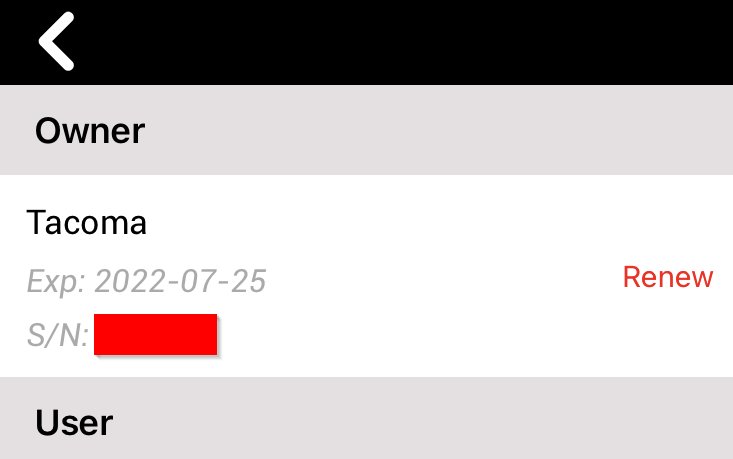

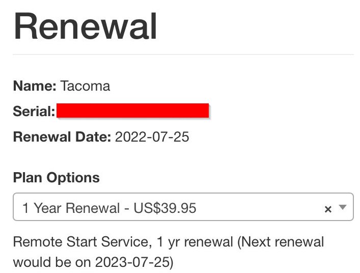

    Question related to the cell module/service.
    I looked at it today, and if I renewed it today, it would be back-dated as renewal 4 months. 1 year would only get me through to July '23, instead of 12 months from today (Nov '23). 3 year does the same thing out to July 2025.
    This screenshot is taken on 2022-11-21 (PS, props to the company for using the ISO date format! I am almost positive that's not N2 though)

    No. Installed in Feb 2020 (or there abouts). It ran through the trial year, I didn't renew. Renewed when I needed to get into the truck without the key fob (long story), so I renewed in July 2021 (I'm assuming 25th of July, given the dates shown), so it expired July 25 2022 (this year).
    If I wanted to renew now, it is backdating that service those months.
    I haven't inquired anywhere else, was just curious if others here knew what the deal was.
    EDIT: To be clear, this is NOT N2. The cell service is a third party company, N2 just interacts with it.

    Weird. I just tried my CL6 app to renew early and it wasn't "backdating" me. Still have one more year left...I would logout of the app and in.

    Nope, and when I open it in the app I get a pop up warning that service is expired.
    I'ma send them an email. It's a luxury thing right now, I signed in just to check what the cost was (couldn't remember), and found this.

    Response from the tech support below. Sounds like just an app shenanigans that's not quite up to snuff, but if you pay on X date, you get X + a year, not back dated.
    Hi Rob,
    The date on the app will reflect the renewal purchase, once the transaction is done. If there is an error, please let us know and we will submit a ticket to correct it.
    Thanks
