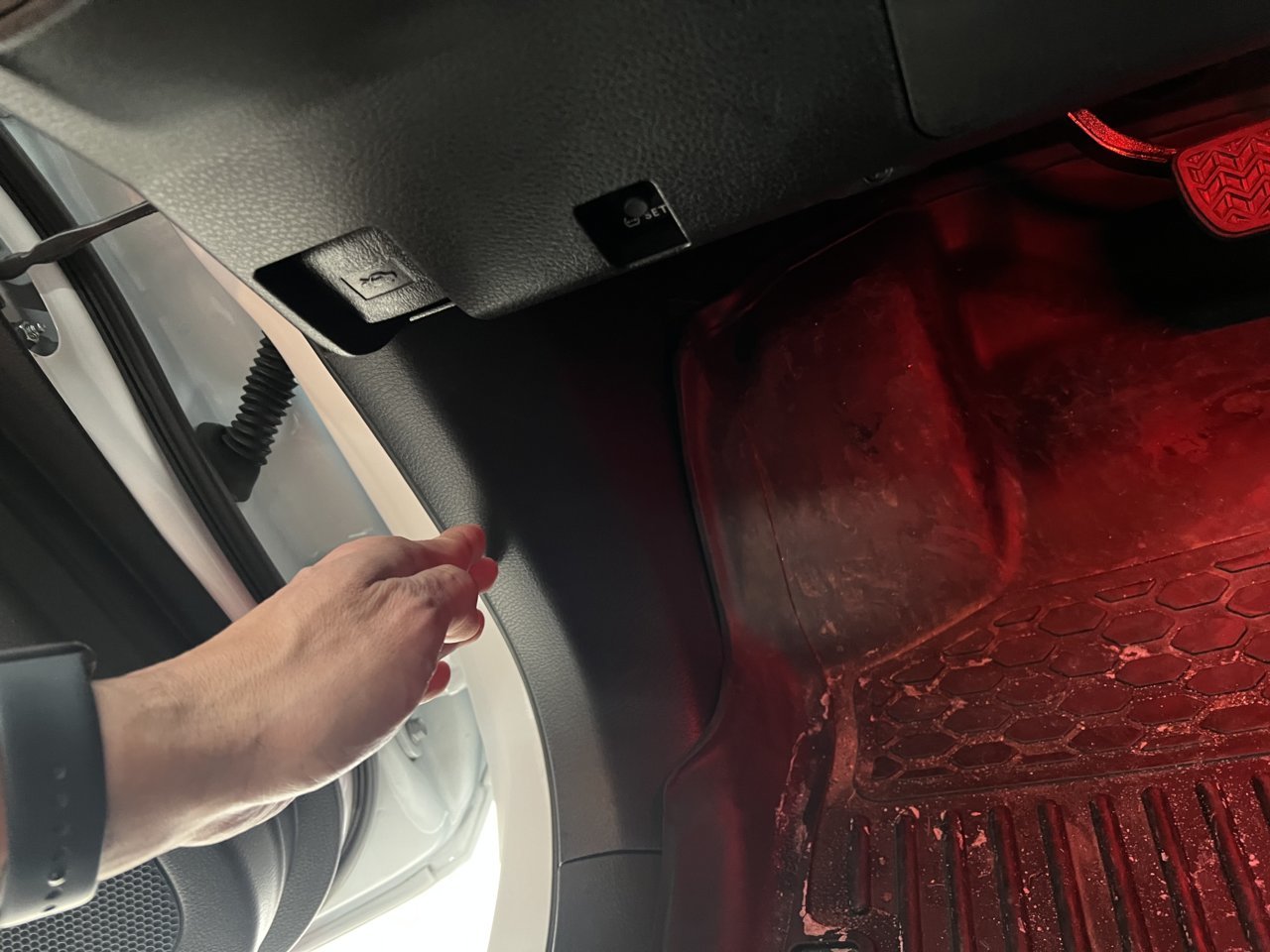

    Looking for some help, definitely love my N2 but depending on where it is parked sometimes it doesn’t get signal, anyone have pics on places they have put the antenna/module that gets reliable reception? Post numbers in this thread would be awesome too!

    I have mine (velcroed with some wire harness) right behind here. I could be wrong but the signal is depending on your cell service. I think it’s using 4G LTE. Do you have any other aftermarket electronic gadgets near it? Not sure if the module can be reset…hope you get a better signal. I love mine. Let us know.

    That is where mine is as well - except back towards the firewall, I like the idea of bringing it forward and I’ll give it a shot today!
