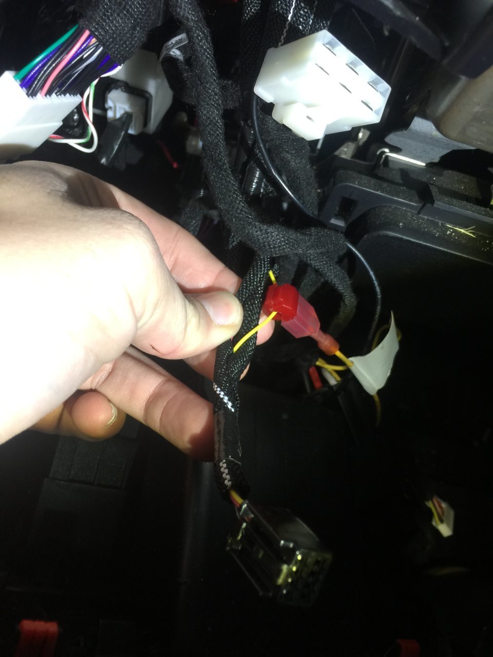

    To piggyback off of the clutch wire question, does the insulation need scraped before applying the clamp or does the clamp cut into it? I didn’t take any of the insulation off of the yellow wire, simply pushed the clamp down until it clicked. Could that explain why I’m not getting it to work 100% of the time?

    It should bite right through the yellow wire and make the connection. Make sure you get a good bite. I used pliers to crimp it down. You shouldn’t have to strip anything

    Hmm... good question. I didn't strip off any of the insulation. On a previous car, I installed a piggyback tune module that required a wire tap. I didn't have to strip off the insulation. But that's the only other experience I have with wire tapping. I could see how if the wire doesn't penetrate the insulation to touch copper, it wouldn't work. In fact, that may very well be the issue in my installation.

    Could be. Open up the little red connector bit and try it again. Make sure you’ve got the yellow wire lined up perfectly center to where the red connector bites. Then crimp it down with pliers to make sure it’s in there good and tight

    I'm wondering also if I inadvertently pulled any of those wires out of the connector, because it was a really tight fit to get that red connector through that wire bundle to isolate just the yellow wire.

    That could be. I moved down the wires a bit (down the black casing, away from the switch), peeled back the black casing and tapped there

    I think if I'm able to start the truck with clutch start cancel, then that's safe to assume it's functioning as it should, and it's simply an issue of insufficient wire tapping.

    Strip off (not cut) so can see it gets good connection
