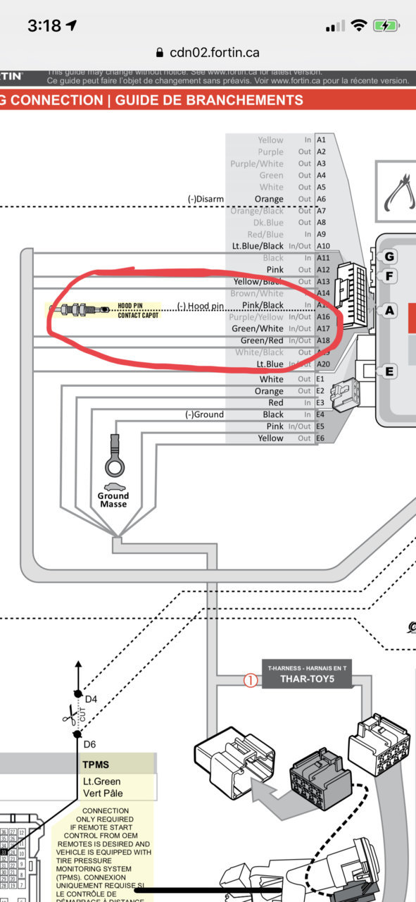

    Here is how you do it
    doublethebass[QUOTED] likes this.
  9. Dec 19, 2018 at 1:21 PM
    #729
    doublethebass
    doublethebass aspiring well-known member
    Jan 1, 2017
    #206252
    3,453
    Antoin
    Minneapolis MN
    ’17 6MT Pro
    Here you go @jayrobot
    https://youtu.be/V_SNCAMhezs
  10. Dec 19, 2018 at 1:21 PM
    #730
    doublethebass
    Jan 1, 2017
    #206252
    3,453
    Antoin
    Minneapolis MN
    ’17 6MT Pro
    Yep, gotta get that pin
