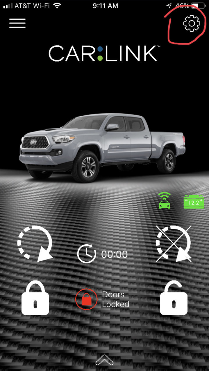

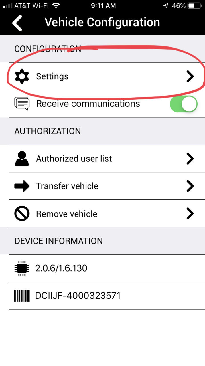

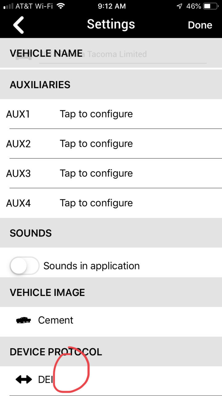

    If your protocol isn’t fortin, change it now and you’re done for now. This looks like a bug that the manufacturer is aware of and addressing with another OTA update soon. The work around it is to change the current Fortin protocol to ADS and then when the unit is done booting up, to change it back to fortin. No need to send any commands in between all this. Leaving it on ADS will work fine for the time being until the update is pushed to you and I announce it, but the door lock status and engine timer will not be passed through. Successful commands will go from blue to green when pressed. The way to do this is:
    Press the “gear” icon at the top right to enter settings.
    Press on “settings”
    Scroll down to protocol and then press and hold the space just after the last letter of the protocol that’s currently in there, if it’s fortin, then press and hold just behind the “n” for 5 seconds or more. A pop up will display warning you that you’re about to change the protocol, agree/confirm and change it.
