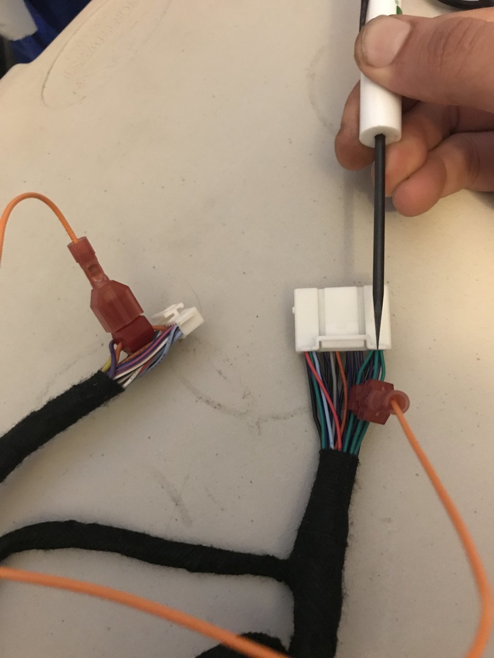

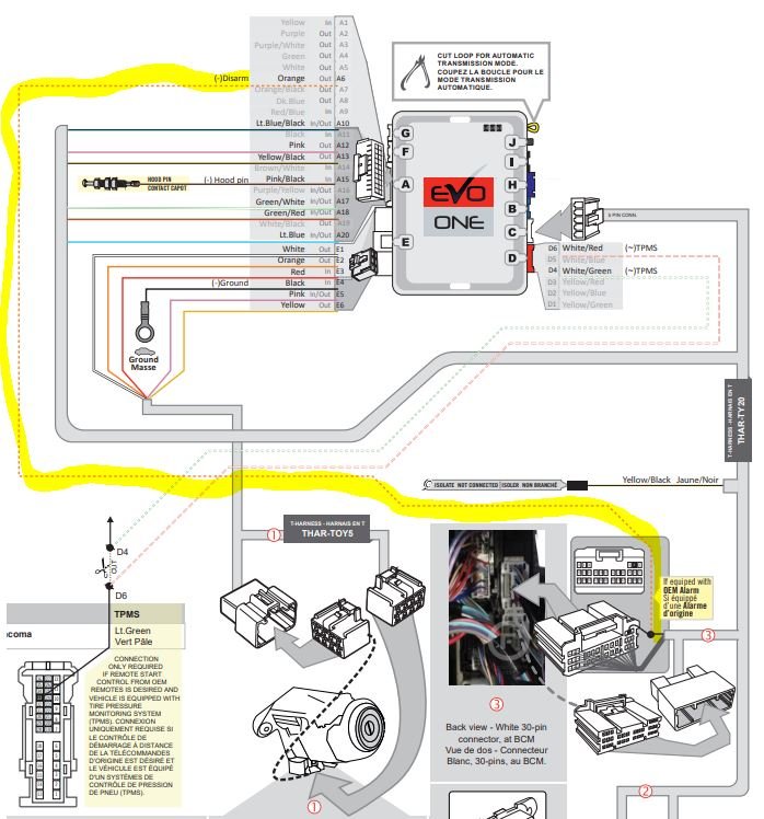

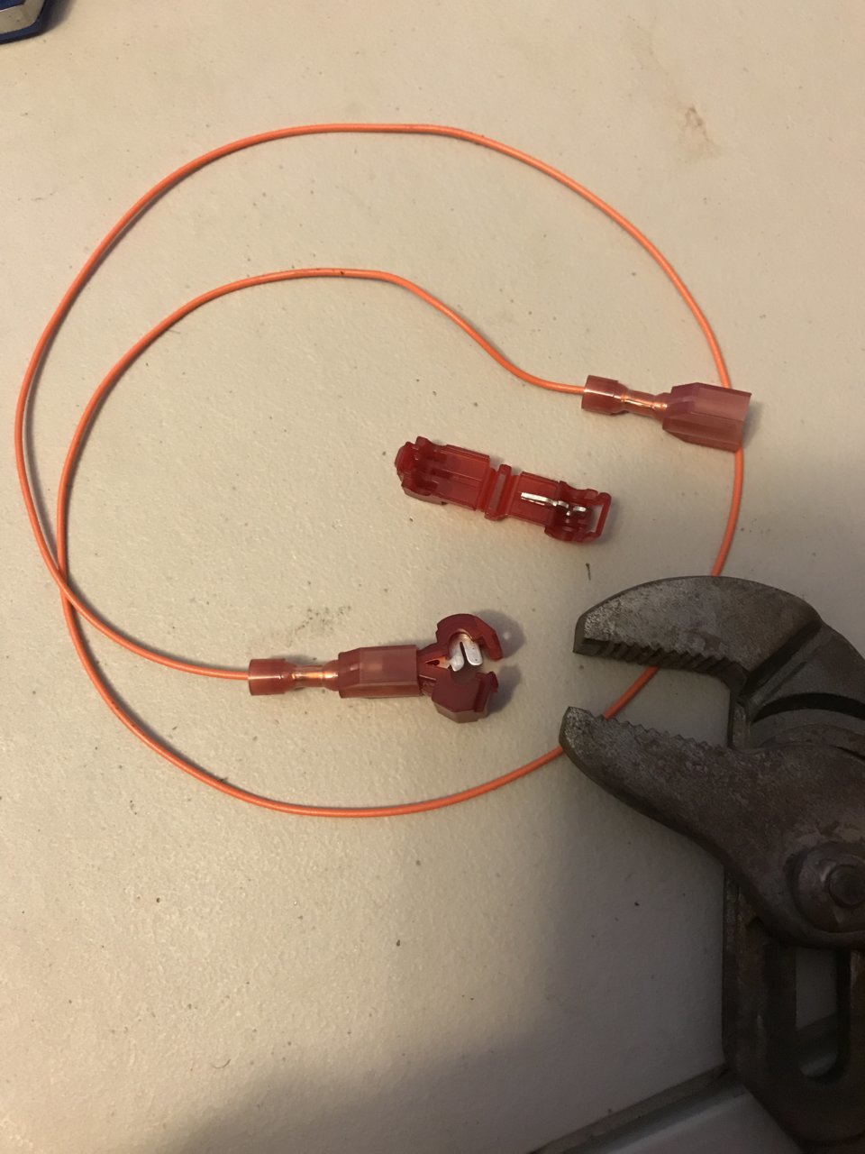

    For HKEY folks who have a horn honking before the engine turns on remote start instead of the subtle chirp, this is the fix for you:
    If you have an OEM alarm, (you’ll know if your horn honks before cranking the engine), then you’ll also need to do this:
    You need to tap/jumper the orange wire from the connector seen in the photo to the green wire IN THE MIDDLE of the other two green wires on the connector in the photo as well. This will disarm the horn. Not all vehicle require this from the dozens sold already. I Suggest RED Positaps or RED 3M T TAPS, you' need two pairs and a wire. Don't undo the harness fabric tape, there isn't enough wire in there to reach.
    Keep in mind that you must let the vehicle run its course when it’s powered down. And before you DO anything, check to see that once you’ve exited the vehicle - to hit lock once AFTER the car stops running and does it’s own locking, THEN you can press lock, AND THEN you MUST wait for the ALARM light in your vehicle to become armed, ONLY THEN you can remote start it. If you try before the vehicle arms it’s self, then it WILL sound off. So essentially don’t rush it. So after the car does it’s own locking, you will lock it also. Normally you’ll walk away so this wouldn’t be an issue or something you’ll notice, but once you lock it your alarm light will go solid, then it will start blinking. Once it starts blinking, it’s set and then you can remote start it. Don’t forget this!
    If you aren’t in a rush I can have this tap kit sent out to you in the mail, and you’ll get it in a few days, or else you can solve this immediately without waiting if you’re comfortable. All I’m doing here is supplying you with the wire and the taps already crimped:
    Let me know by contacting me with your full name and shipping address.
    Thanks!
    Jimmy
