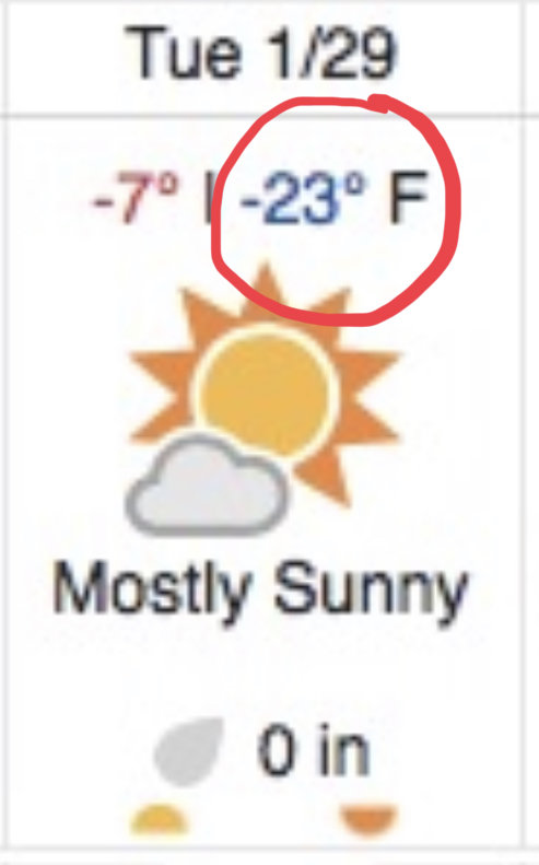

    This was sent to me from a customer here @doublethebass ...and no, he doesn’t live at the North Pole. Thankful for the N2 kit installed just in time...the “F” no longer stands for “Fahrenheit”. Where the heck do some of you folks live...this is a sample of what hell is like. Because it has frozen over. Over you AND your damn Tacoma! :eek:
    But question, what warms up the N2 unit before it warms up your truck hahaha...that’s cold dude!

    haha yeah man these better not have a low-temperature threshold.....I guess I'll find out next week and report back

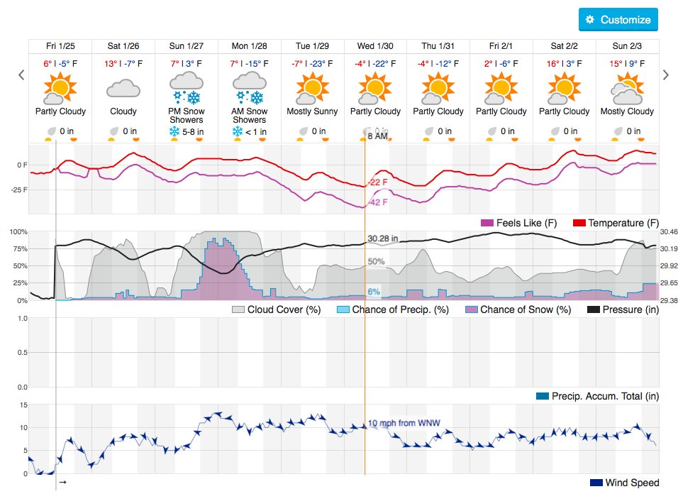

    here's the full forecast for those of you that are thinking about ice fishing...upload_2019-1-26_8-11-44.jpg

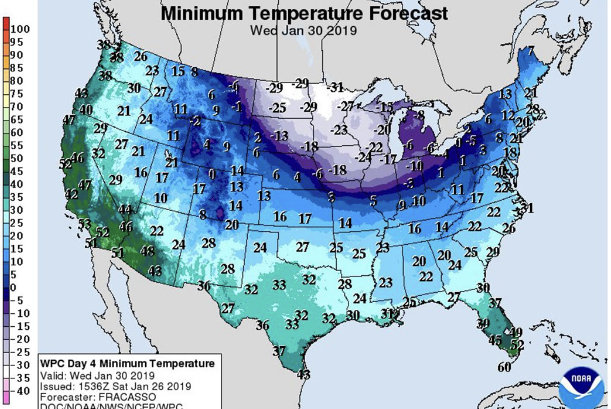

    I’d say take a moment and say a prayer for the folks about to be hit with the cold arctic vortex, but that’s pretty much all of you, so I’ll be prayin for you all...pretty much alone unless some Miami residents wanna join me...no seriously this will be bad. Wind chills in the Midwest and Great Lakes area of -45 to -60.

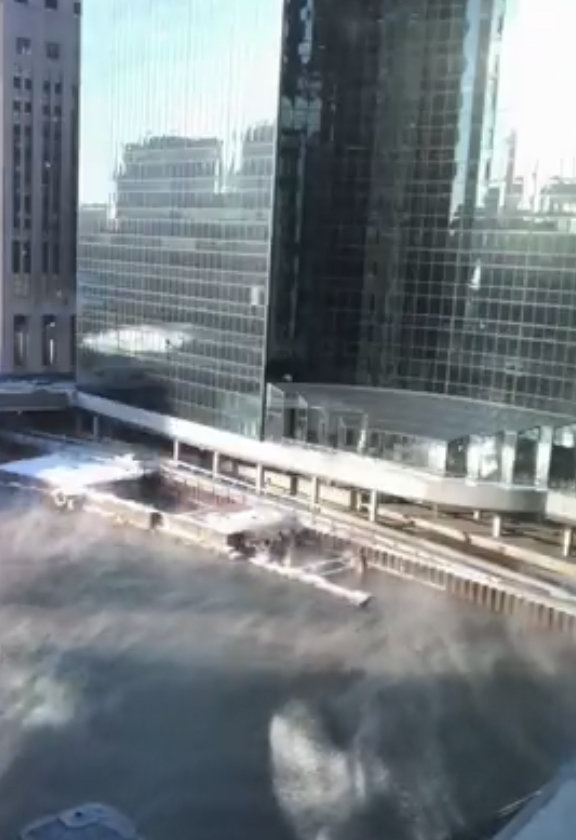

    It’s not cold until the river water is warmer than the air and starts steaming...
