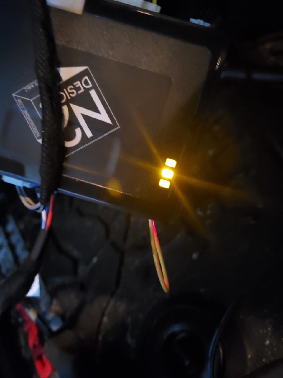

    Hey guys I have a problem with the kit.
    *little info, 2020 Manual Transmission, H-Key
    After following the instruction and programming exactly like how Jimmy did in the video is there another step I am suppose to do?
    I havent put things away, already re-installed 3 times. Same thing.
    press the lock button 3 times, head lights do come on and gauge cluster but thats it.
    Hope you guys can help me. Thanks

    Make sure your clutch cancel tap is in well and biting, and make sure the green fuse that plugs into the relay (small black cube attached to your harness hasn’t fallen out, if the blade fuse fell out, there is an extra one included in the red baggy. If you’ve checked all those and still does not work, we may need to reset the module and reprogram. I’ve PMed you my cell, feel free to text me.
    Edit: your privacy settings don’t allow me to PM you so PM me instead and I’ll reply.

    Is this the correct light I am supposed to get after installation?
    And yes I doubled check the clutch cancel and green fuse. Everything is plugged and tapped in well
    *I also pm you. lmk if cant reply

    Responded. You can't move on to cell portion until fob portion works. The yellow light is normal when ignition is ON. Are you putting the vehicle in ready mode properly and TPMS snipped and interfaced to our connectors?

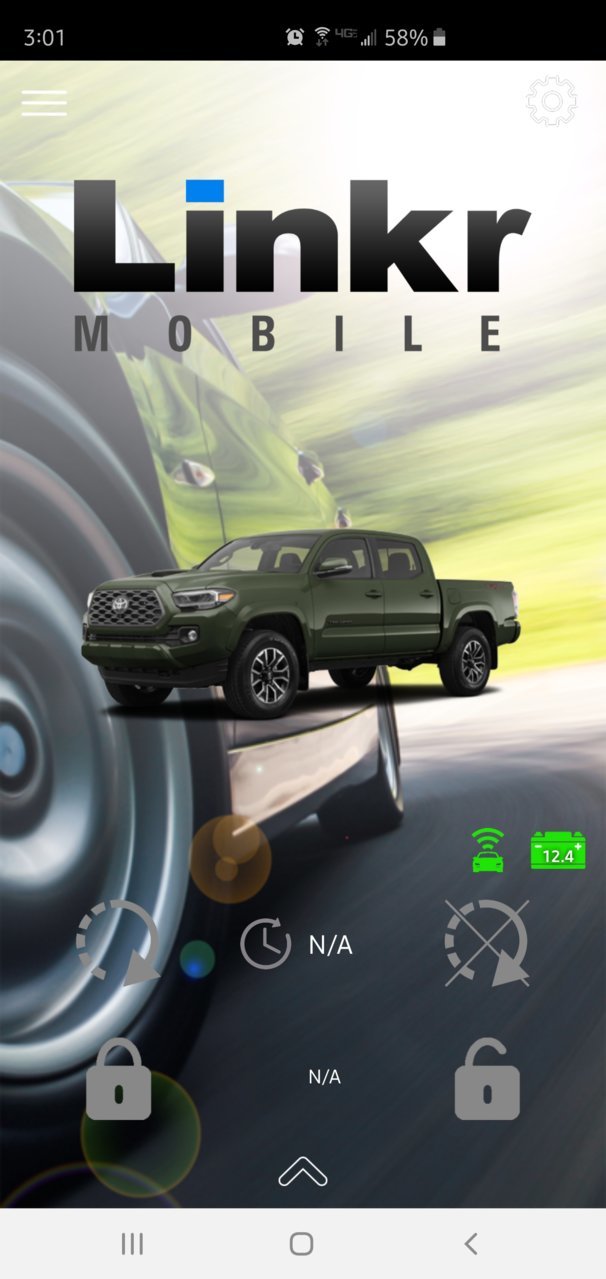

    @n2designsinc Hey there! So I installed the remote start and it was super easy! Totally recommend!
    however I did add the smartphone module and am needing some support. I’ve restarted the device with no luck.
    I see my truck on the app, however it does not send commands to the truck. It does however read if I lock and unlock my doors with my keyfob. And the remote start works with keyfob. Just can’t from the app. Ideas?

    I'll be calling you shortly!

    I am having this exact same issue. What’s the deal? How do I fix this?

    We took care of Steve. It was just programming, which is likely your issue as well (something was overlooked). I've PM'd you my personal cell. Text me and I'll reach out over the weekend to assist in stepping you through it and get you going.
