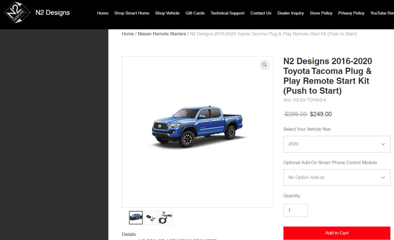

    Is the kit for the 2020 available yet?
  18. Feb 17, 2020 at 5:01 PM
    #1718
    N2DesignsInc
    N2DesignsInc [OP] --------------------------- N2 Designs, Inc. Vendor
    Jan 26, 2018
    #242487
    2,358
    Los Angeles, CA
    2018 that identifies itself as a 2021
    Mods: Is this still a Tacoma?
    Sure has, two weeks now. We sold out last week, now have a limited inventory with more being made each day to keep up with demand.
    Available Here
