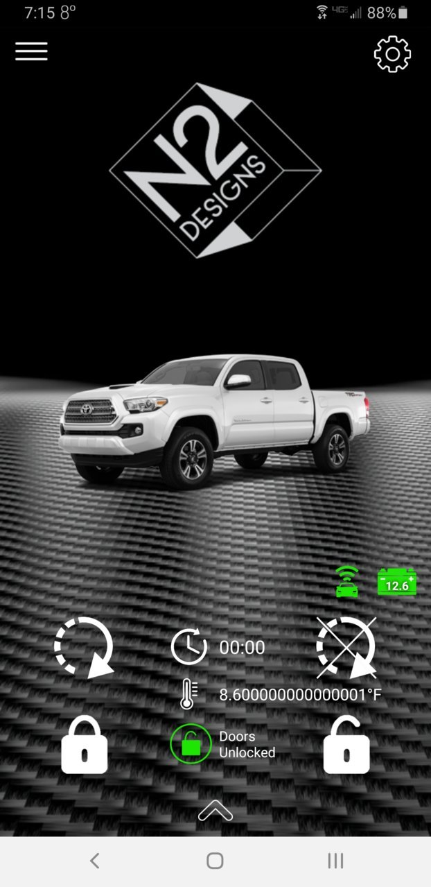

  17. Mar 8, 2021 at 10:55 AM
    #1937
    hoosier96
    hoosier96 Member
    Nov 19, 2019
    #311179
    22
    Hey Jimmy,
    My remote start is having some issues. On the app, it shows it is connected and is displaying the voltage and temperature. However, it's showing the doors are unlocked and won't start via the app. I installed a trailer brake controller yesterday so I am wondering if maybe it lost programming during the process or I knocked a wire loose...
  18. Mar 8, 2021 at 11:48 AM
    #1938
    N2DesignsInc
    N2DesignsInc [OP] --------------------------- N2 Designs, Inc. Vendor
    Jan 26, 2018
    #242487
    2,358
    Los Angeles, CA
    2018 that identifies itself as a 2021
    Mods: Is this still a Tacoma?
    Just cycle power to the module for a minute WITHOUT programming again if it was working. You may have received a firmware update...
  19. Mar 8, 2021 at 12:14 PM
    #1939
    hoosier96
    hoosier96 Member
    Nov 19, 2019
    #311179
    22
    Would disconnecting the battery accomplish that?
  20. Mar 8, 2021 at 12:58 PM
    #1940
    N2DesignsInc
    Jan 26, 2018
    #242487
    2,358
    Los Angeles, CA
    Why do that? Unplug the big black 8-pin, single row/flat connector going to the smart module device itself for a minute then plug back in...battery is overkill...
    hoosier96[QUOTED] likes this.
