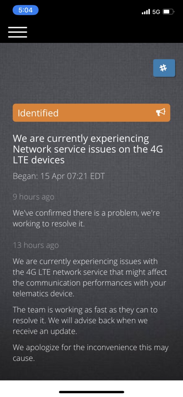

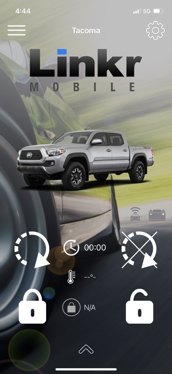

    is it just me, or has anyone else been having connection issues lately? This morning around 7am pacific and now around 4:45pm pacific. i'm just not seeing the remote start on my app. Been working pretty flawlessly for over a year now. I'm going to double check my position of the physical unit itself and see if something got moved recently.
    Done the usual things. force closed app. Log out back on, toggle Cellular, reboot iPhone etc.

    Mine seems to be down since midnight. Just checked it. My cell module is in the dash and I always get signal where I'm parked.

    you’re right. Mine shows under last known position yesterday 4/15/2021 around just before midnight. 23:32:26 PDT

    just saw this. Looks like there is something going on and they’re aware.

    It has now been resolved. You guys should log out, kill the app, and log back in. All is working now.
