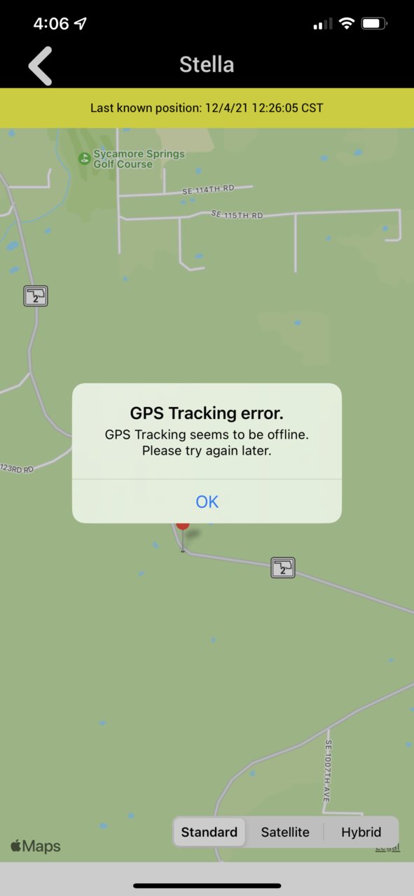

    The app is showing server maintenance was performed today, but after completion I can no longer connect to my truck. Anyone else having this problem? Has been flawless until today

    Oh no, I guess it’s just one of those mysterious stopped working for no reason situations, My key fob will still start the truck but the problem seems to be with the cell phone module and/or App which has always worked without any hiccups.

    Yep, did that. App simply won’t connect, I can’t see how much charge my vehicle has, can’t see its location or unlock the doors and crank the vehicle. It showed my last location right before 1 AM when the server maintenance began

    There was a server update that has been long resolved. Don't reprogram. If you're not back on line just cycle power to the smart module by unplugging the big 8-pin black connector that actually enters the device for 30 seconds. Logout of the app then log back in ONLY after the lights on the module are solid green and solid red.

    Thank you, back online. You guys have the best customer service, going to order another kit for the forerunner
