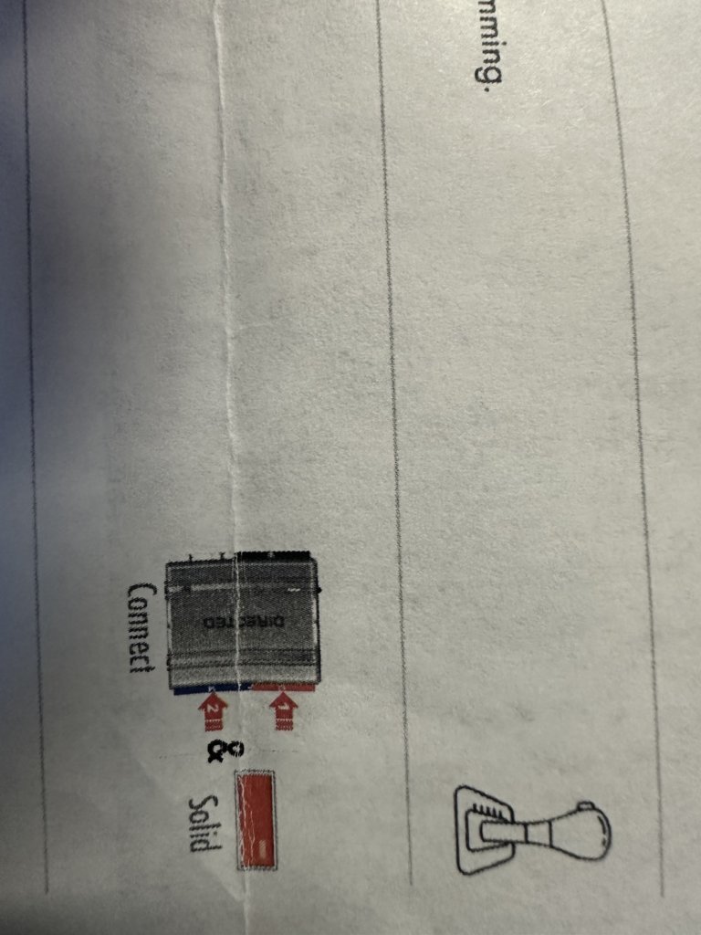

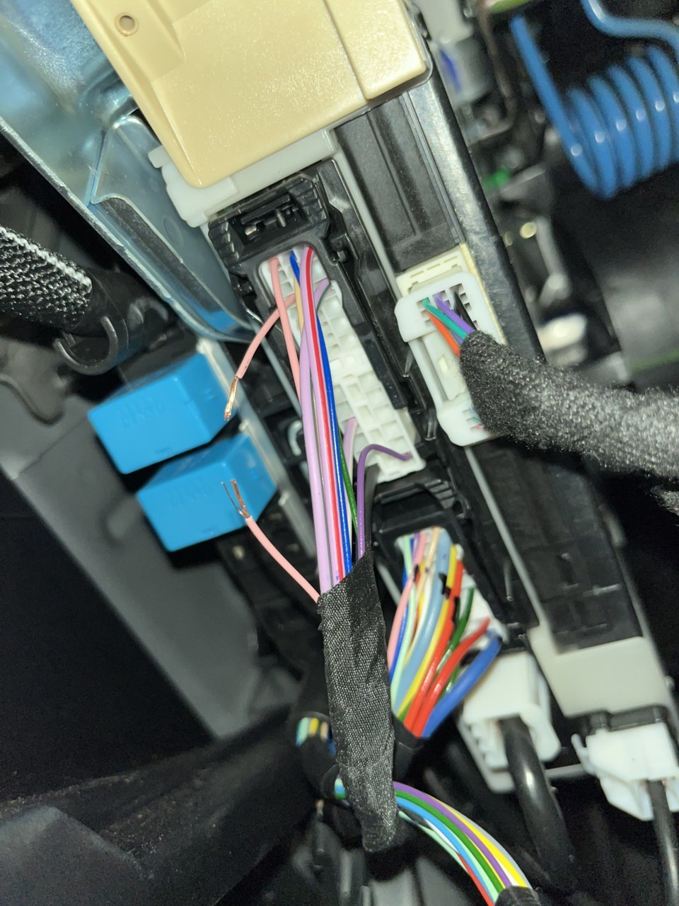

    Looking for some help.
    Installing Tacoma Push to Start (with key take over and no engine shut down)
    When it comes to the module programming, step 2 says to follow in exact order.
    1. Connect the 14pin
    2. Connect the 12pin
    the issue is the color reference saying to do red first and red is actually the 12 pin and blue is 14 pin.
    Steps appeared to be reversed, does this matter?
