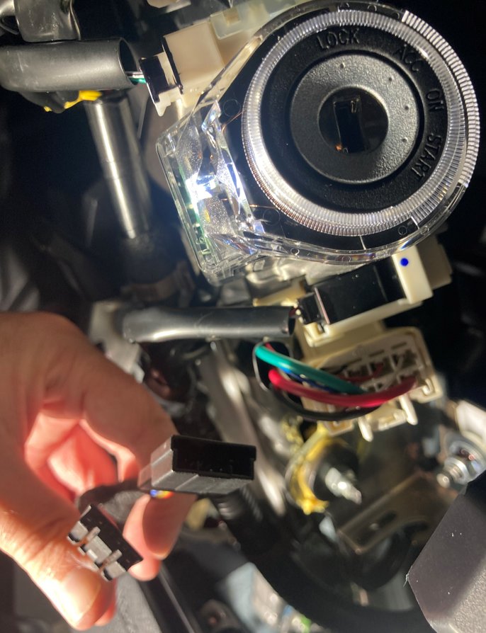

    I'm working through install and all the videos I find online show the black connector going to the ignition, except my ignition looks completely different and doesn't have the same connector. Anyone else run into this? Anyone able to help? I'm out in my garage at a loss at this point. The only black connector is a square black 2pin connector that you see directly below the ignition.

    You have a key ignition and looks like the N2 starter harness is for vehicles with push start. You might have the wrong N2 kit

    Yeah that’s what my N2 kit looked like and I have push-to-start.
    What model did you order? And what does your key look like?

    Yep, wrong kit ordered or sent.
    You received PTS, but need HKEY.
    Consider this time practice...

    Yup. I followed a link I had saved and it was to the Push to Start. Looks like I will need to exchange for the H-key version. Thanks everyone.
