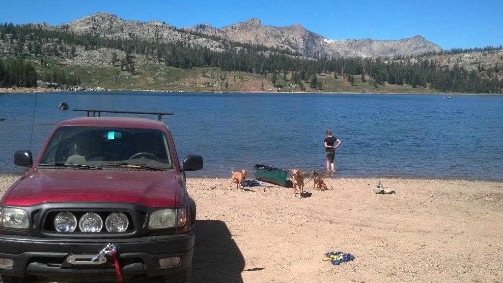

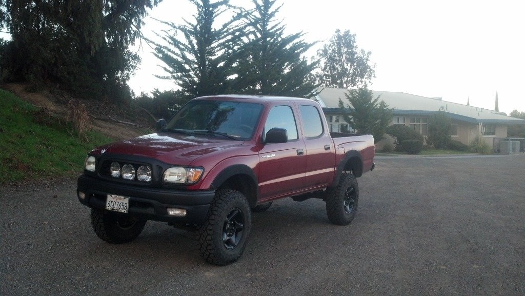

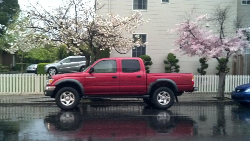

    Finally getting around to do this.
    Bought my truck in 2012
    2001 tacoma
    3.4 V6
    SR5
    Open front and rear
    Stock tires/suspension
    Day I got it
    First trip in the dirt

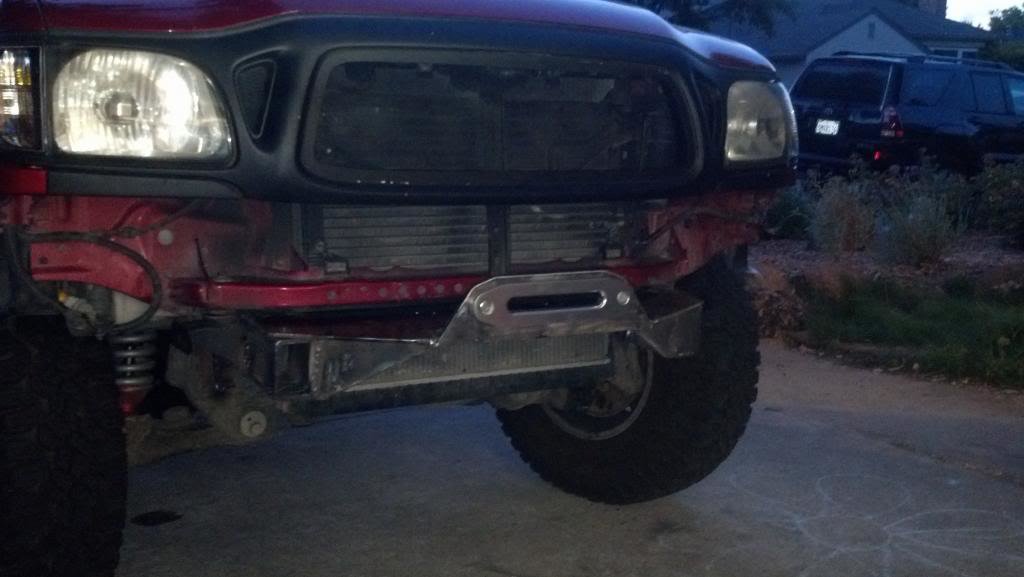

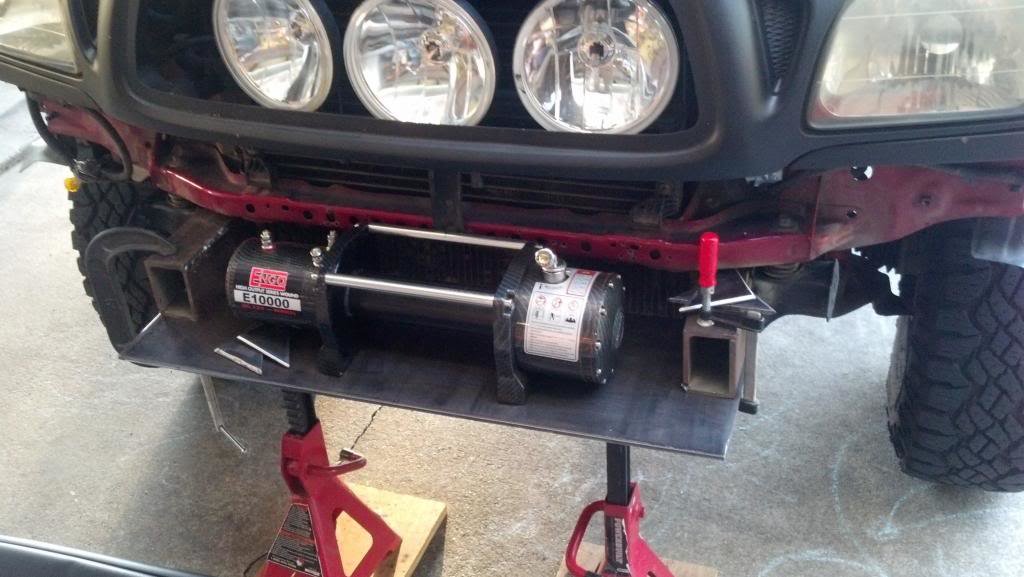

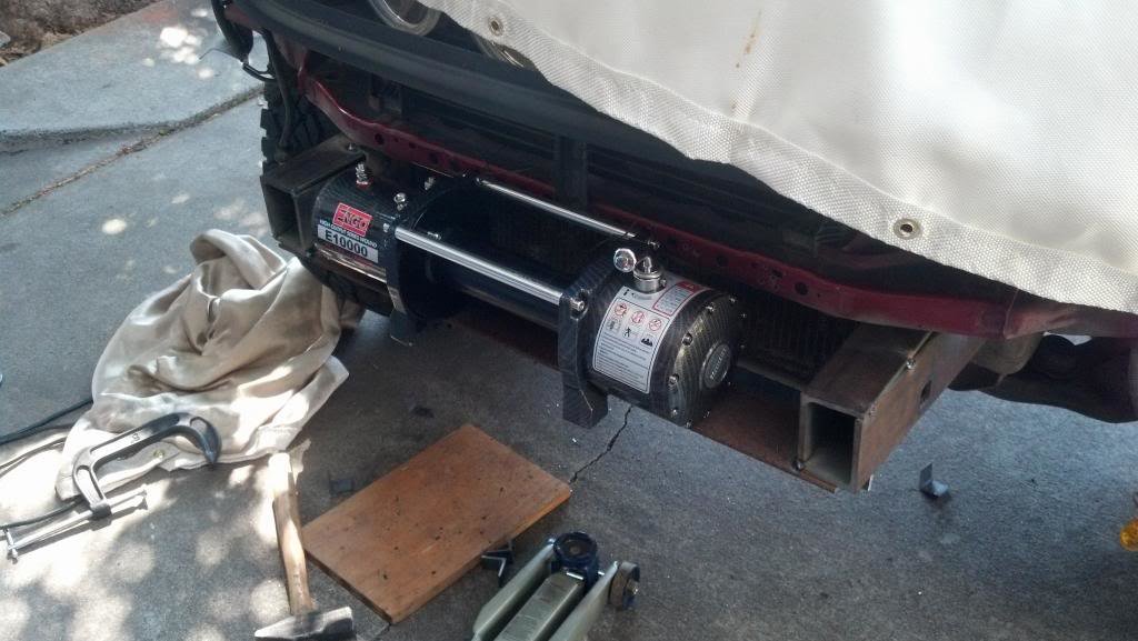

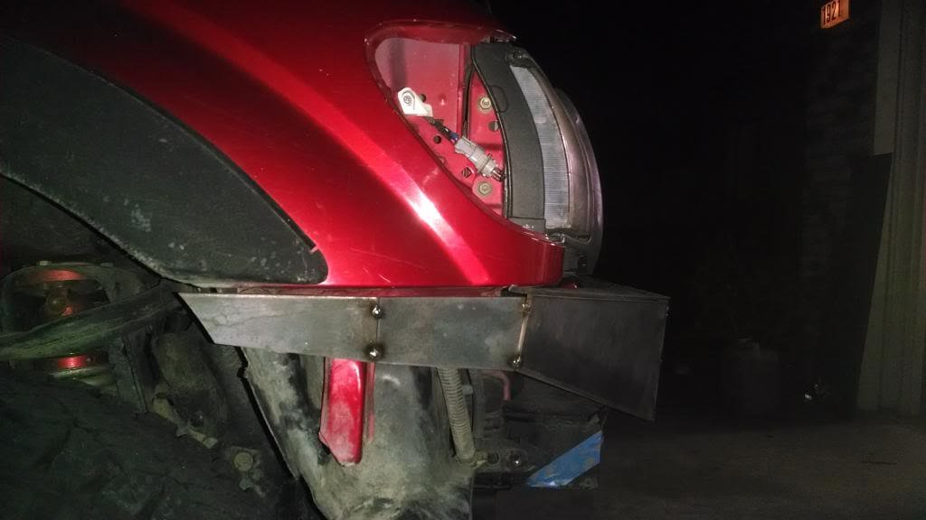

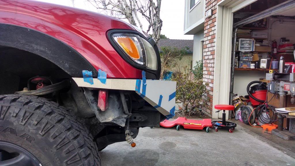

    Building winch mount
    Bumper build

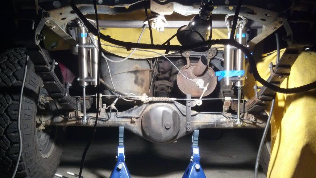

    Rear shocks
    Before my truck

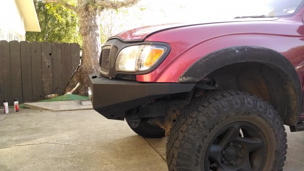

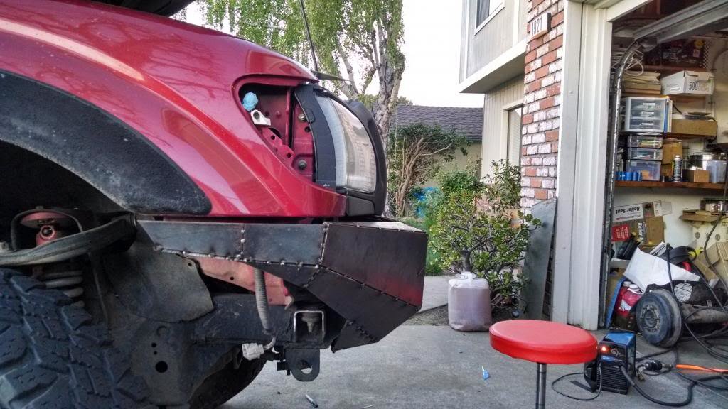

  8. Apr 13, 2014 at 11:59 PM
    nagorb
    nagorb [OP] Should be a dang perma mod
    Feb 28, 2011
    #52025
    9,352
    Alabama
    2001 dbl cab 4x4

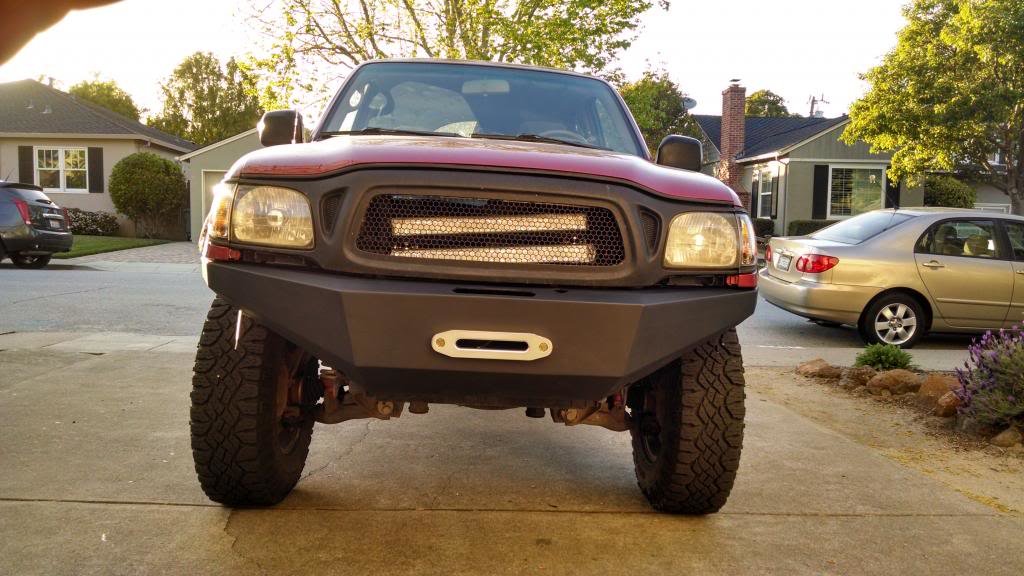

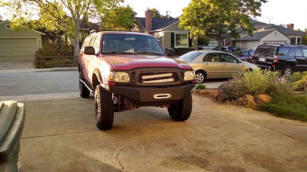

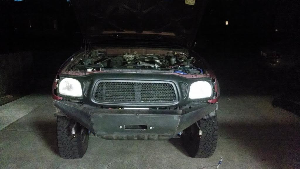

    Made some progress on the bumper, its not done yet but I painted it to fight off the all evil rust. Still need to tweak it after it warped a bit during welding, cut holes for lights, hilift, shackle mounts, and enlarge the access hole for the winch.

  9. Apr 14, 2014 at 12:00 AM
    nagorb
    Feb 28, 2011
    #52025
    9,352
    Alabama
    2001 dbl cab 4x4
    and yes I know the lights are crooked:D

    haha the bumper looks good tho man. Good fab skills. Is there a way to space out the side with the fender tho? That thing might hit when you're flexing on the trail
  13. Apr 14, 2014 at 9:37 AM
    nagorb
    Feb 28, 2011
    #52025
    9,352
    Alabama
    2001 dbl cab 4x4
    Yeah it already hits, got warped when I welded it. I had a nice even 1/4 all the way around now it nose dives and has about 3/8 gap in the front and almost none on the fender. I thought it was going to warp a lot more then it did, I can fix it though.

    255/85/16 BFG KM2's, 3" OME lift, Dakar's, Nitrochargers, Grey Wire Mod, ARB Bumper, ARB CKMA12 air compressor, WIts End Pacifier, Warn M8000, Uniden 520 XL CB, rear diff breather mod, full time power to aux 12V outlets, Rago Fab ditch brackets, Titan Rod Vault, Extreme LED's front and rear,
    having a winch inside the OEM bumper looks awesome. I need someone to weld me up something like that for my truck

    I had to hack the shit out of the bumper to get it to fit, doesn't look so bad in pics but in person it looked like shit. My end goal was a plate bumper so I wanted it as high as possible so I mounted it above the frame, if you were to mount it inside the frame you wouldn't have to hack it up so much and get it to look clean. If you want I can give you more detail on how to do it yourself.
