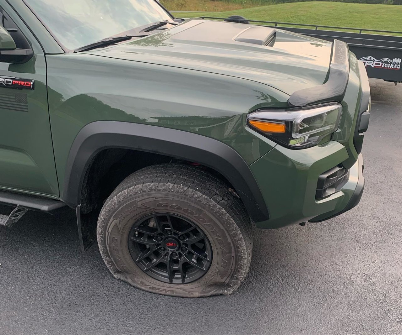

    Plugs will last longer than the tire. I once put six plugs in a cut and was able to drive 50 miles in Baja until I found a tire place had a shitty, bald tire that would fit.
    Buy a plug kit and an air pump and keep them together wherever you roam.

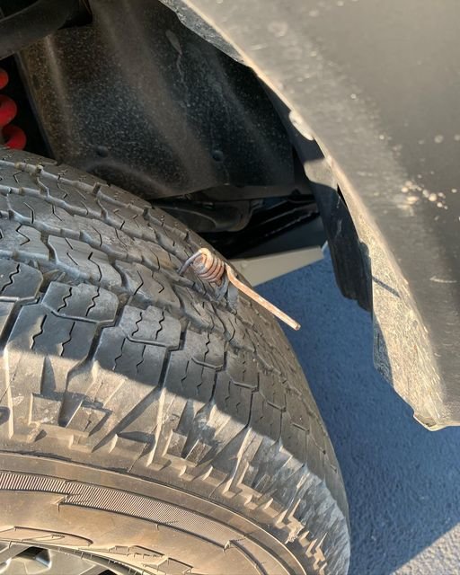

    I wouldn't think twice about plugging that. Get yourself a tire plug kit but spend the extra few bucks on one that has metal handles nut plastic ones. The last thing you need it the plastic handle cracking and the metal shaft going through your hand. I carry one and a small compressor any time I go on a road trip.

    Most shops only do Plug-on-Patch now.
    You aren’t going to spit a POP, the plug is literally attached to the patch inside the tire.
    Plus, they seal much better. And not just air. Water intrusion from a poor fitting plug can cause the belts to rust and break.
    Basically, it all comes down to liability.
    If that were MY tire, I’d shove a plug in it and call it good.

    Plug it. I worked at a service station for many years and the advertising for the plugs we used was usable tire with 300 plugs in it. They were all over from the tread down the sidewall. That location is very doable. I would not hesitate to plug it. I too carry plugs, reamer and installer and a small pump in all my cars.

    If it plugs, it chugs. Rode this one for over a year after having it plugged and patched before upgrading to new tires.

    I used those lawn mower tire sticky push plugs on the shoulders of 3 tires on one of my recent cars. Never leaked. Rode like that for 2 years. They just won't do it because it's a 'liability'. I would do it again. It's not going to blow out (i think). Worst case it'll go back to slow leaking, just have to keep an eye on it.

    Another +1 for Discount Tire plugged it for free in about 10 min.

    Discount is super anal about where the puncture is. They won't do it unless it's towards the center.
