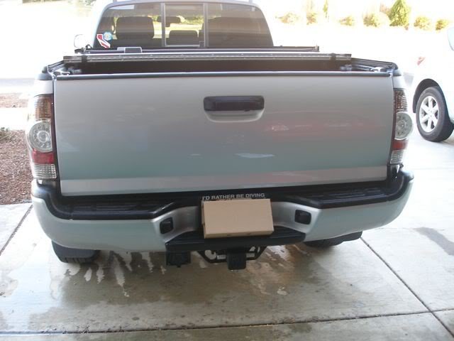

    Tail gate that is (made you look), I finally got around to taking the badges of the tail gate of the dive taco.
    1st thing I did was wash the tail gate, I was worried abut getting dirt caught between the emblem and the paint while cutting thru it with the fishing line.

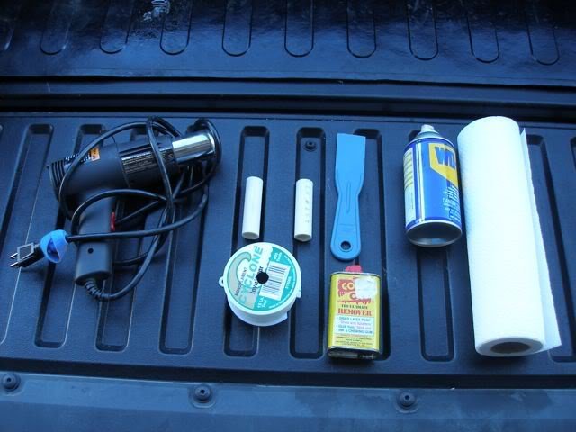

    Here are the materials I used.
    Heat gun, 15 lbs fishing line, 2 peices of 1/2" pvc pipe, new plastic putty knife, WD40, Goo Gone, I replaced the paper towels with a soft cotton wash cloth.

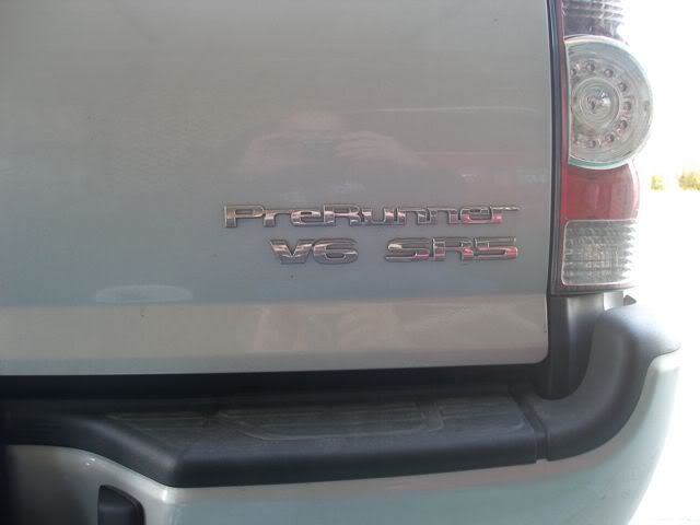

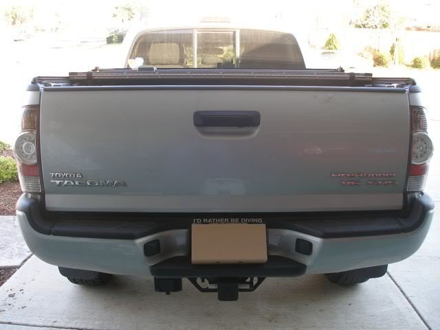

    Here is the before shot after washing.
    My first victim.

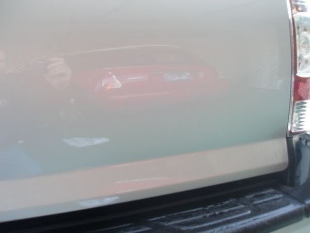

    Using the low setting on the heat gun I slowly heated the emblem until it was warm to the touch. Using the pvc pipe as handles with the fishing line I flossed behind the emblem with a sawing motion moving from right to left until the emblem popped off. Here you can still see some of the double sided tape.

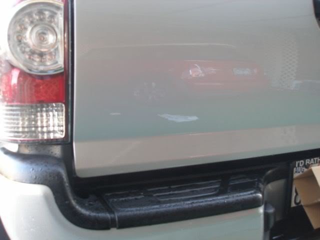

    Here is the same spot after a good wiping with WD40 and a final wipe with Goo Gone.

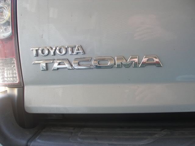

    Same process on the passenger side. The fishing line did break a couple of times but it worked well.
    Before
    After

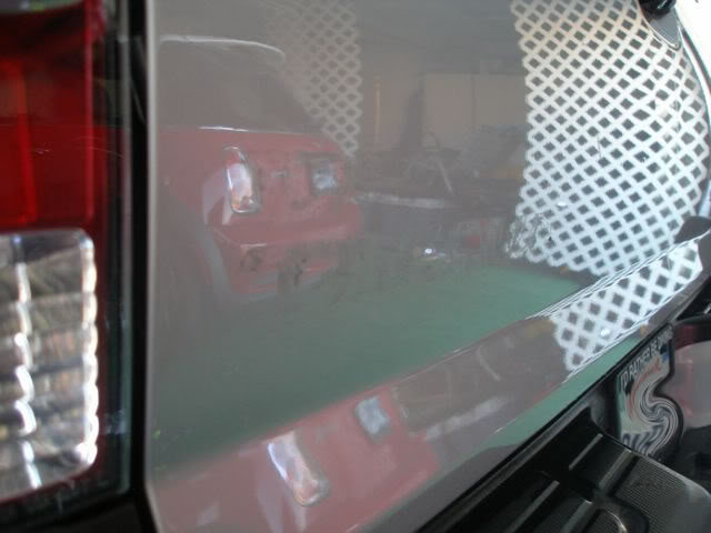

    Final wipe down and wash.
    I never did use the putty knife, I found the fishing line slid in right behind the emblem no problem. Also two fingers are a little raw from rolling the tape boogers off.
