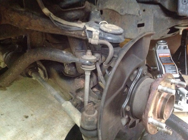

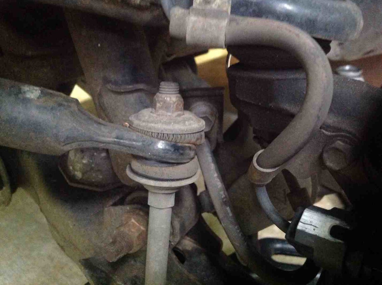

    I've spent the last half hour squinting to look at part diagrams on my phone.
    What's the name of this bushing that has started to crack?
    The matching one on the other side of the truck looks similar. Needs to be replaced right?
    2006 2wd 2.7l

    That looks like a stabilizer link bar.

    Thanks. I'll try googling that for a p/n

    RAYBESTOS Part # 5451939 for the win. You can go OEM, but it'll be more expensive and its just a rubber bushing.

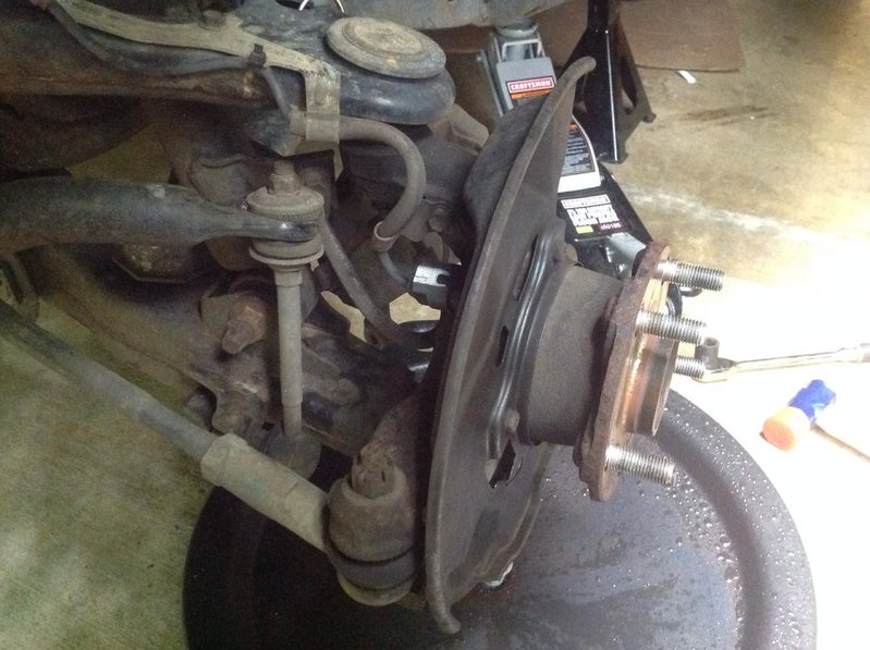

    Just thought I'd give some feedback on this thread I started.
    I ordered the Raybestos Part recommended by wcp0611. That was the part I needed unfortunately the bushings were too small for my truck.
    No worries anyhow because after further examination I noticed a tear in the End-link's lower joint boot. I decided to replaced the entire end link at this point.
    I ordered two new end-links. i chose Mevotechs from Auto Supply Warehouse. When I got them in the mail one the the boxed was damaged and the new end link inside had a cut in the rubber boot on the lower joint.
    I returned them both to ASW and ordered the Moog End Link kits from Amazon. They came a couple days later and I installed them without any problems. I've got a couple pictures of them all side by side if anyones interested.
