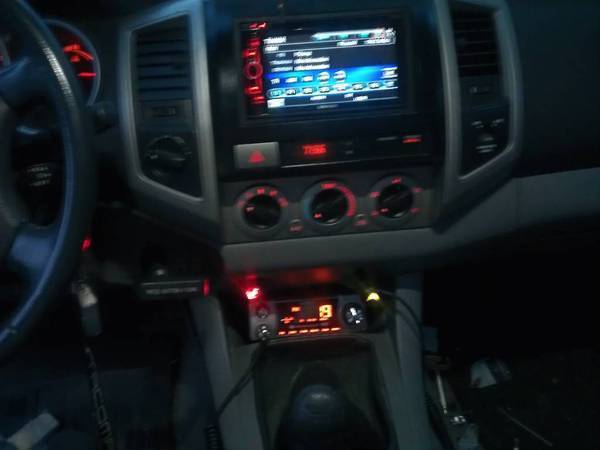

    i've cut up so many parts of my interior (in very visible areas too), that it's not a big deal. I figure i'll always have a cb in my truck too, so might as well make it a clean, functional instal.

    That's how I sold it to myself....had a cb since high school and can never hear it :)

    Wrap it in a long and narrow shape, as you would an extension cord. We recommend using two zip ties at each end to keep the coax in place. Be careful NOT to wind the excess coax in a circular coil shape, as this can cause RF (radio frequency) issues that will interfere with your signal.
    If you’re using a standard CB antenna (i.e., anything except a no ground plane, or NGP, kit), you’ll need to make sure your antenna mount is solidly grounded to the vehicle’s chassis. A bad ground will result in an un-tunable antenna and sky-high SWR levels.
    Guess I has some rework to do :eek:

    I don't think it's working right yet, made extra coax in a perfect circle like how explained not to do, and should ground my antenna mount good, then tune swr. The coax on the radio may be a lil iffy too, will check that last. Should kick ass tho as I had this one peaked and tuned....Tune up report on youtube showed this radio swinging 25w:cool:

    :cool: how hard can it be to get a cb working good :rolleyes:

    Gotta be the connection to the radio...I used to be the cable guy in UT for a year too :eek: but we had special tools for the stripping and crimping of the coax fittings, made it pretty brain dead....lotta good that job is doing me now :cool:

    Got the CB worked out, new fitting and tuned :) So nice having a CB that works well...whew.

    MIc mounted..

    Don't ask me dude. I effing hate CB'S. You know my troubles though. :pout:
    I love how well that fit in your cubby.

    Think I got it down, call me later and I can explain a few things that were screwing me. The guy I bought the source from hooked it up too....:D
