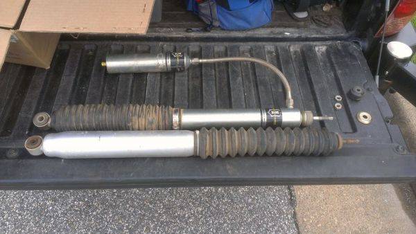

    These may ride a little better than the 7 year old rough country's on there now :)

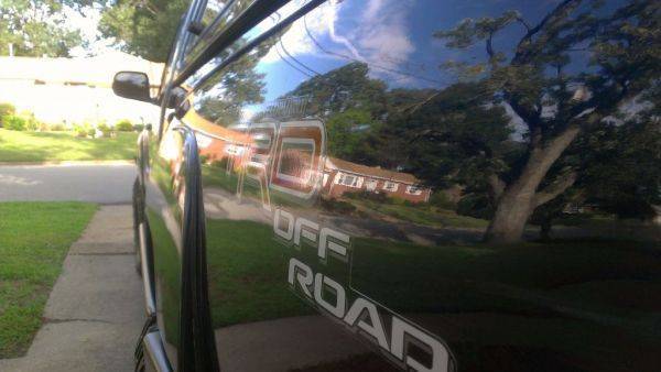

    Three step turtle yab :) Used rubbing compound, then polish, and hard shell wax. Turned out good.

    First time using a 3 step like that on dis one, needed it bad! Still a lot that stayed wif the blue color but a ton o scratches came out. Ready fer teh mall...

    That ink looks good when all cleaned up!

    noticeably better ride joejoe?

    let me know how they do if you ever have a chance to do any high speed wheeling. i love mine daily driving and crawling, but they aren't valved heavy enough with my bed rack and all the other heavy crap back there. wondering how they handle your cap at speed.

    I found them very satisfactory.
    Lookin' good JoeJoe! Hopefully not too much travel limitation...

    Oh yea, only rode em round town tonight doe.
    :notsure: won't be doing any high speed wheeling :p They're valved way heavier than the 7 year old rough countrys I been rocking tho
    :) loosing about 1-1/4" of down travel with em but got em for a steal :D and one of the shocks I just took off was leaking oil and dead as a mug!

    :D .......Shouldn't be that big of a deal loosing 1"

    Recommendation: Take 'em by your local welding gas supplier about once a year and get them recharged to 200 PSI. Even with everything working fine, reservoir shocks slowly leak gas like air leaks from a tire.
    Charging 'em is cheap ($10ish) and keeps the ride nice. Larry's done it for me since I've had the C/Os on the truck, but whatever method works.

    :cool: I can do that!
