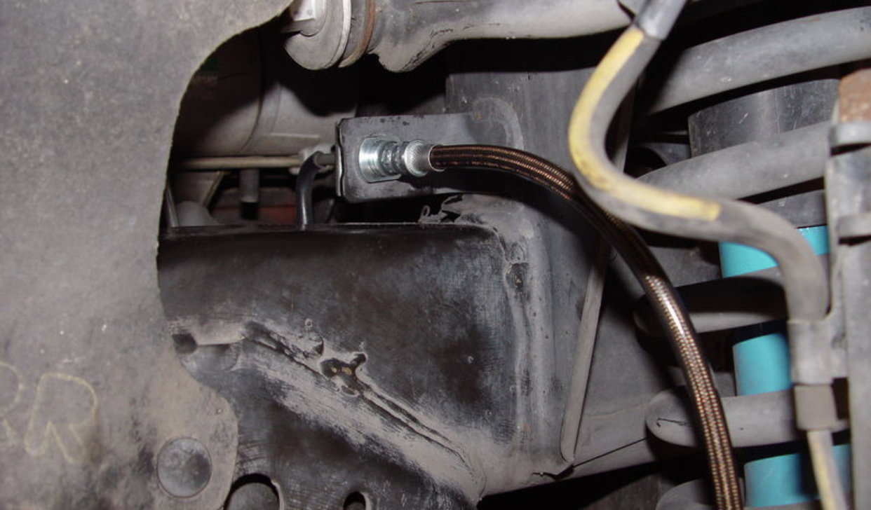

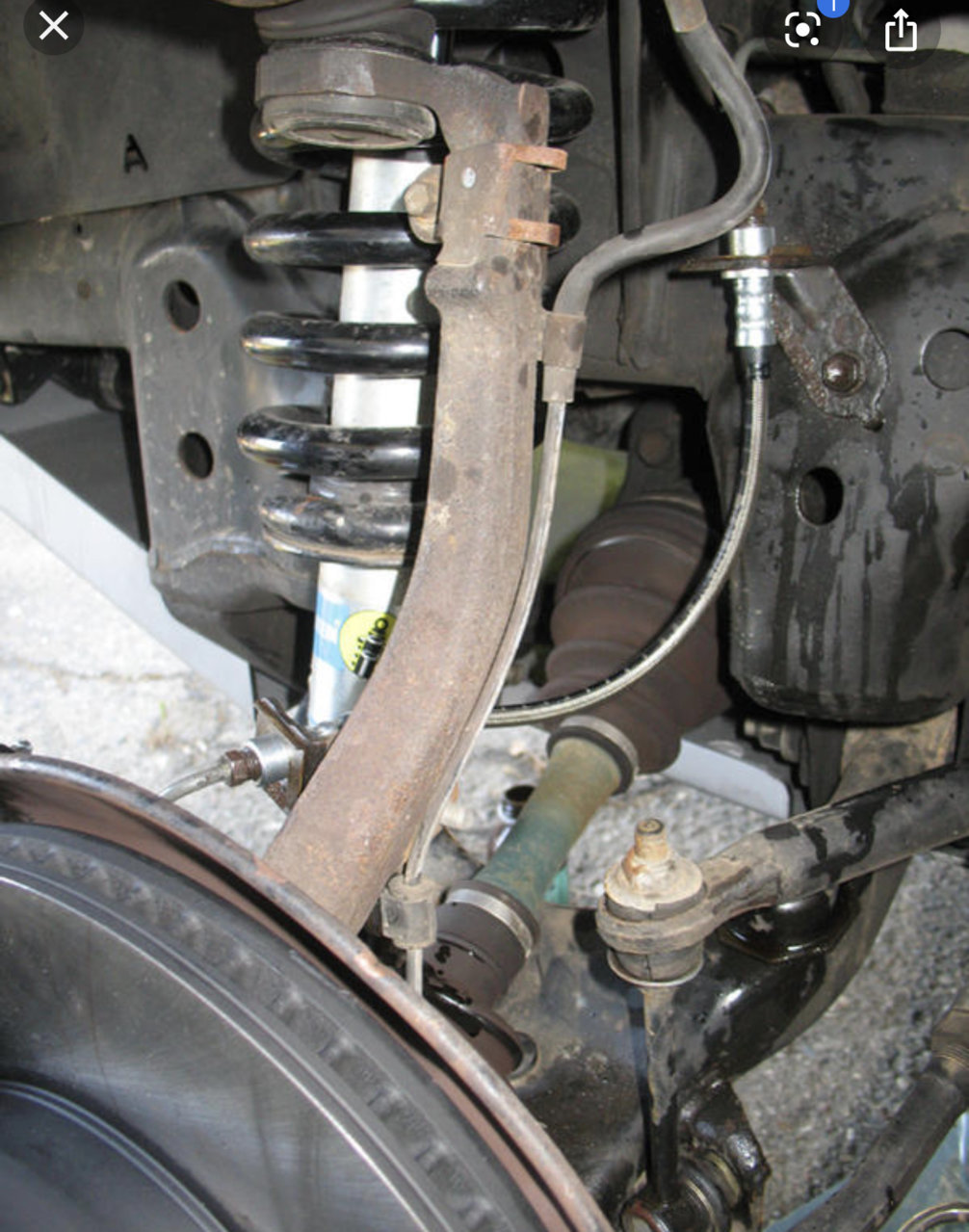

    Just a heads up. The mounting location for the soft lines are different in the 3rd gen 4runners than the 1st gen taco.
    Soft line for the 4runner
    1st gen location is near the frame and will require a longer soft line. 199A12C8-C106-48A3-A5EA-F842E4C5EE3C.jpg
