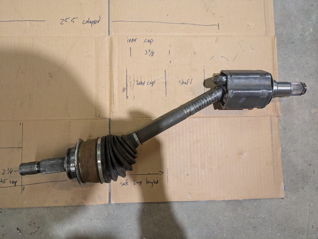

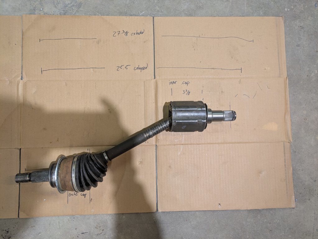

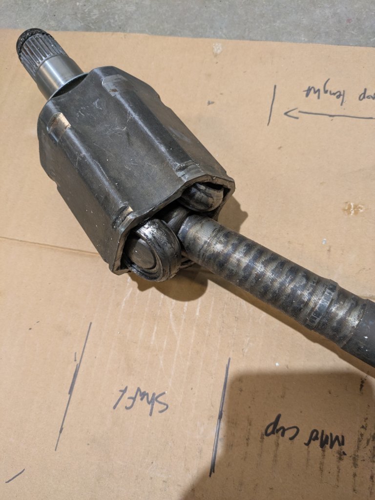

    Is anyone running the NAPA extended travel cv's I'm having an issue where I'm pulling the tulip bearings out at full droop. I put my sway bar back in hoping to limit the droop and they still just slide out and destroy themselves. OEM, Auto zone and o'reilly's.
    From my measurements and checking it out on the truck looks like I need an extra inch of shaft or inner cup. I'm really not trying to spend RCV money right now .PXL_20250114_012545437.jpg PXL_20250114_013352940.MP.jpgPXL_20250114_014743000.jpg
