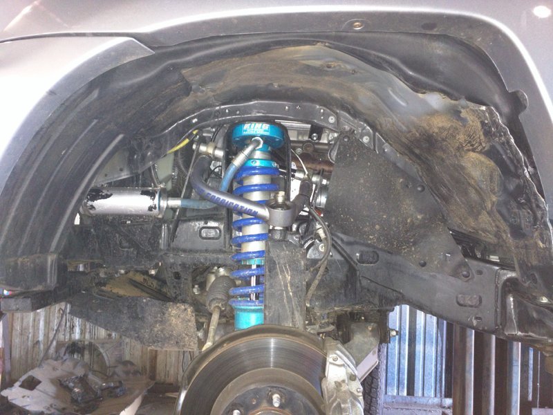

    They are more like UCA bolt gussets vs tower gussets. True tower support comes from a tower to tower cross brace.

    Honestly i wouldn't do them again. Total Chaos' own "Morocco Taco", the truck they race all over the African desert doesnt have the tower gussets. It has spindle gussets, cam tab gussets, and their second shock kit(bypass mount) and that's it. It was a PIA to install and it keeps me from running race headers. I got and installed them before meeting the TC crew and owners at the FJ Summit last year and we talked about them after i saw their race truck didnt have the gussets installed. So no, i wouldnt bother If i were you, the spindle and cam tab gussets are a must though. Thanks to @iJonny for answering also. He's usually pretty on point. lol

    Often under moderate to hard use. Both items are cheap insurance from an annoyance (cam tabs blowing out and ruining alignment) to catastrophic (bending a spindle and being trailered to a dealership/shop for replacement) failure.

    OBA is so underrated in my opinion.. I have been fine without spindle gussets but need cam tabs since my truck has been aligned so many times the tabs are weak.
