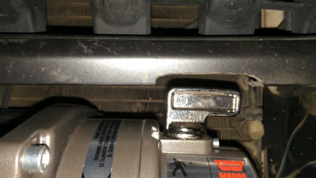

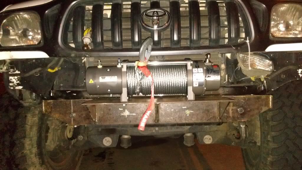

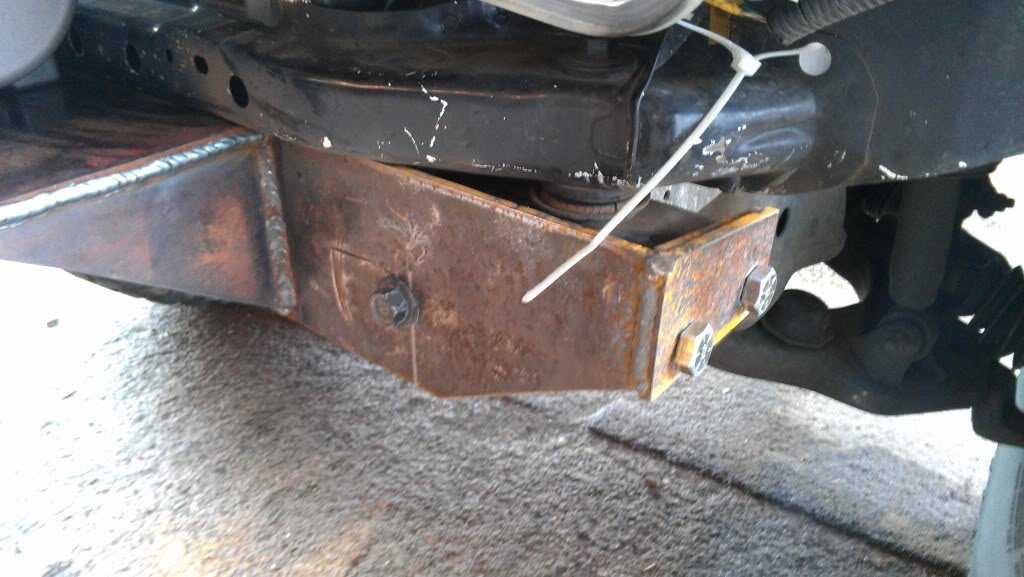

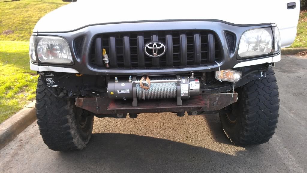

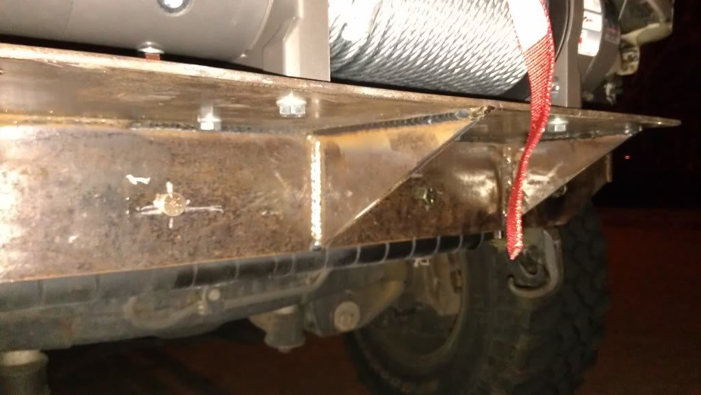

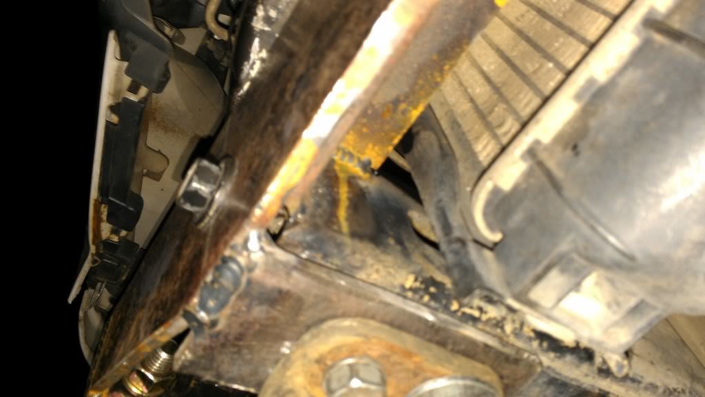

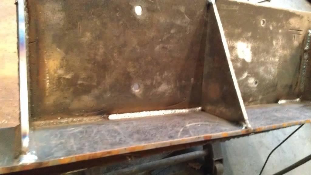

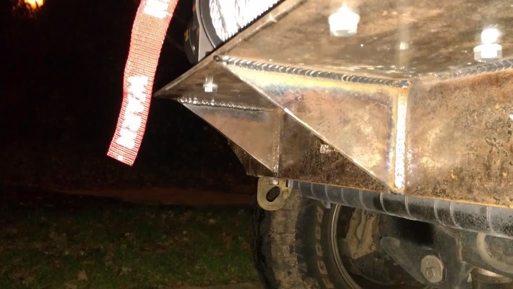

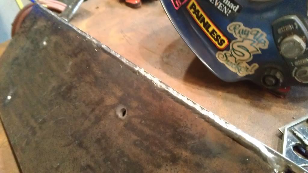

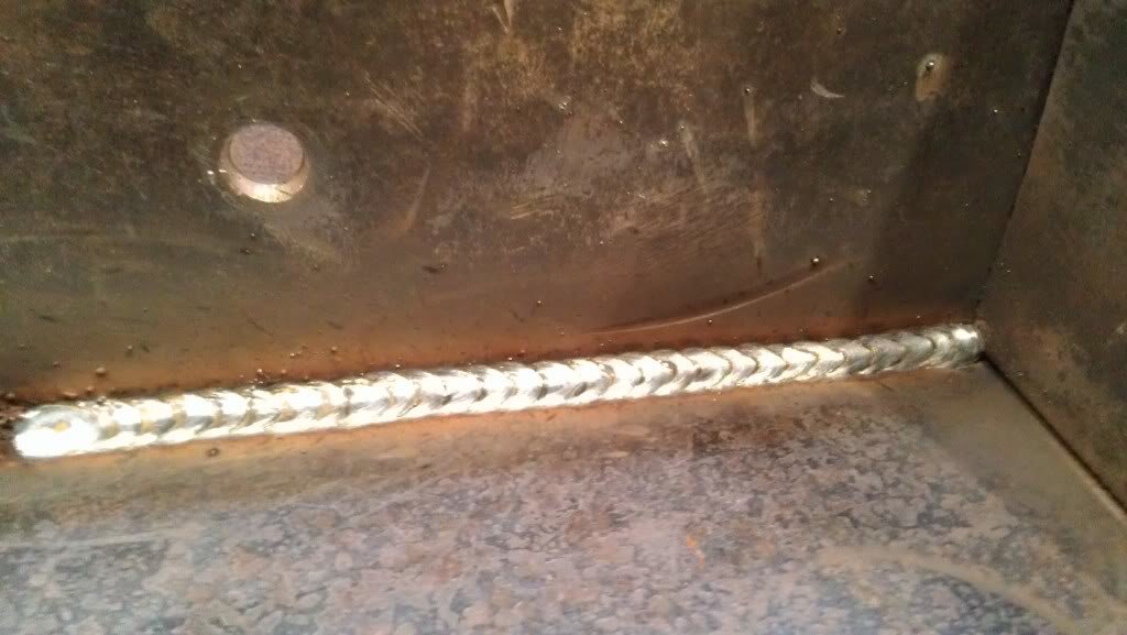

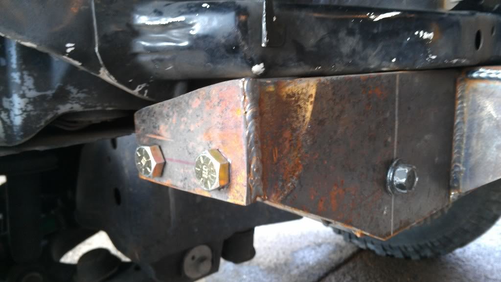

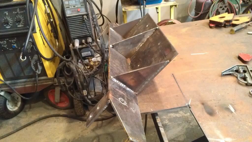

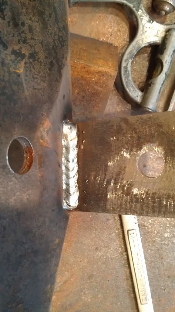

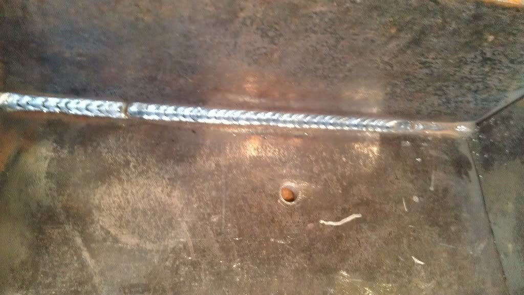

    Well my wife thought she would get me a Warn M8000 for christmas :) She's amazing! Now it's time to build a bumper to house the Winch. My initial thoughts are a tube bumper since thats what I had built before.

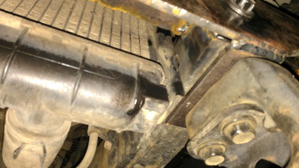

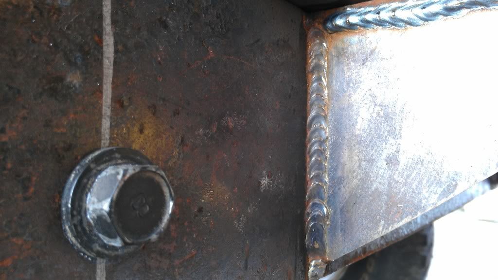

    I started by welding 1/4" angle between the front frame rails. This will be a good backing for the winch/bumper mount to bolt to and stiffen up the assembly. Next I fabbed together the winch holder and bumper base. I cut off the old side bumper mounts and beefed them up to 1/4". I also welded taps to follow the frame back and catch 4 more bolts at the tow hooks.
    Here are the pics of my progress so far... Please ask questions I'd be happy to answer.

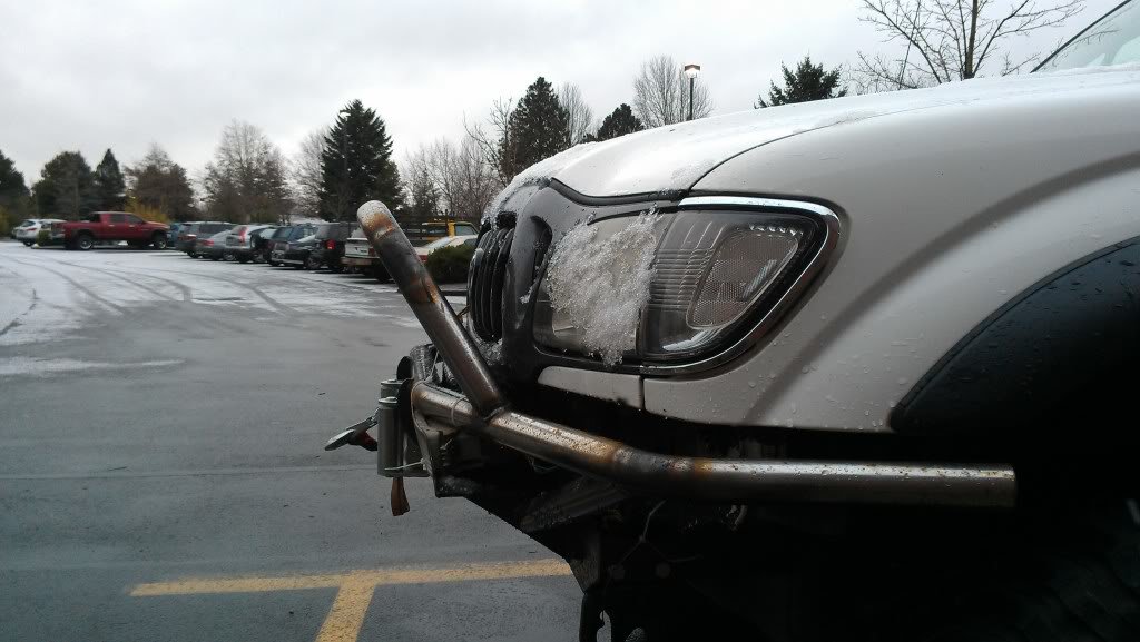

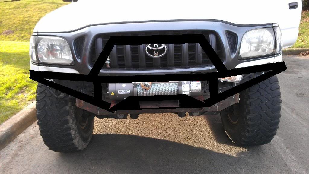

    Today I'll be picking up some tubing to finish off the bumper....
    Here is what I have in mind please forgive me for the crappy drafting

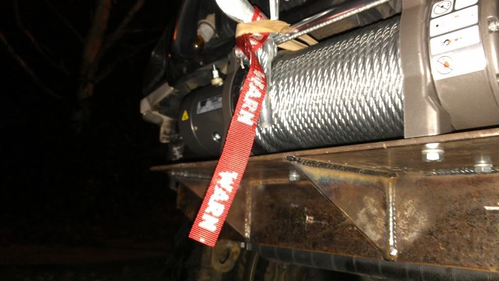

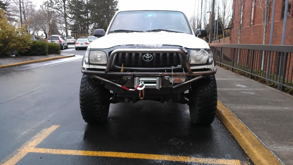

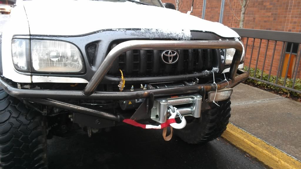

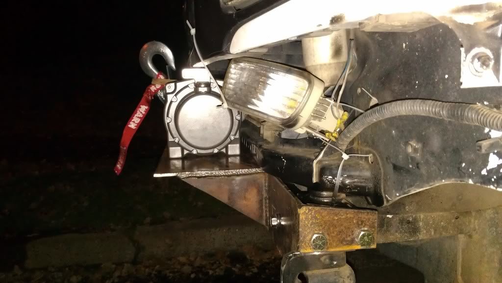

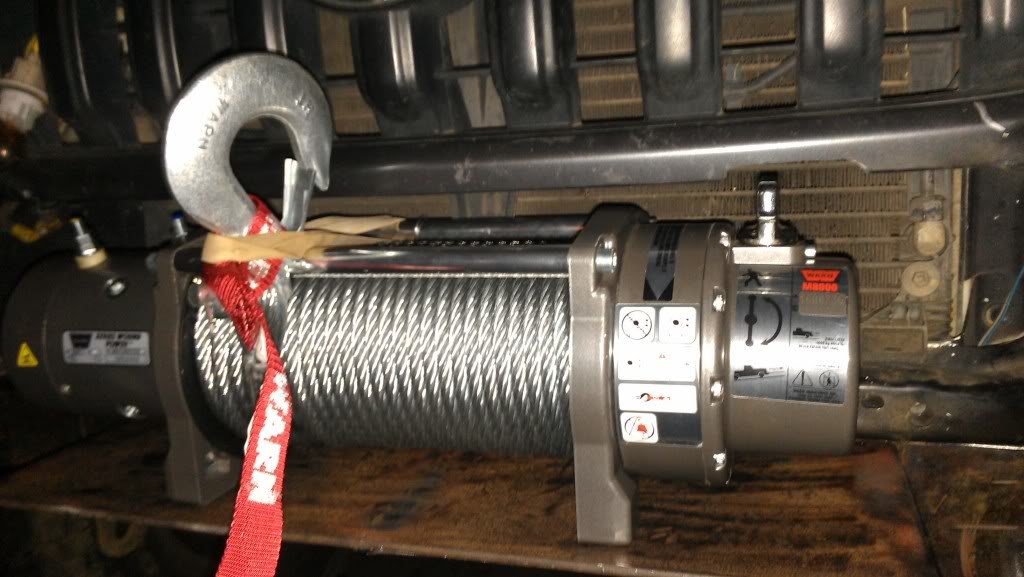

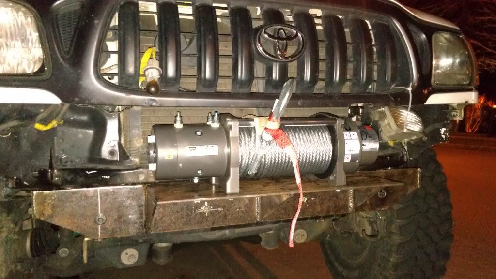

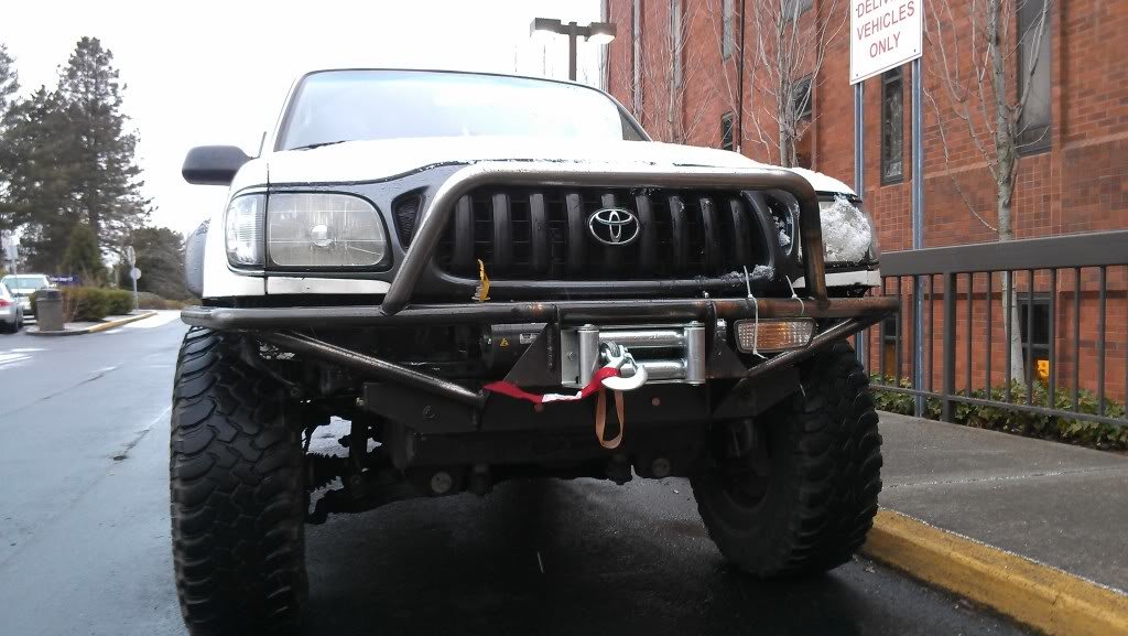

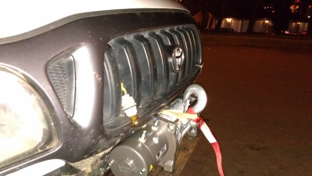

    Time for an update! Here are some pics of how it's looking with the winch secured and half painted tell me what ya think. IMAG0326_68df4fcdd9c3fd69433f9830bae027da20efc7b7.jpgIMAG0327_ce933b05a98ca8ad2e3ac84a7e1c5b438569c4ad.jpgIMAG0325_8639725319e4dc252623315aa176987a3c92a5c6.jpgIMAG0324_3b90b9770dc25ae79059abeb0bbdc9c7a4bb267d.jpg

    Fiolo
    Fiolo Senior member
    Sep 10, 2011
    #63227
    4,381
    1998 Tacoma, 2022 Tacoma, 2019 L5P Duramax
    Lost track many mods ago
    very nice man, not really a fan of that turn signal tiptied on the side tho

    Thanks man! Lights are next on my list...
