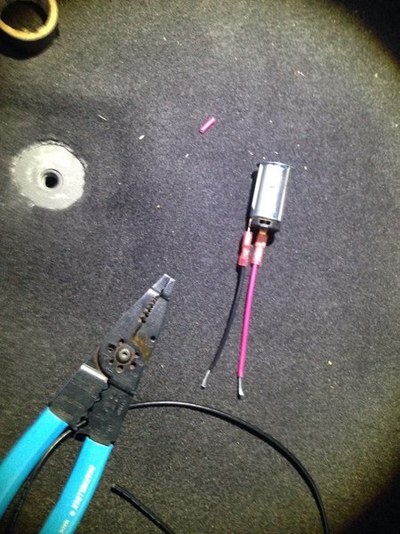

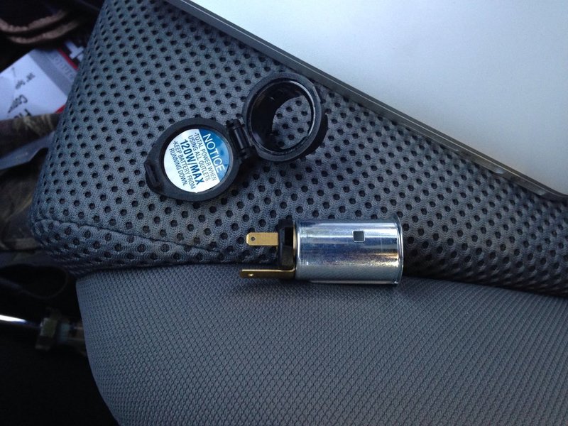

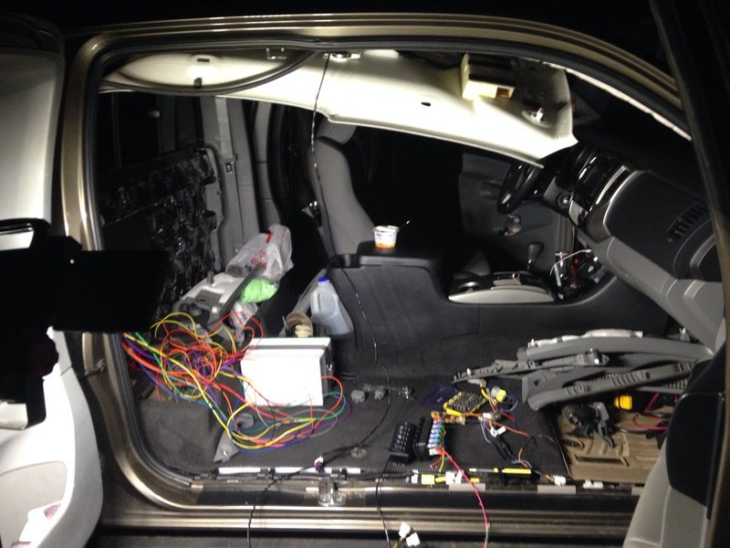

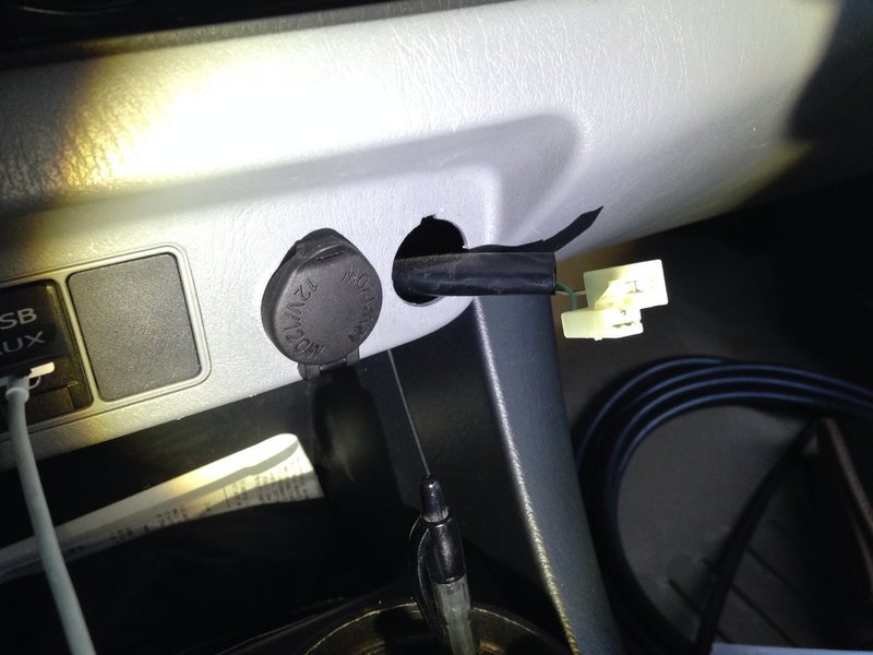

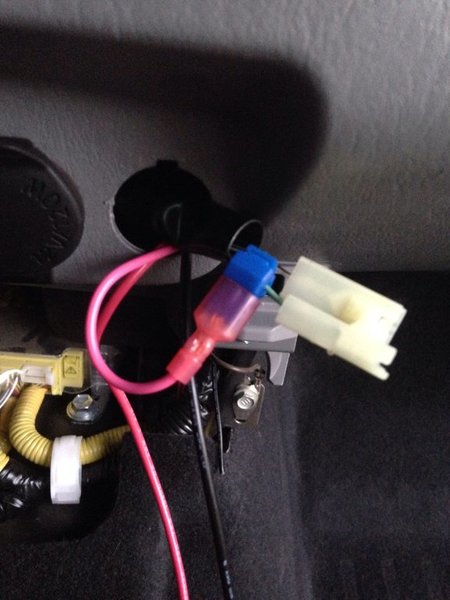

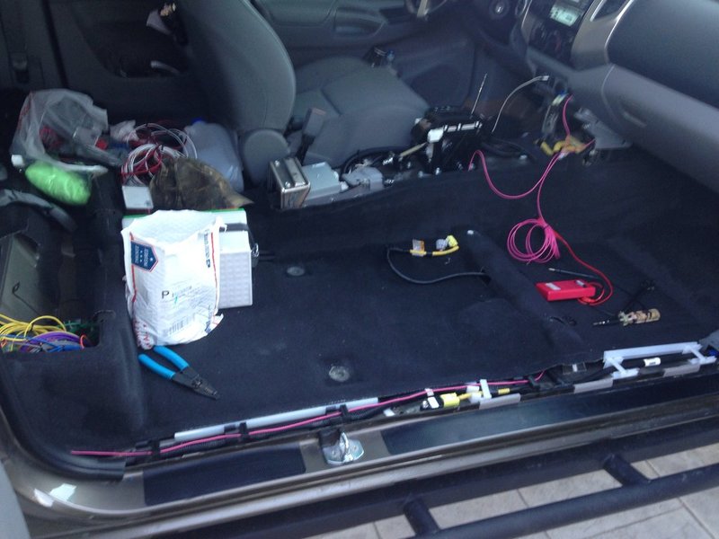

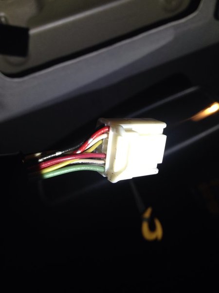

    Okay, this next part isn't very exciting but I'm trying to get caught up on this build. A bunch of wiring stuff which includes tearing your interior out. Some of it may be out of order so bear with me.

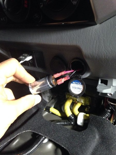

    I really hate that you can't charge accessories when the truck is off. I made one of my outlets full time hot which accomplished two things, one: I can now have stuff charge/run when the truck is off and two: I used the existing wire as my keyed 12V signal to trip my relay and power a "keyed 12V" fuse block separate from my Blue Sea block. Simply take it out. I stuck my finger in the hole, pushed down to get traction on it then pulled out.
    Unplugged and what it looks like
    That pink wire tapped into the green 12V+ is my signal back to the relay
    Blade connecters for constant power
    Plugged in and spliced
    Messy stuff

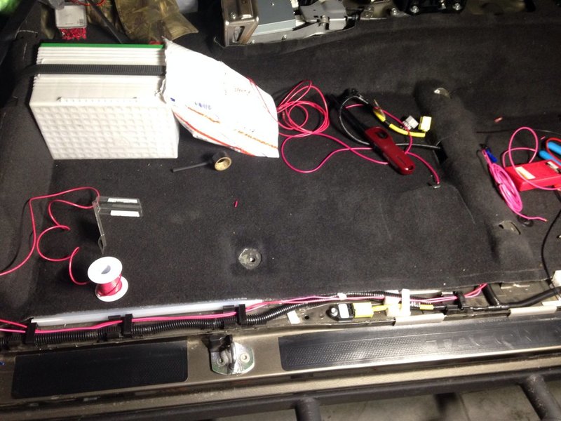

    The route things were ran. Along the passenger side floor
    It was all wrapped up with weave loom

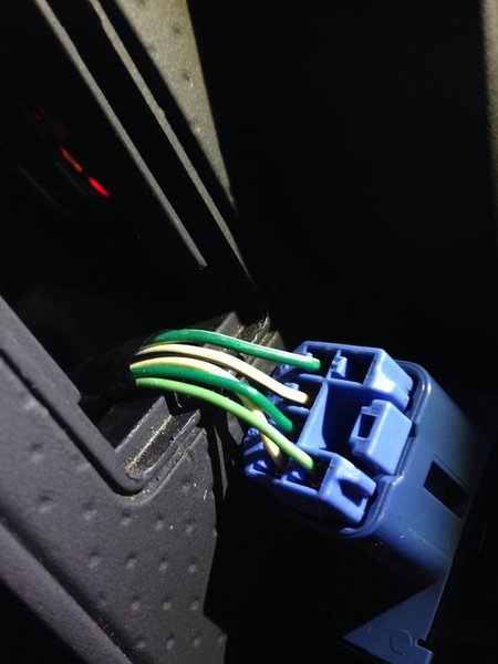

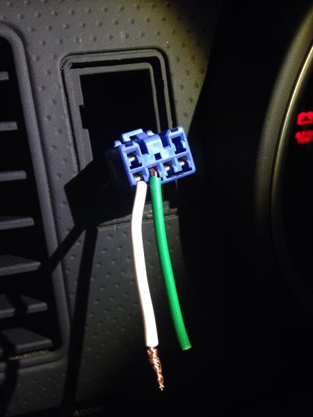

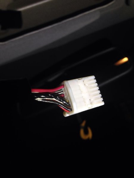

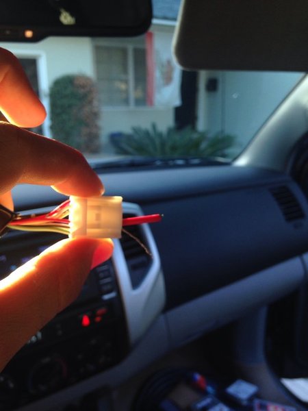

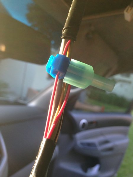

    This next part was me trying to find the signal from my backup camera to be the signal in to the relay for my auxiliary reverse lights. The lights are hooked up to a three position switch which is wired for auto/off/on. Once I found the correct wire, I just tapped into it.
    This is the plug coming from overhead and down to the rear view mirror with build in rear view camera. One side.
    The other side.
    Finding the right wires by sticking these in there and testing with a multimeter
    Tap into the correct wire for signal when in reverse

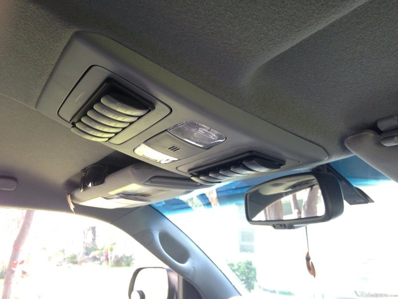

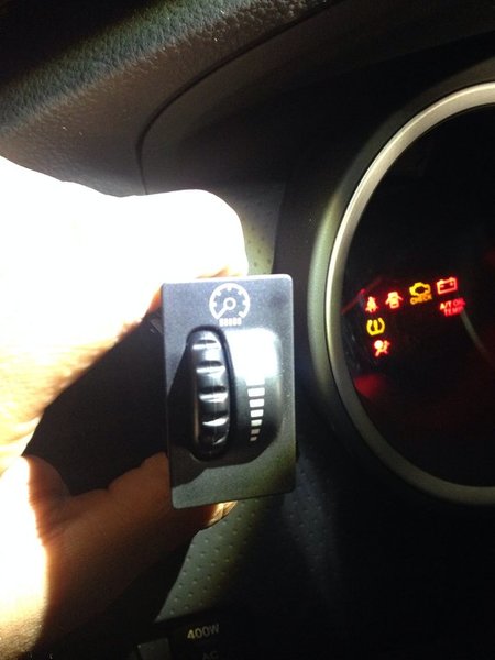

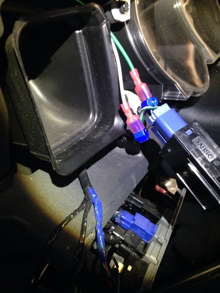

    This next one took a while to figure out. I wanted to have my overhead switches connected to the same dimmer switch as the rest of the dash/console lights.
    A bunch of different hot and grounds going through this switch. Used a multimeter and a test switch to find the right wires.
    These are the two you need that will control the dimming function
    Ended up removing a bunch of dash pieces to work on these wires. If you plan on doing ANY of this, you'll be good at removing interior panels in no time.

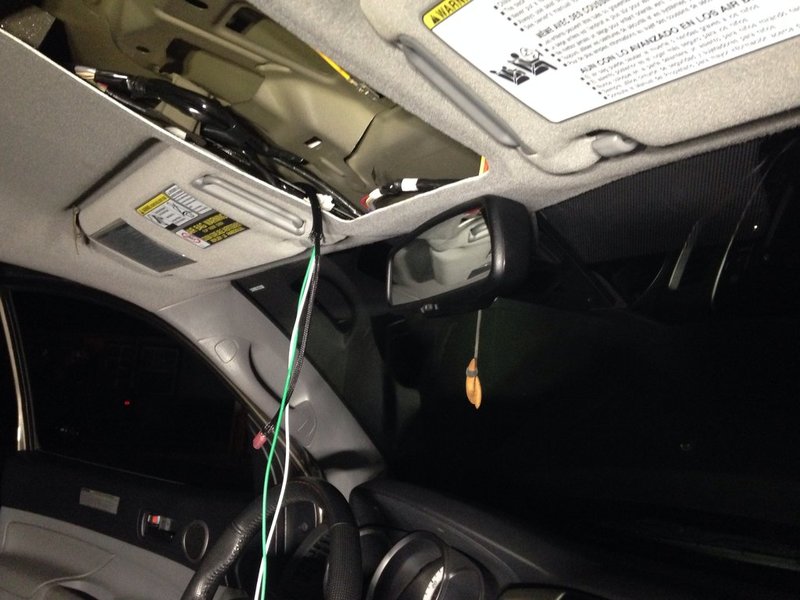

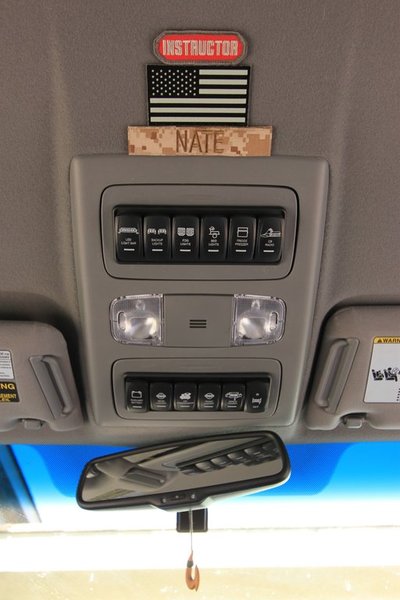

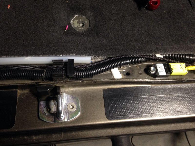

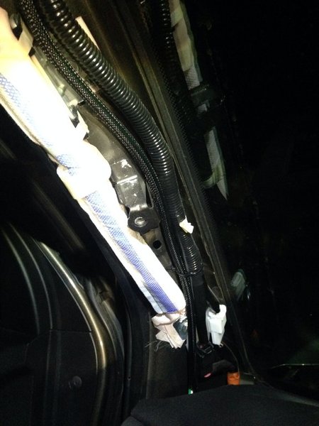

    Like everything else, wrapped up the wires then ran up the A pillar. Make sure not to interfere with the air bags when running lines through there. Ran the dimmer switch wires and some of the ML-ACR wires up there.

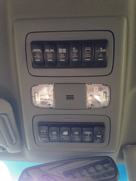

    Mostly finished product. Still more wires to be ran underneath and some figuring out certain switches. Some of these faces will get swapped out and repurposed

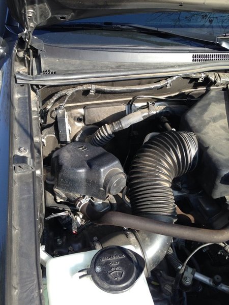

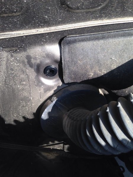

    Next I utilized an existing hole in the firewall to run some wire for a light harness. Took the plug out then protected the edge to not strip the wire.

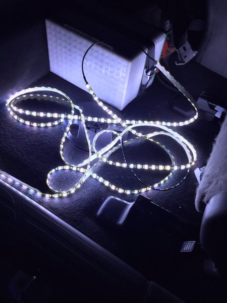

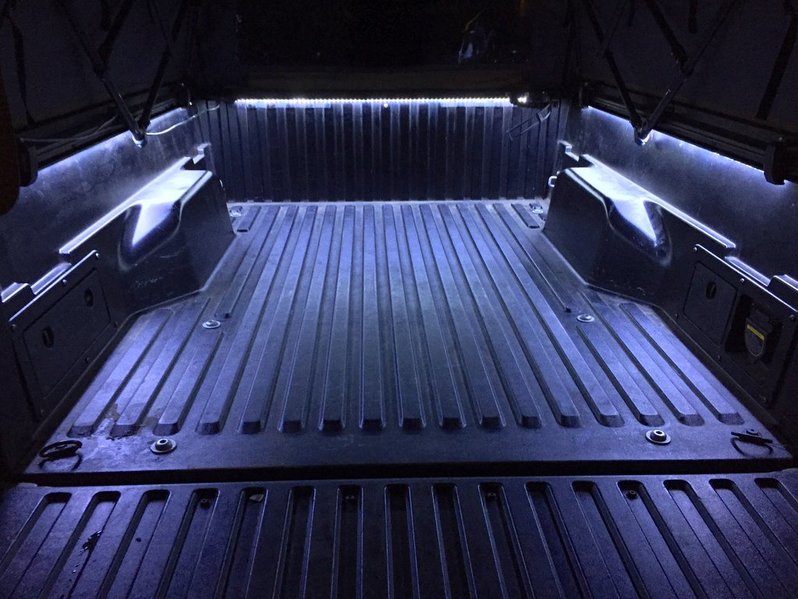

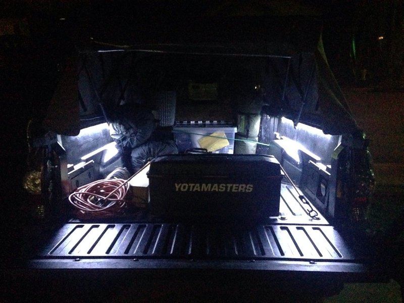

    Also tested some bed lights before install
    Bed lights also connected to a 3 position switch located over head and one switch in the bed for easy access while back there.

    Heck yeah man. Knock yourself out! It took me a while to figure out all the pin outs and tried to snap a photo of which wires were used for anyone else wanting to do it. If you have any questions on how it was wired up just let me know and I can help you out with that. I did all this a few months back but I remember most of it.
    Up in the overhead mirror harness there is also a keyed 12V+ wire that can be used to run a radar detector for those that want it tucked up under the mirror without having the power plug hanging down. Either spliced in or used to signal a relay and/or switch.
