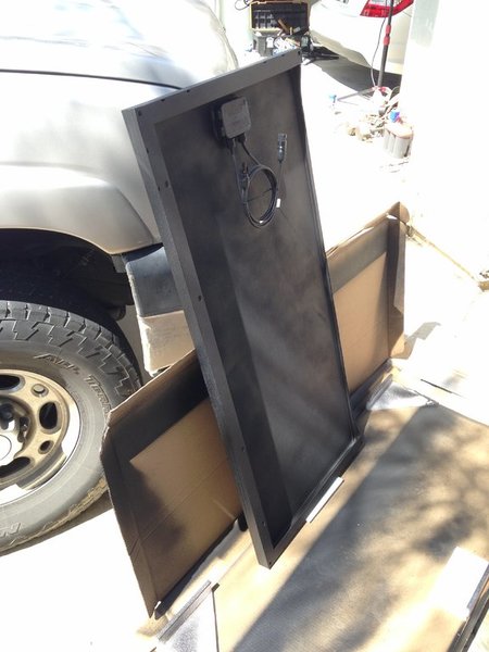

    Finally getting around to updating this part. I wanted solar to keep my second AGM battery topped off which runs the ARB fridge I keep in the cab 95% of the time. On a recent camping trip the fridge ran for 5 days without turning truck on before hitting the safety minimum voltage cutoff limit for the single AGM battery. This will keep it going indefinitely. I know the roof rack isn't the most efficient location to mount it based on the amount of peak sun exposure but that's fine for my needs. One day I'd like to go with the group 31 Diehard Platinum with Pelfrey mount up front. I'll eventually tie in the flexible 62W solar panel for times when camp is set up and won't be starting the truck for a few days.
    Inside the box is a Renogy 100W solar panel that's going up on the rack.
    Plastidipped the under side black and rattle canned the edges with the same spray on bedliner I've been using. Again, keeping things subdued and not draw attention to it all.
    Just mocking up for now. More details to follow.
