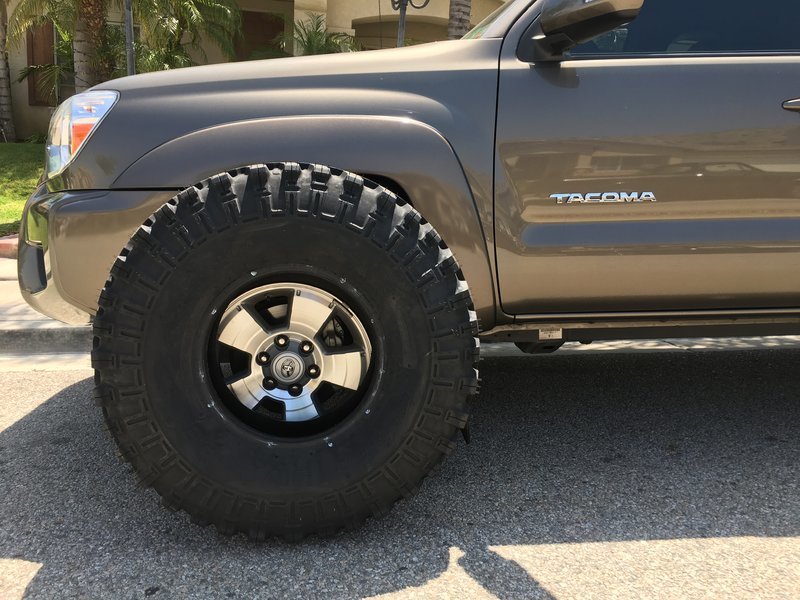

    Well, There goes all practicality. Gonna be interesting clearing for these things.

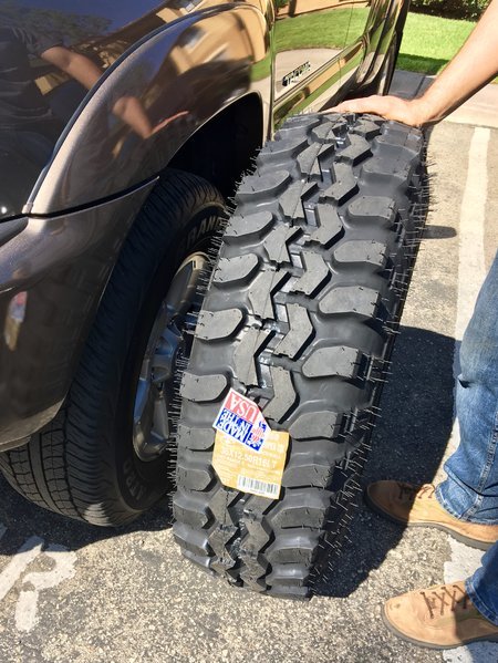

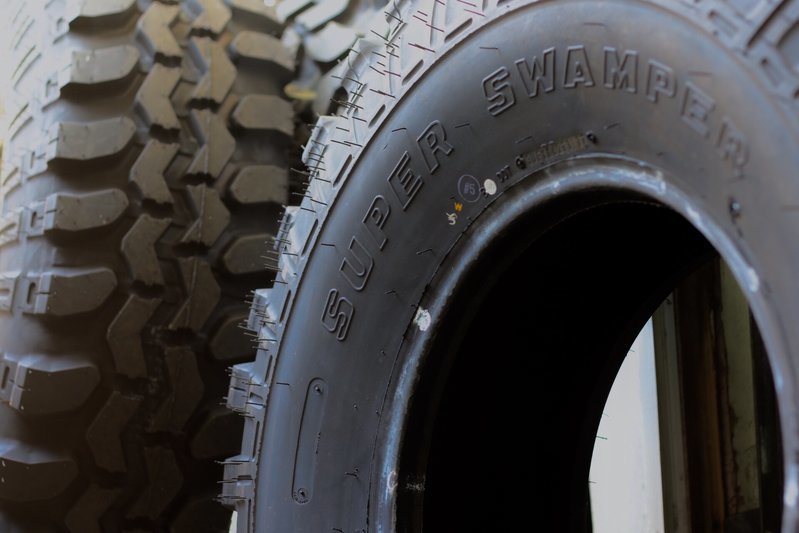

    Yeah. There were a few guys I've seen recently running swampers, north being one of them, so I figured I give them a shot. @NYCO just got a set of intercos so it was fresh in my head. Plus, if I could make the 35's fit with mid travel, 36's should be doable but everyone else I've seen with 36's had a body lift. I don't plan on doing that. Maybe a cab mount relocation. I'll be sure to document the process.

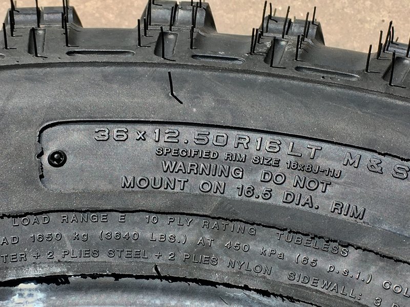

    Those tires are specced to be around .5" less than some of the "37" sizes. I'd be shocked if you didn't have to do some kind of tubbing, opening up the wheel well a bit.

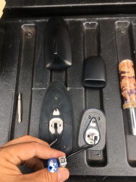

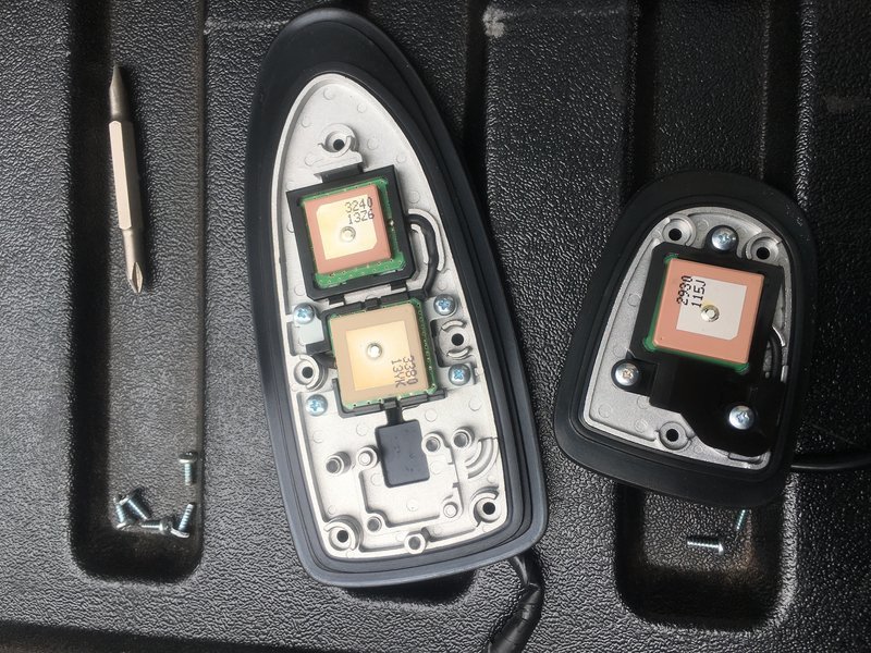

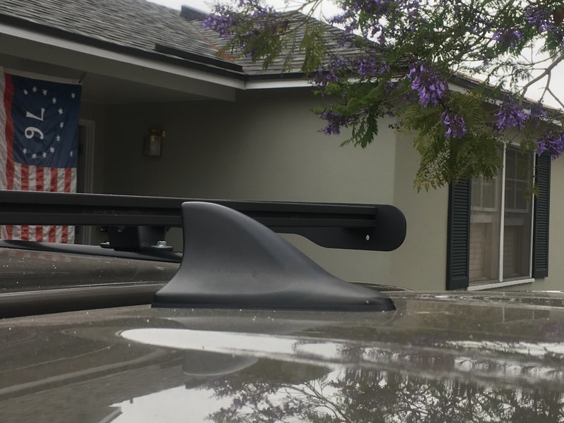

    Other random shit in prep for the prinsu access rack going on soon. Cap rack already on but never took photos of that. Pretty straight forward though.
    Got one of the lower profile antenna from an older Tacoma and basically gutted it to stuff 10 lbs of shit in a 5 lb bag. It's not pretty but it works. Never liked the shark fin and with the smaller one it'll help fitting the prinsu rack.
    Different plugs. Old has one chip. New shark fin has two.
    Everything works as it should. I honestly don't know what both chips do. I know one is for the Sirius/XM radio but have no clue on the other.
    I also had the roof of the cab and shell clear wrapped last summer in anticipation of having the racks on and not being able to clean under them regularly.

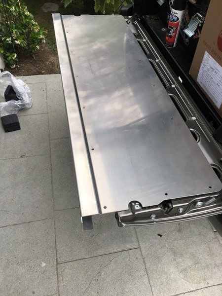

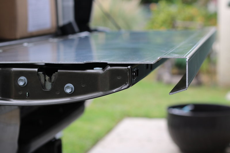

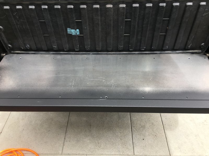

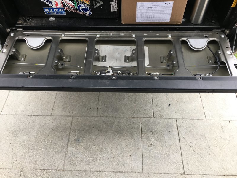

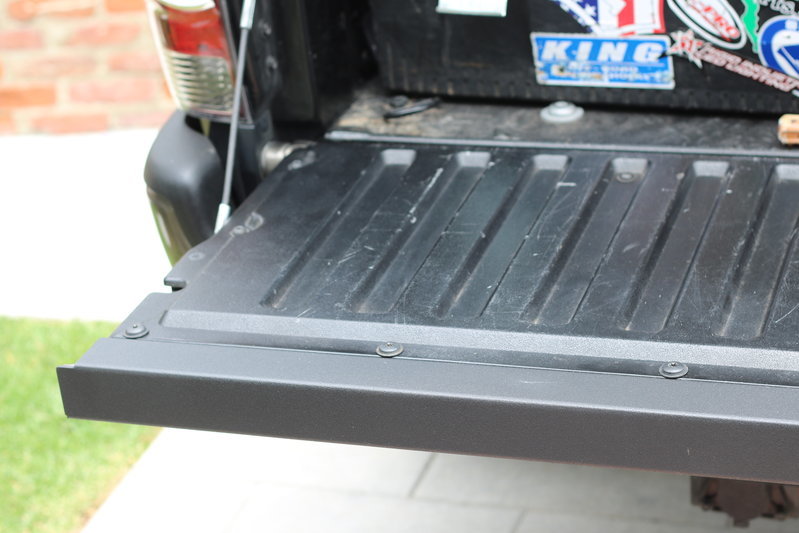

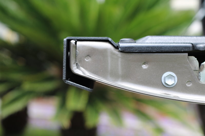

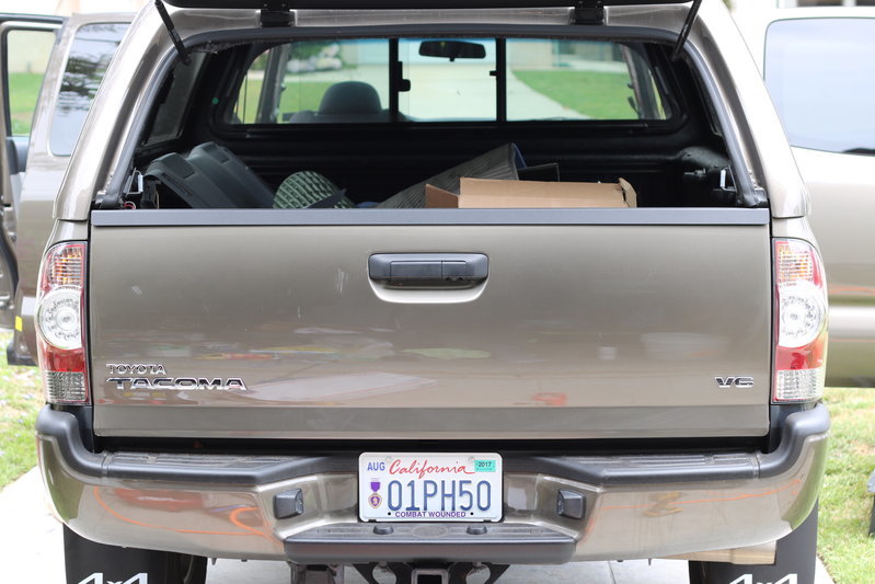

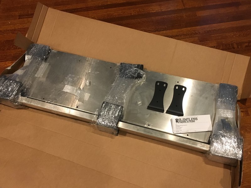

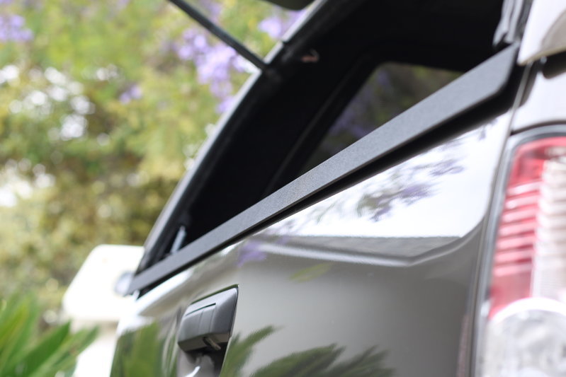

    Thanks to Eric @RelentlessFab for the tailgate reinforcement and bed rail quick fist mounts.
    Packaging was outstanding!!
    Remove the factory cap
    Checked fitment and it was absolutely perfect
    Just used some spray on bed liner for the time being to see how it'll hold up. Only sprayed the part that'll be exposed. Only thing I had to do was drill 3 holes where the factory cap has some indexing pins. Two on the bottom and one on top.
    Next you'll have to enlarge the holes with a step drill bit to be able to reuse the factory cap with torx bolts.
    Only thing to add is you'll either need to remove the rubber tailgate bumpers or trim them down if you reuse the factory fiberglass cap. That small amount of extra material puts extra tension on the tailgate handle to where it feels like it'll break when pulling on it to release.
    Once again, great product Eric!!

    On a serious note, from what I've read around the net is the TSL's are about an inch taller than the MTR's you previously ran. I don't expect there to be too much more work to get them to fit. However, I don't know how hard it was to clear the 315's so my assumptions are probably wrong.
