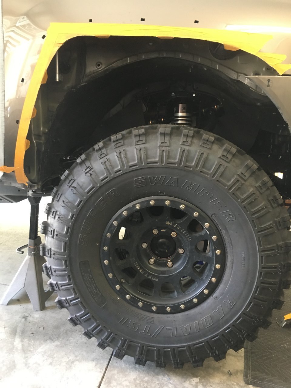

    Going from this
    To this...
    There seems to be a lot of rubbing. I can barely turn actually. Do guys usually have to trim anything to fit 36's?

    Spacers and drop brackets should solve that :thumbsup:

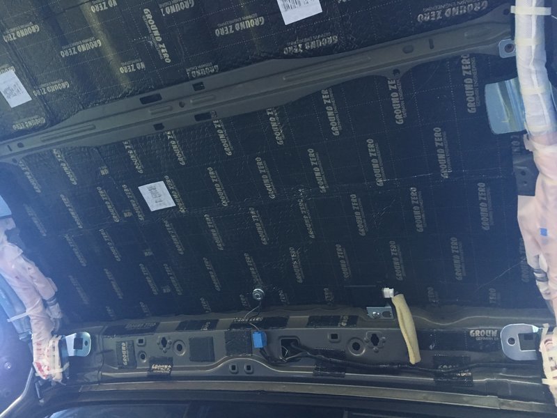

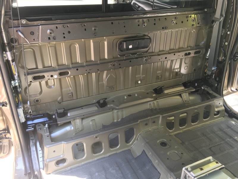

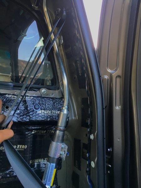

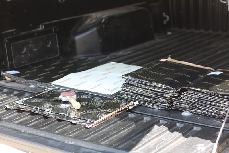

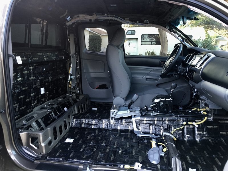

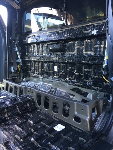

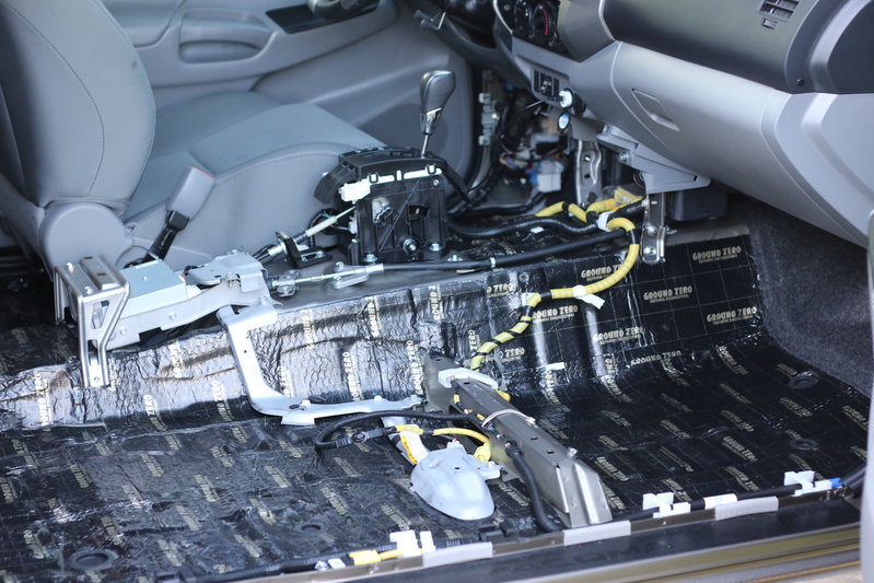

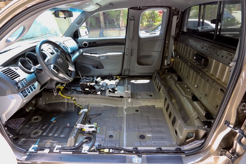

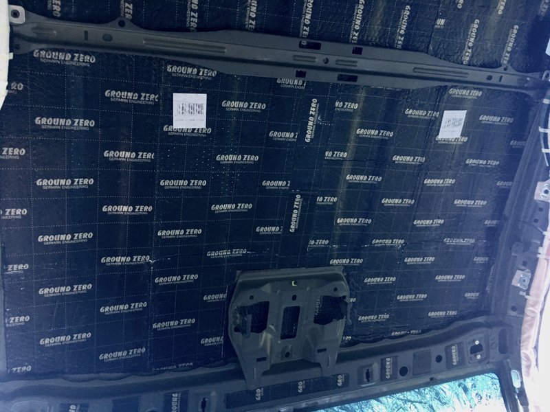

    How long did it take you to strip the interior bare to be ready for the deadening?

    I had some 15mm spacers made up to clear the shocks.
    Thanks!
    First time doing it, maybe 2 hours. Having stripped the interior many times before, probably an hour using power tools.

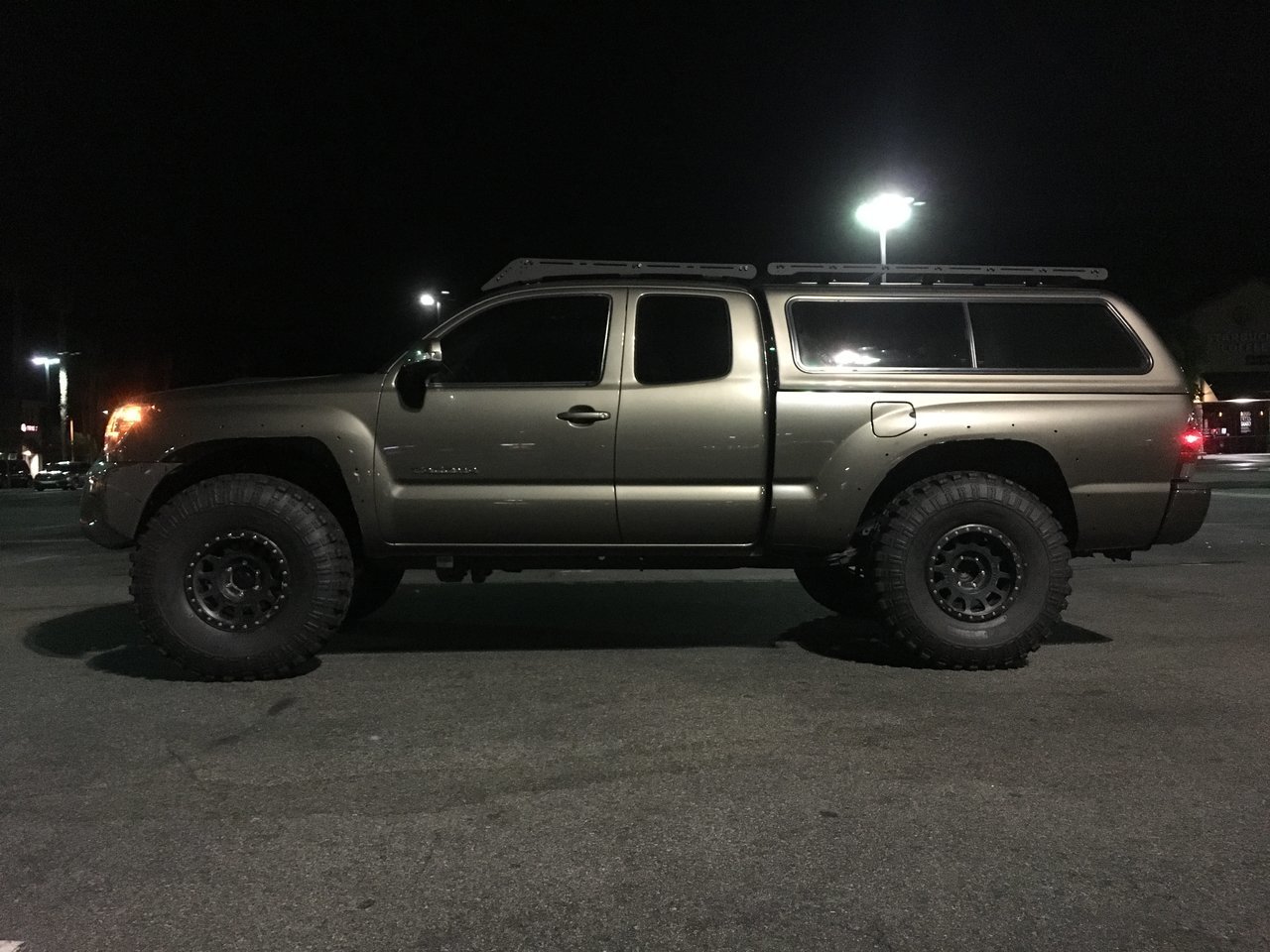

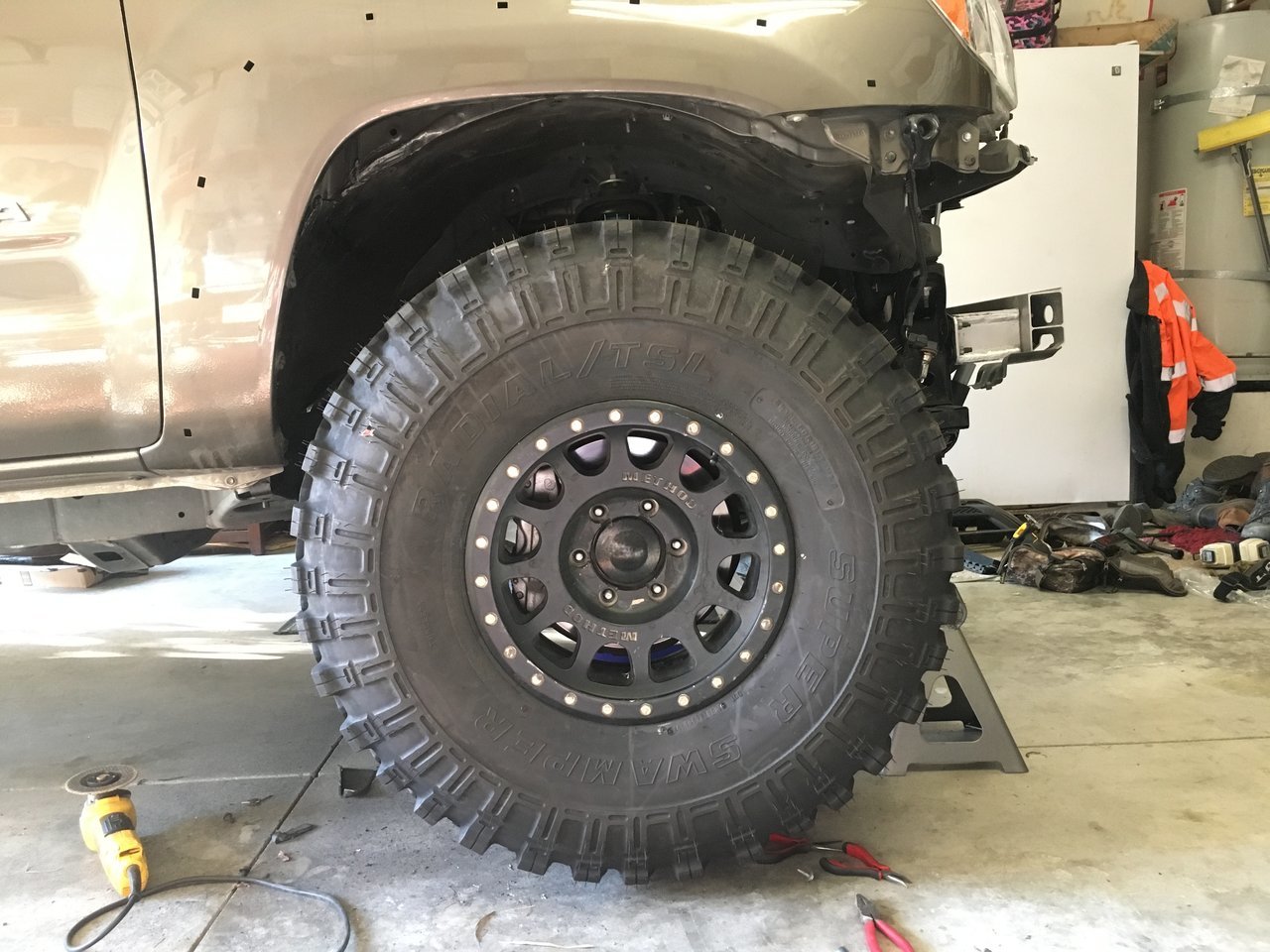

    Fenders cut and 36's on with no lift and sagging negative springs in the rear. Getting there...

    Ha! Not even close. I need to unfuck the rear. The camper shell has really been causing some issues. First it was the bedsides spreading from the weight. Then the rear leafs remain at a constant negative arch. Riding the bumps on the regular.

    After measuring horizontally they are right at 36" and vertically with weight they're about 35 1/4"

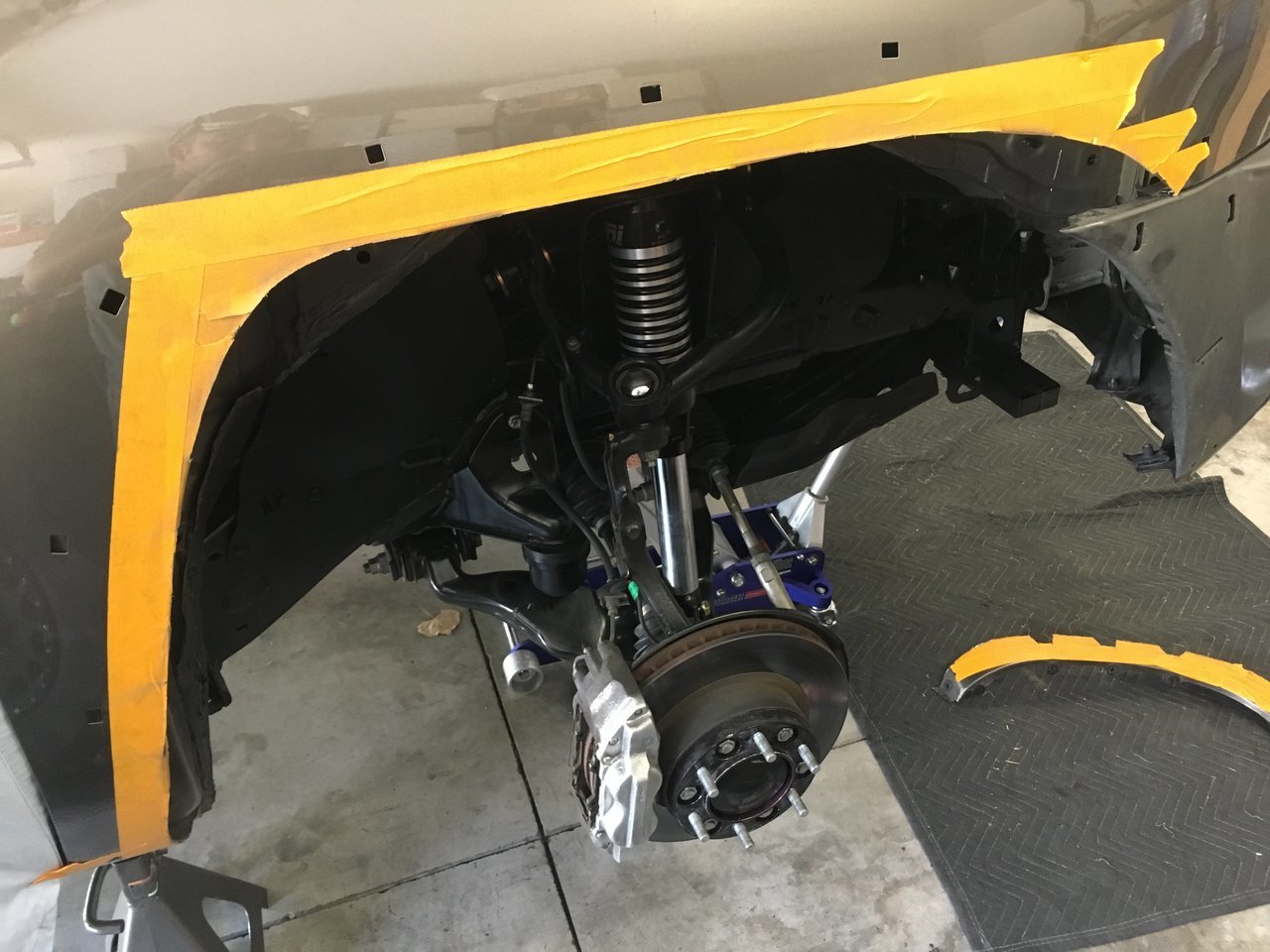

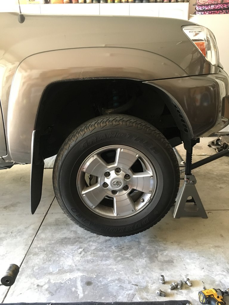

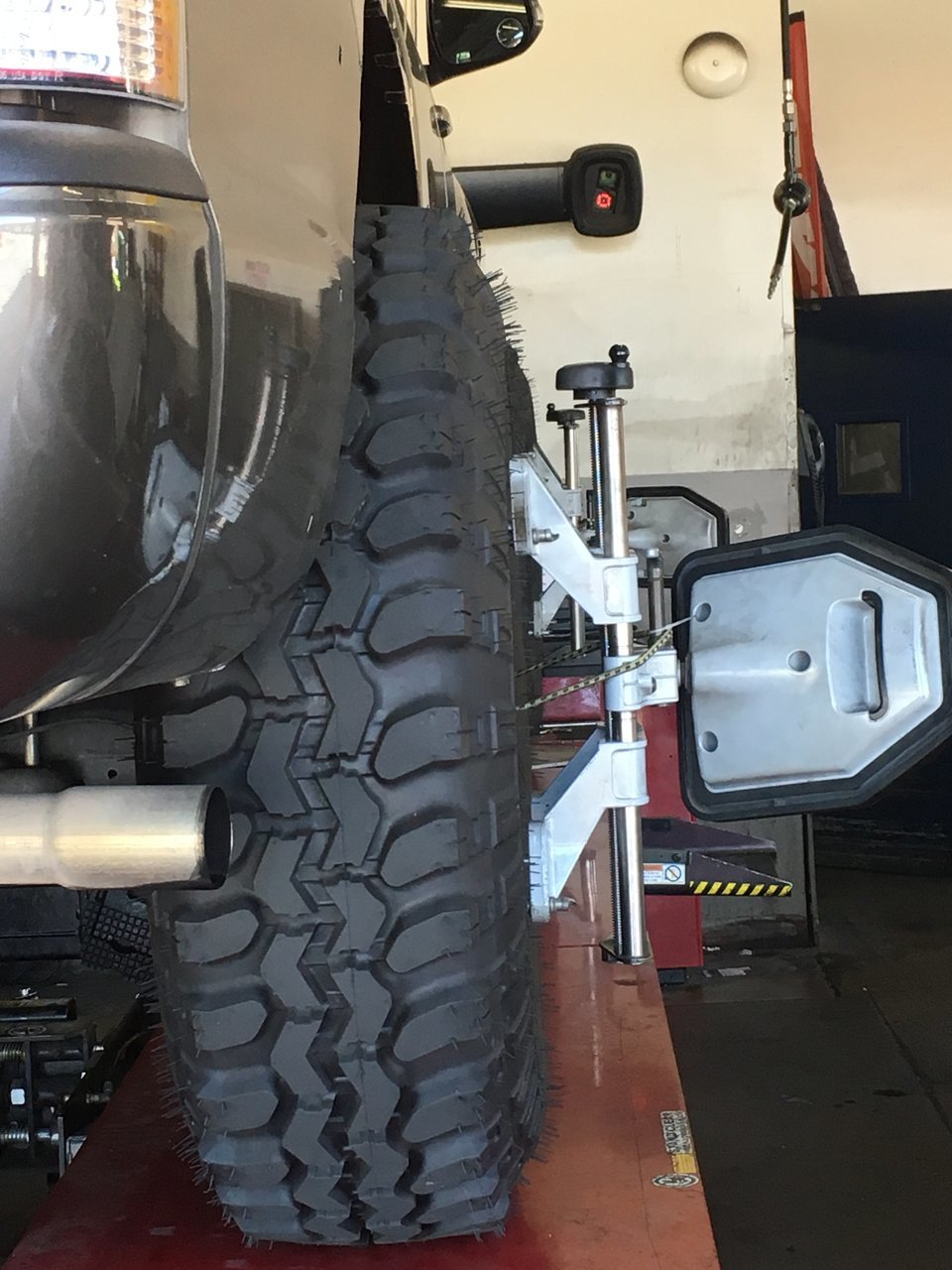

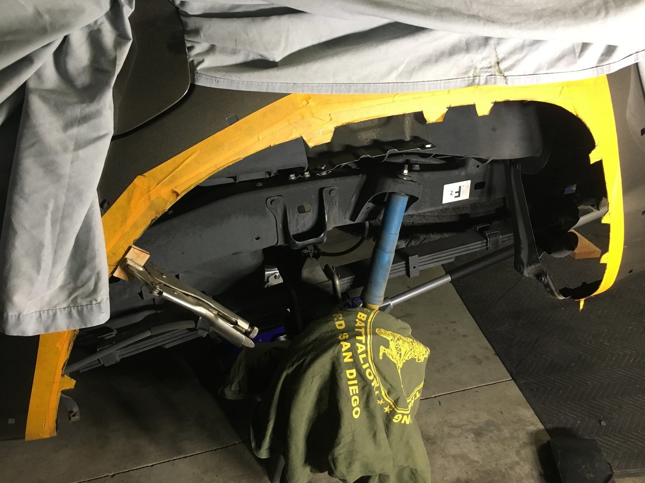

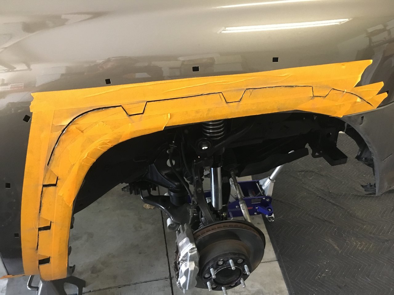

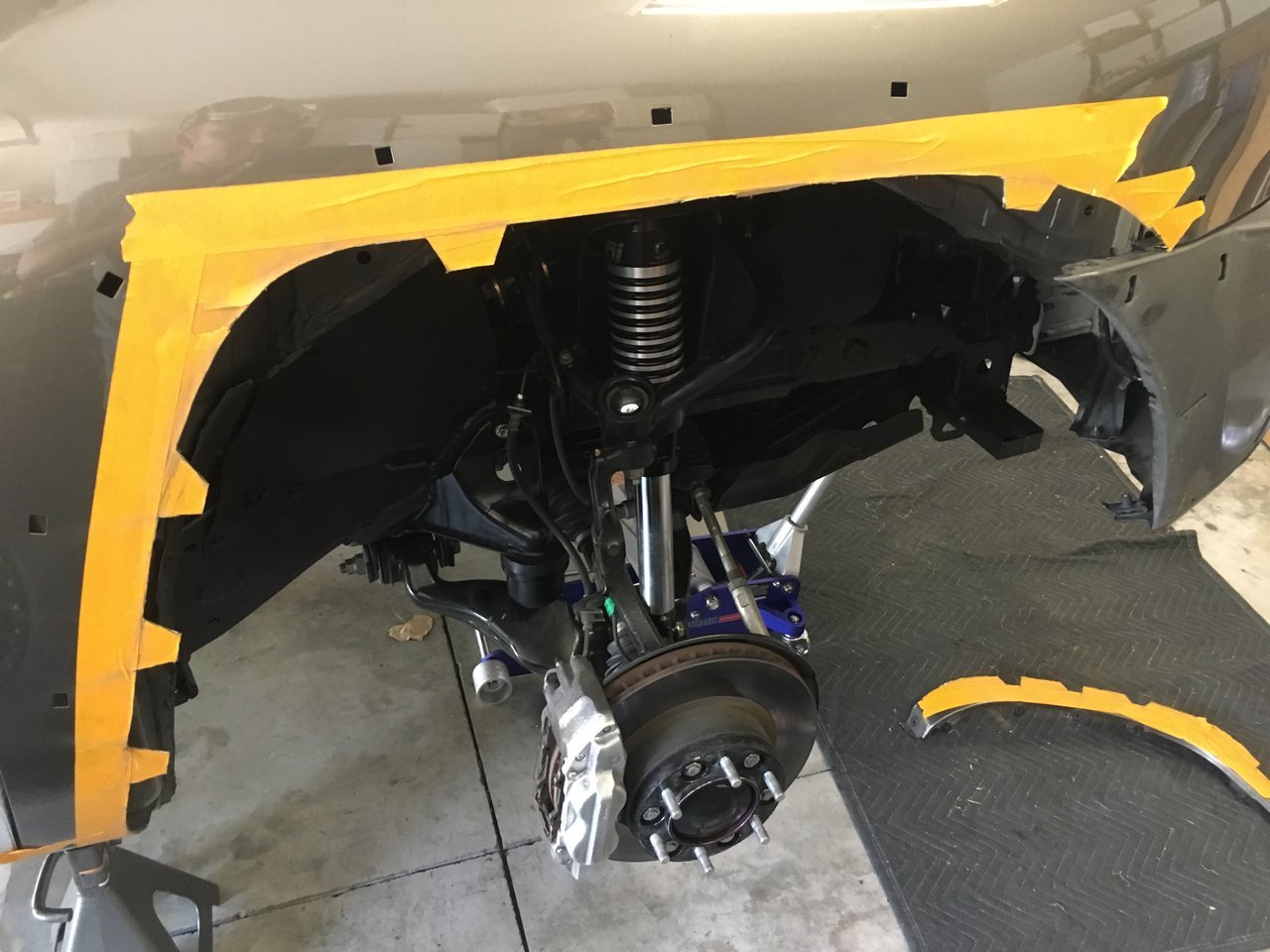

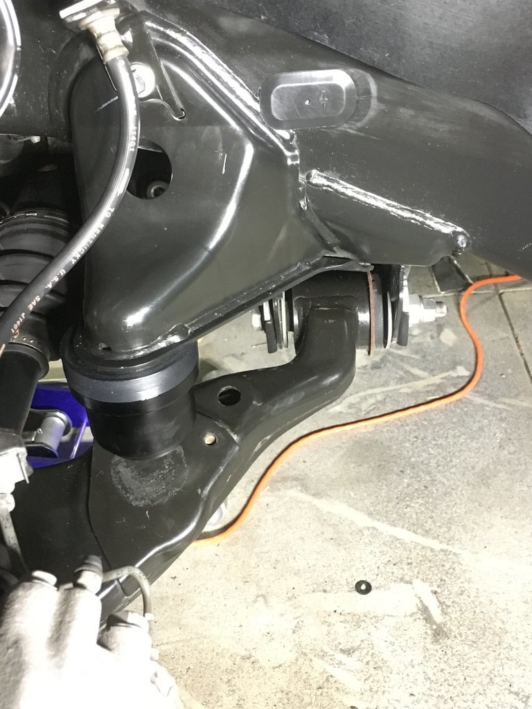

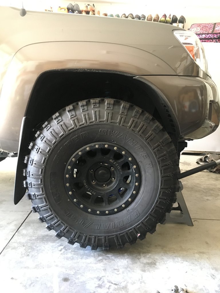

    Got these on and had to clear them since I’m not running a lift.
    Used some superbumps with spacers to prevent tires from chewing up the top of wheel well

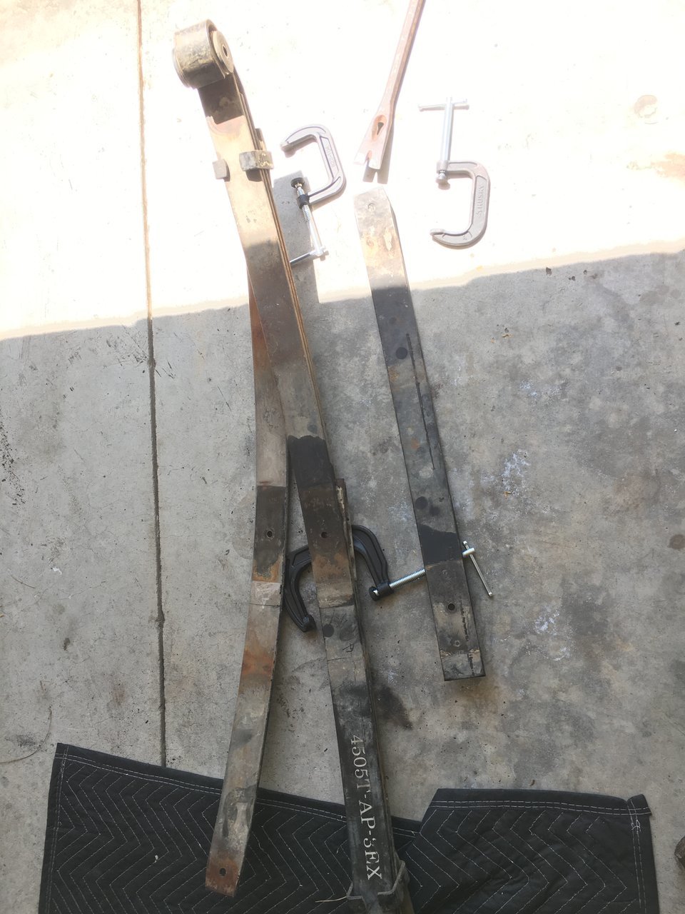

    Took apart leaf pack to clean up

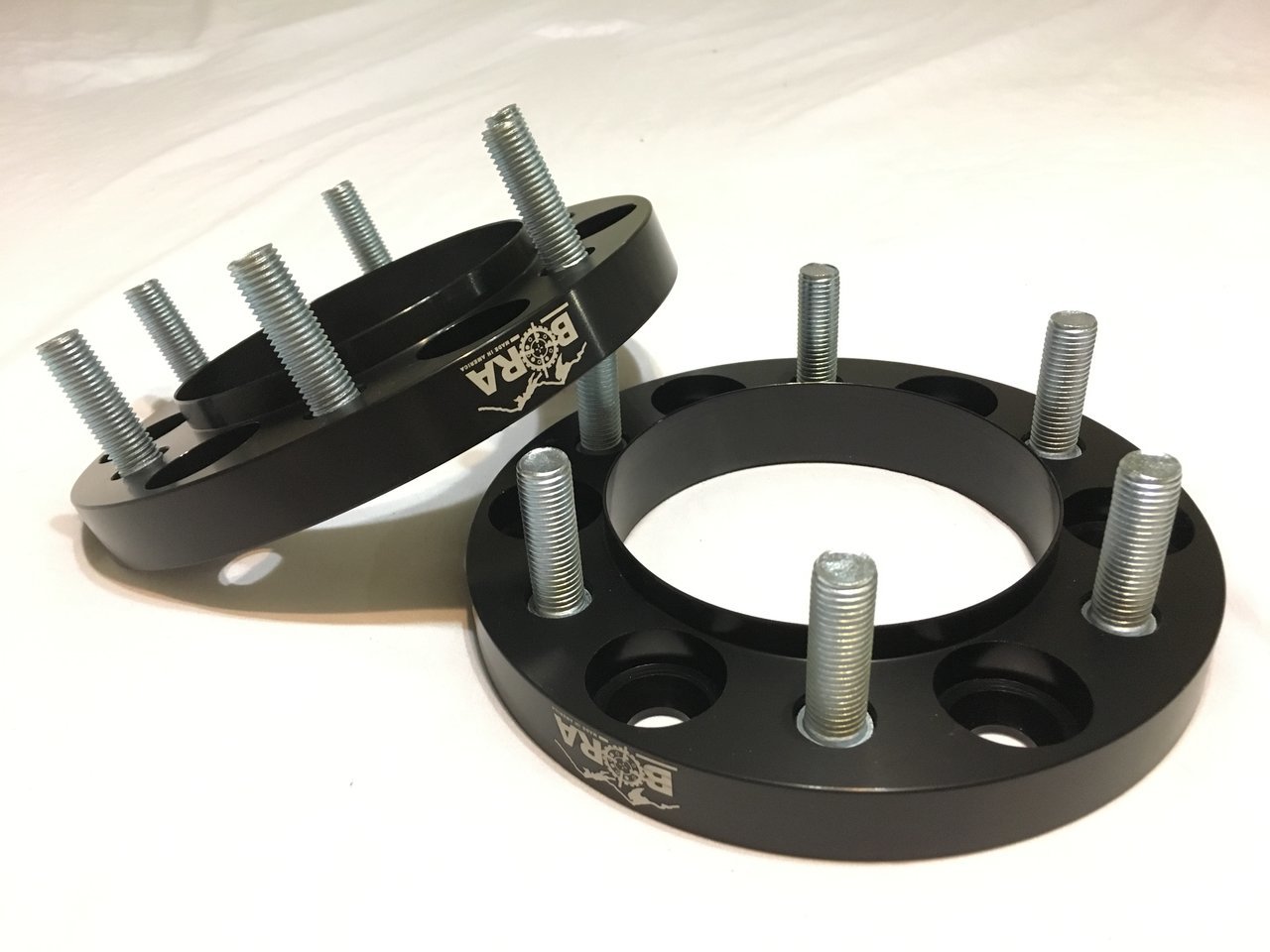

    BORA 3/4” wheel spacers. They are hub centric. 106mm to 108mm

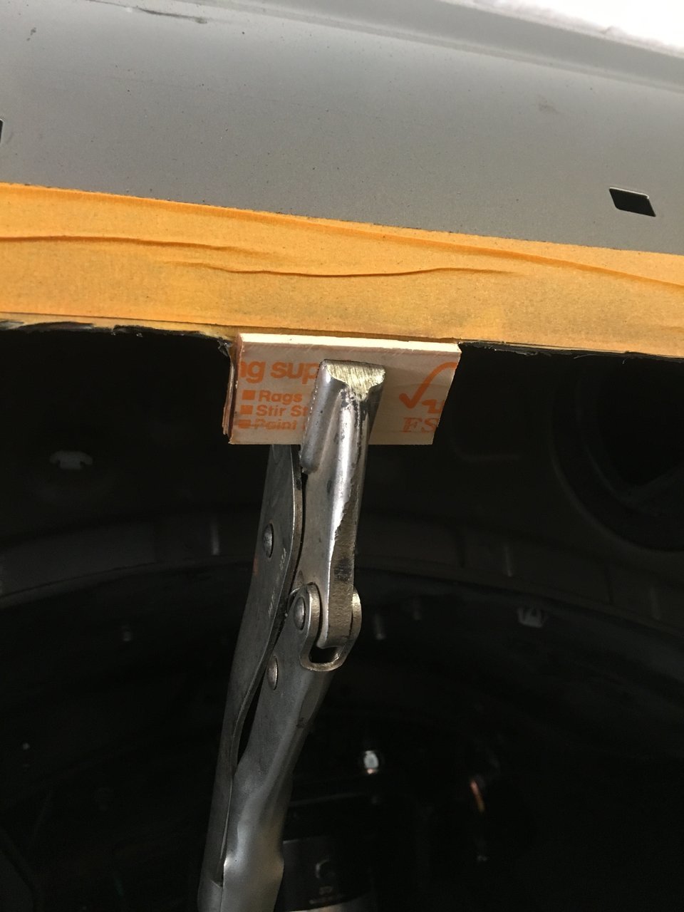

    Traced out the cut and left tabs to fold in
    Used Vice Grips and some flat wood to grasp and fold under

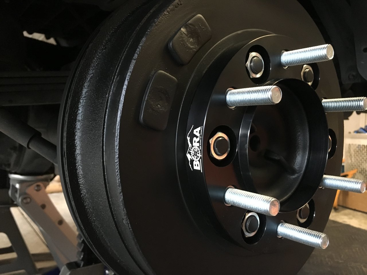

    Then the rear
    3/4” spacers on

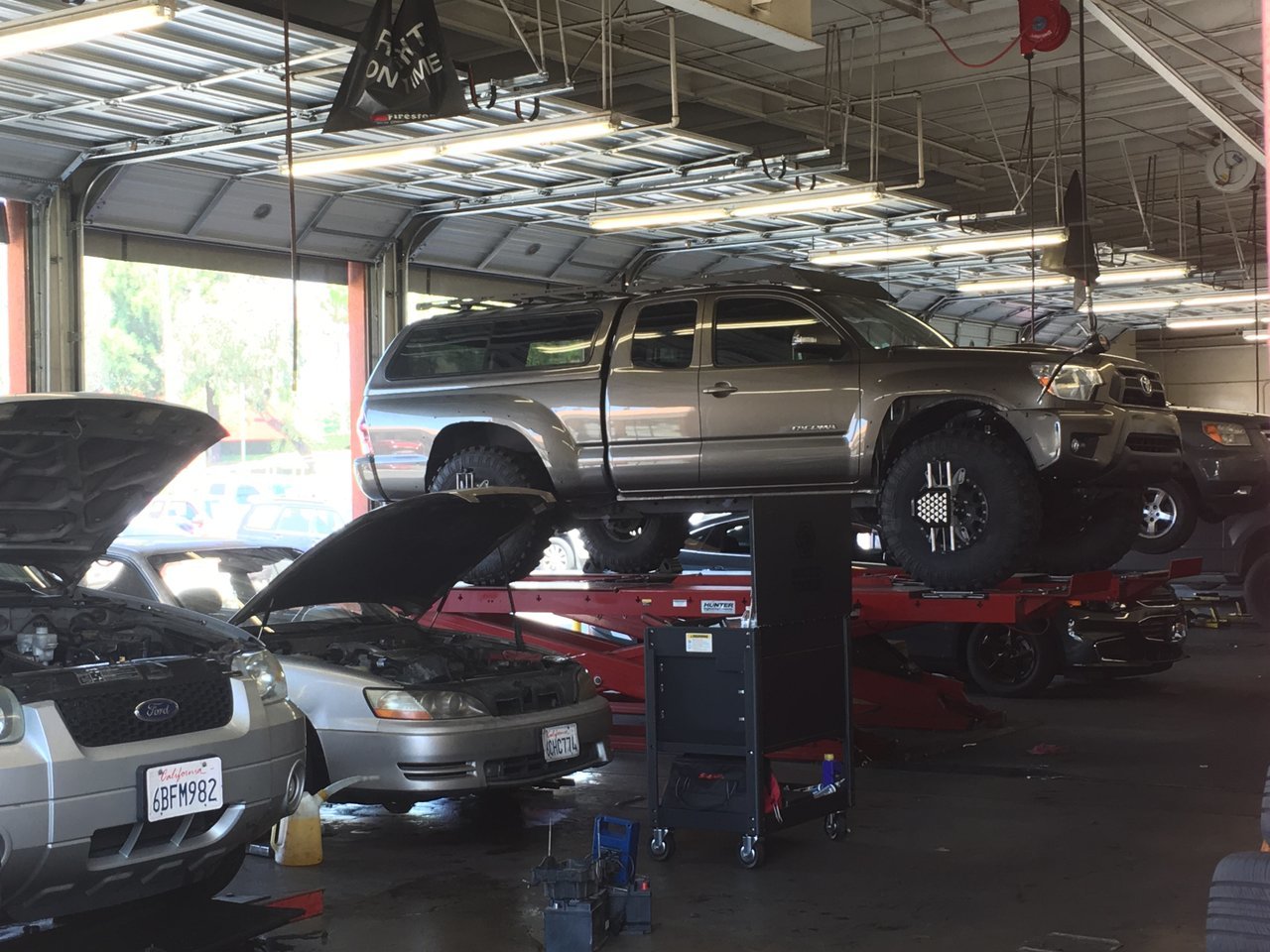

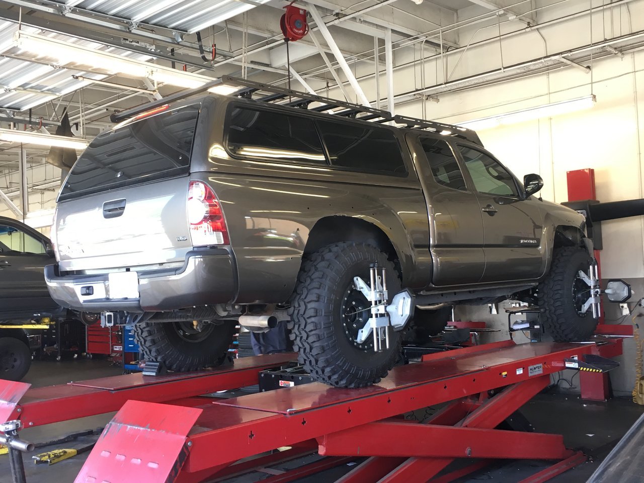

    Off to get her feet straightened. Also had them push the caster as far foward to clear the firewall. They were able to get over 5* of caster both side and camber within spec.

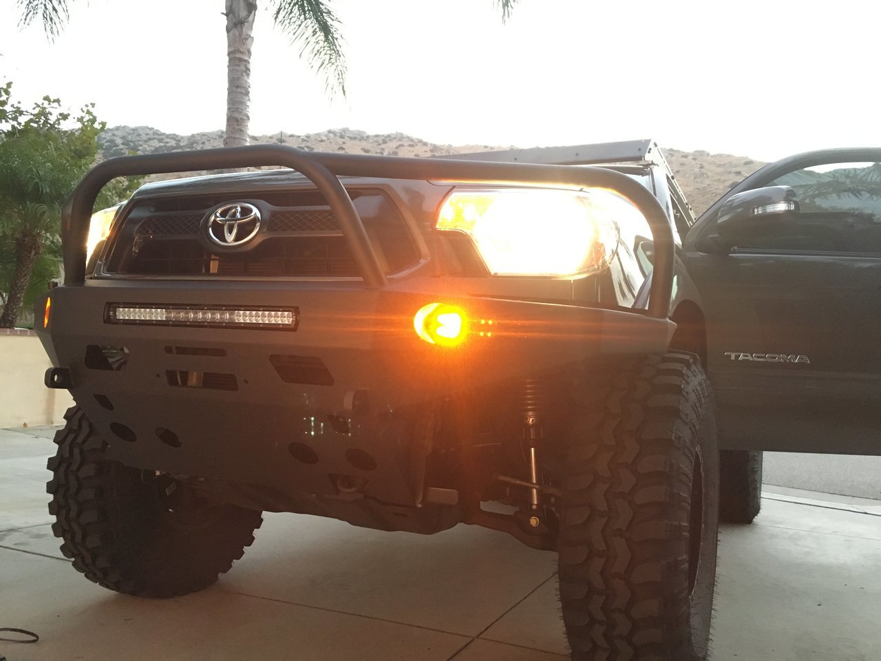

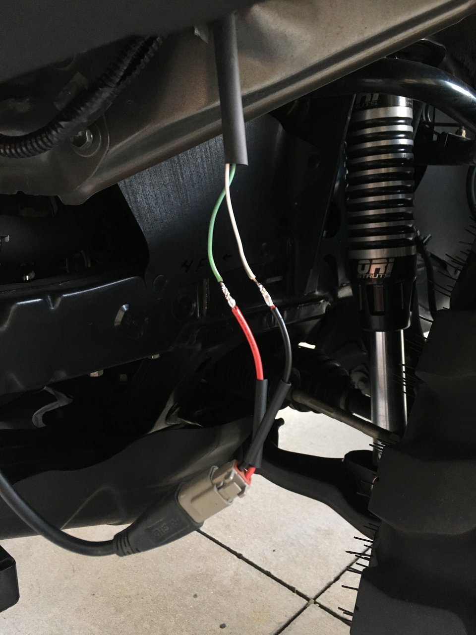

    Shortly after I got the front bumper back on the wires up the fog lights to factory wiring and switch. Did fog light anytime mod again.
