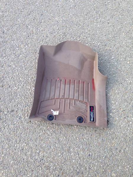

    Floor liners still doing their job

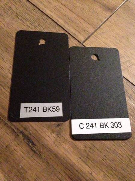

    Went to a few places to get prices for powdercoating armor when it all comes in. Prices ranged from ridiculously high to reasonable to good deal. I'm looking to go with a textured matte black similar to these samples

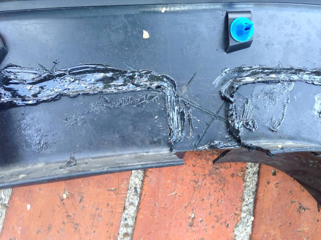

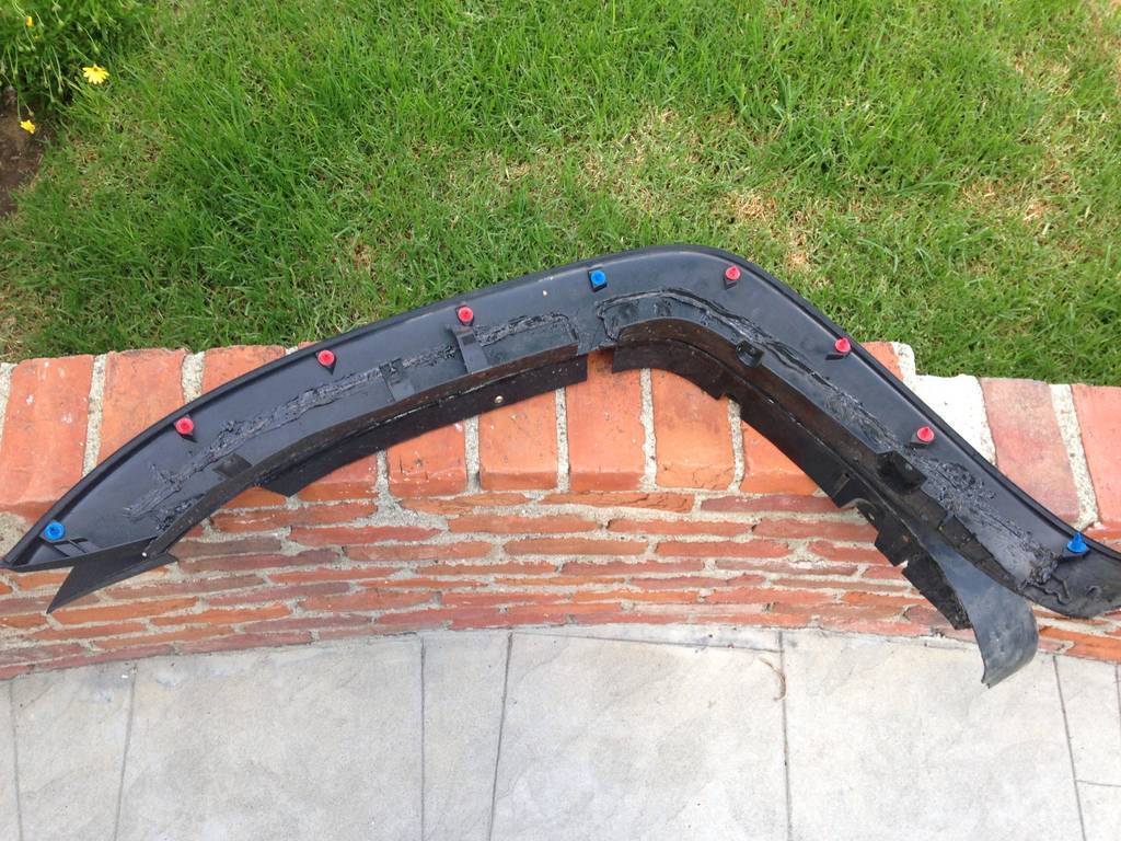

    Getting some tracing done to cut the rear flares. Using factory ones to trace the contours and corners to ensure the cut pieces mate up when I try and stick them back together.
    A few days later I went out and cut one side. Dremmel was used to cut flare.

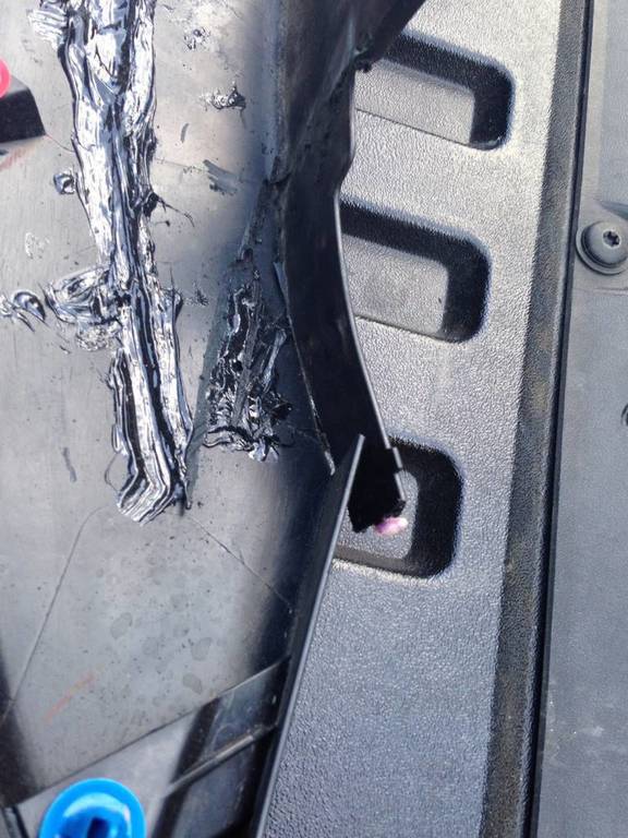

    Here are more photos of the fronts.
    How the cut pieces overlap and are glued together.
    I mentioned earlier how I did one side of the front. You can see where the flap was cut (on the left side) then folded over to fill the gap. It will be shaped to fit at a later time.

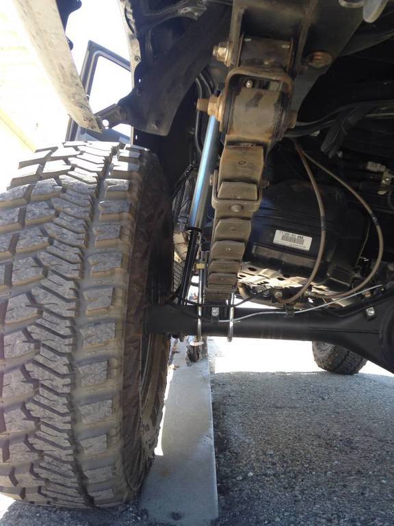

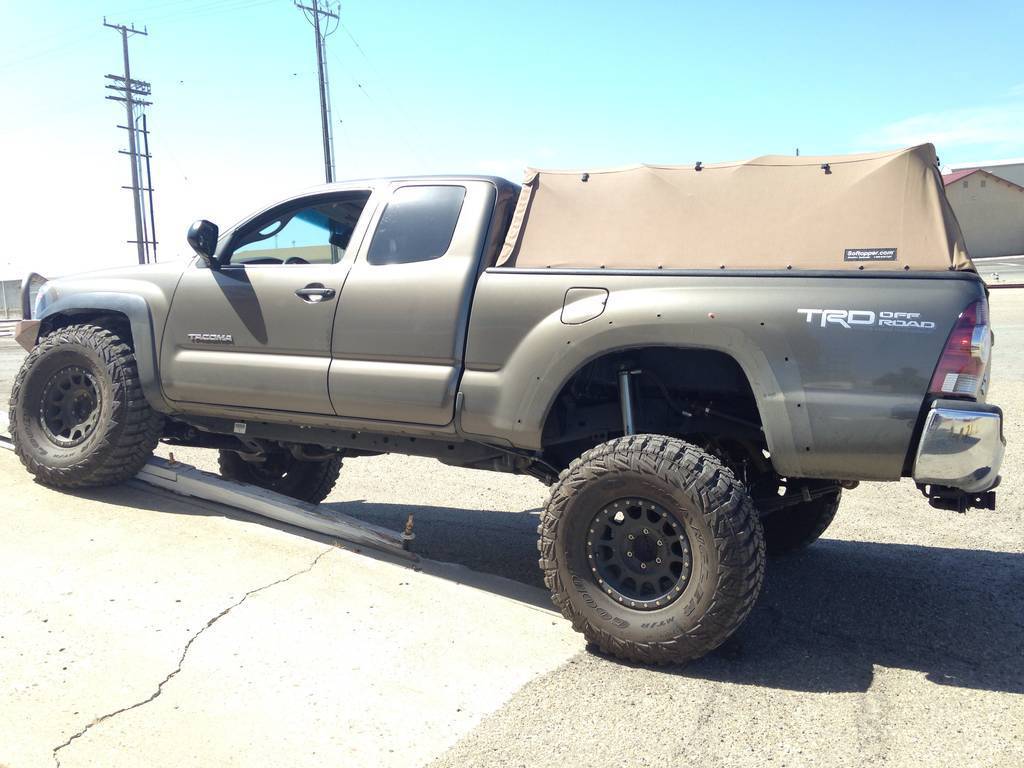

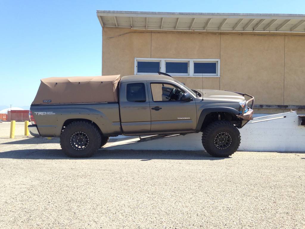

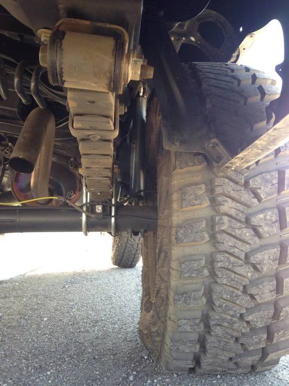

    So I have the clearance issue with rear tires rubbing the shock bodies. I found some loading docks at work and flexed out a bit to try and figure out what size spacer I'd need to run based on clearence.
    There was more drop left but it was rubbing pretty bad so I didn't go any further.
    My options are either get a 3/4" hubcentric spacer and grind down wheel studs to fit or put longer wheel studs with a sandwich type spacer. I ordered a few things from Wheelers off-road and got a set of the cheap 1/4" spacers they offer to see what that puts me at. I'm trying to avoid making the rear any wider than it needs to be so I'm not so willing to get the bolt on spacers. I know it's only slightly wider but it wouldn't look right to me since I don't like when the wheels stick out too much past the flares/body. The parts should be in soon so I'll see how things turn out.

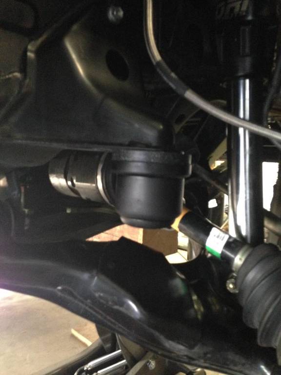

    A few small things came in that I went a head and put on.

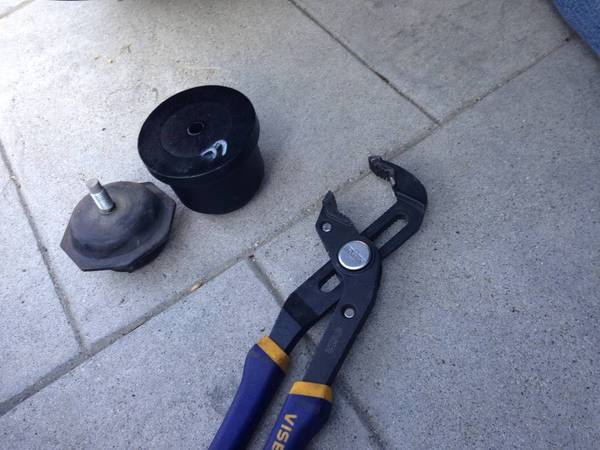

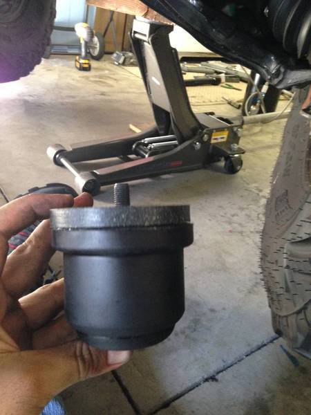

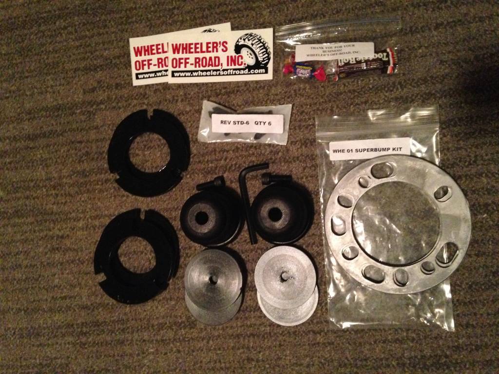

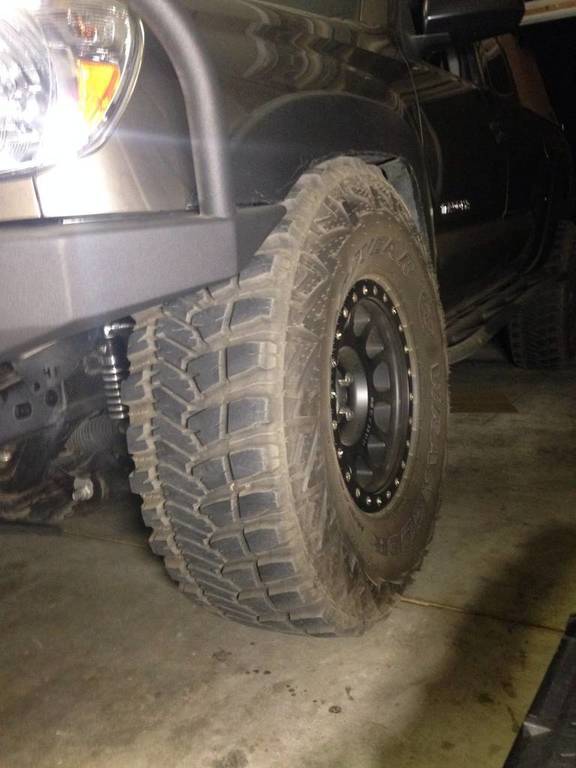

    Wheeler's Offroad Super Bumps with spacers and 1/4" wheel spacers for the rear

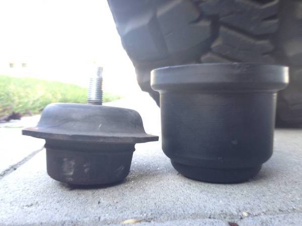

    Stock vs Super Bump
    With Super Bump spacer
    Since the Super Bumps compress much more than the stock bumps I put a 3/8 spacer after trying them without. The tire rubbed pretty crazy on the top of the wheel well with 35's. More than I felt like beating with a hammer at the time.
    Fully Compressed

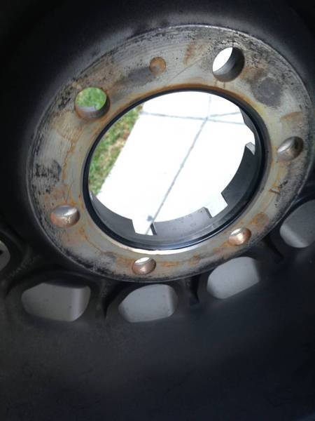

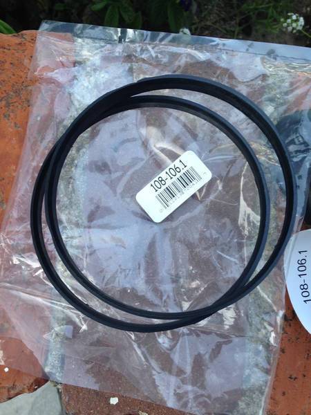

    Hub Rings from Amazon for a few bucks. 106 to 108. They helped with some low speed vibrations I was having.

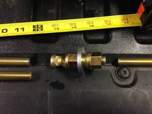

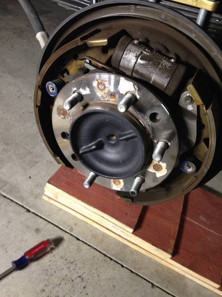

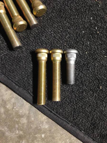

    ARP Wheels Studs from a Lexus IS300 Part# 100-7715 for the rear. After seeing a few members post about wheels sheering off at the studs I decided to go for it. Also, I am not comfortable with the amount of thread engagement my lug nuts have with the 1/4" spacers.

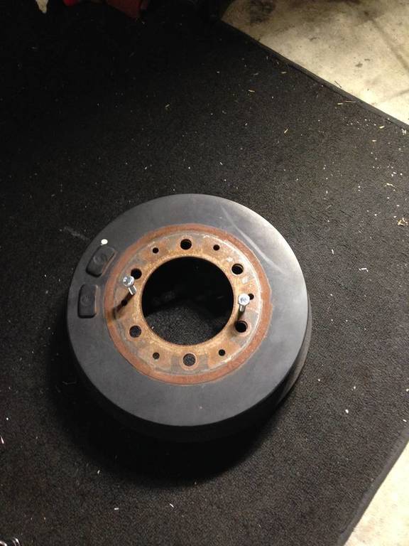

    Removed rear drum to test fit stud
    Banged out one stud with hammer. ARP stud was too long to fit in. It'll need to be trimmed to fit.

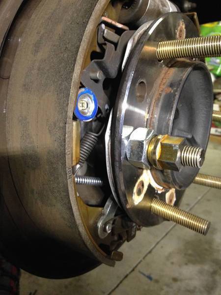

    I used one stud to see how much needed to be trimmed to be able fit through the drum brake backing plate. Took off a little at a time till it fit. Once it fit, I went ahead and trimmed the rest the same length.
    I didn't want to damage the integrity of the stud by over heating it while cutting so I took it really slow. I would trim a little bit at a time only till it was warm to the touch then let it cool. Used my lug nuts and washers to desired length then trimmed off excess.
    Regular, trimmed, OEM
    Used large nut and lug nut to pull studs back through

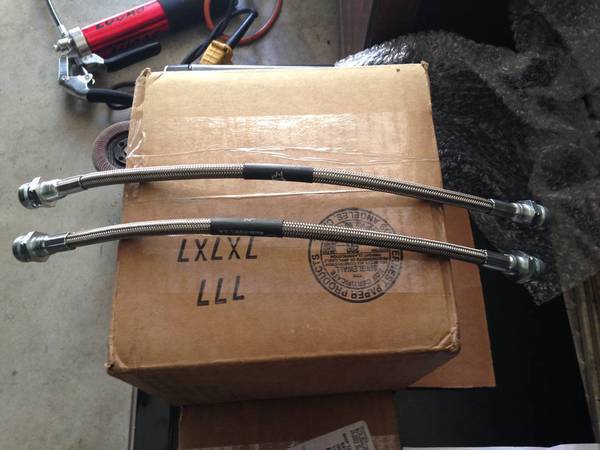

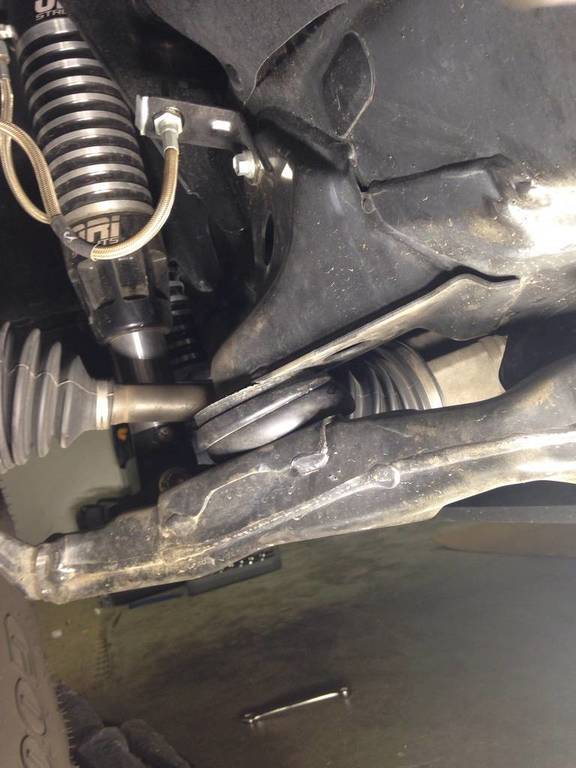

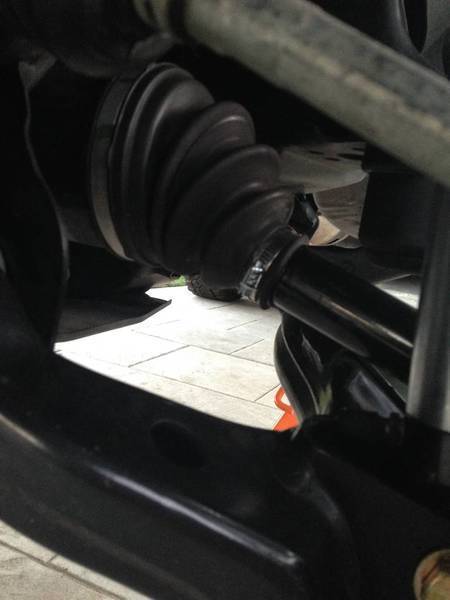

    The front got some extended brake lines from All-Pro
    Boot slide with hose clamp to prevent boot fins from rubbing

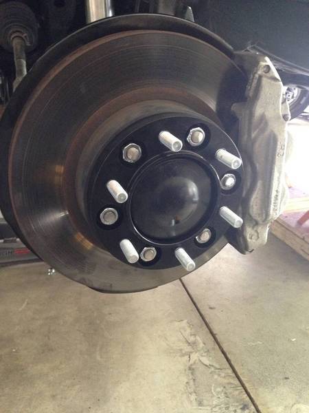

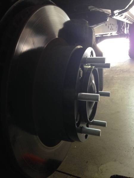

    Bora 3/4" hubcentric spacers made with 106mm to 108mm for my wheels. Had to trim a little bit of OEM wheel studs to fit since they protruded past the spacer. Some wheels have a recessed portion to clear the studs but didn't so trimming it was. Bora wheel studs are longer as well.

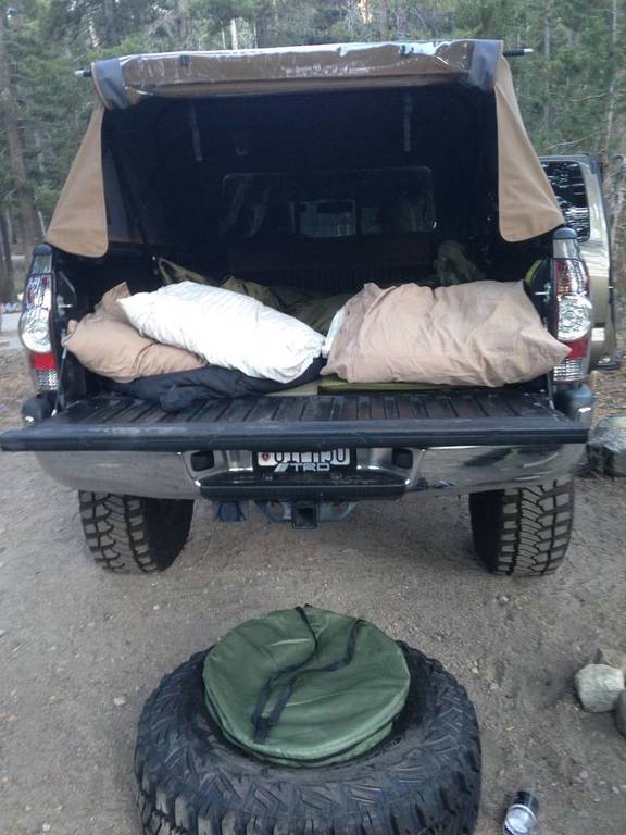

    Over a few days I decided to wash, clay bar, then wax the truck. It definitely needed it. There was so much crap embedded in the paint front not washing it for a long time, lots of dirt roads and the worst was from all the metal grinding I did to the truck. The metal shavings and sparks were burned into the paint and turning an orange rust color. It was a lot of work but it turned out looking really good.

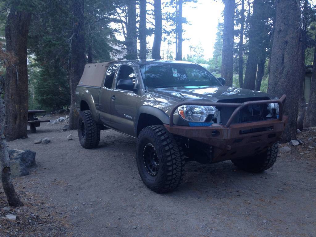

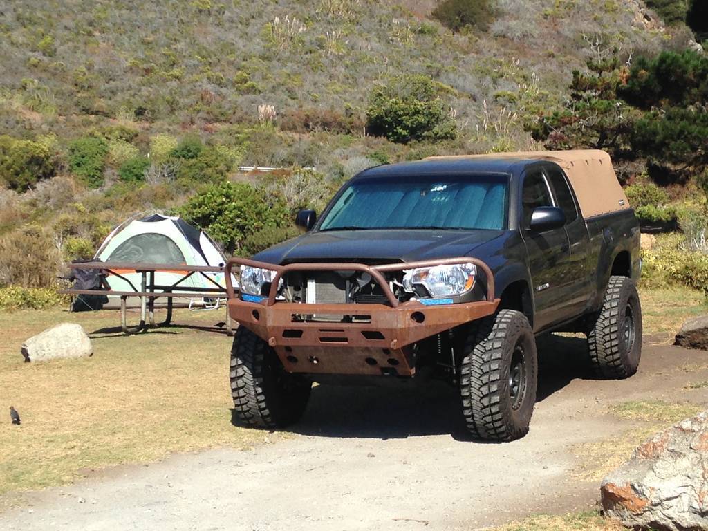

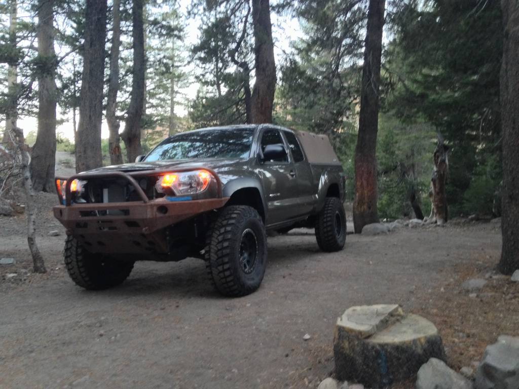

    That's about when I took a few camping trips. One to Mammoth Ca. on one week, then came back for a few days to rest and refit. Next week was to Big Sur Ca. Both places were amazing!
    Mammoth
    Sorry for the crappy photos
    Slept inside the Softopper.

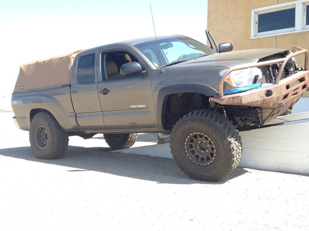

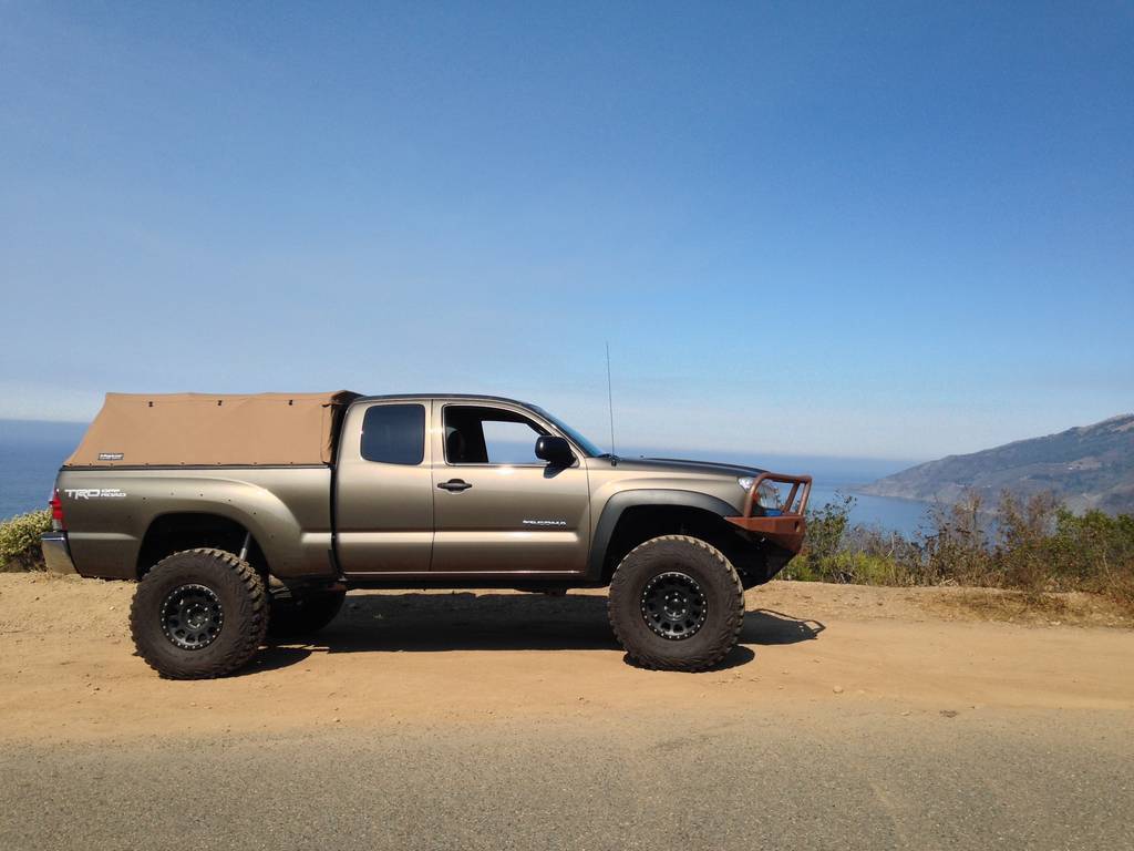

    Pulled off the road to take some nice photos on the way out on the last day.
    I'll post up some pictures from the Big Sur trip later.

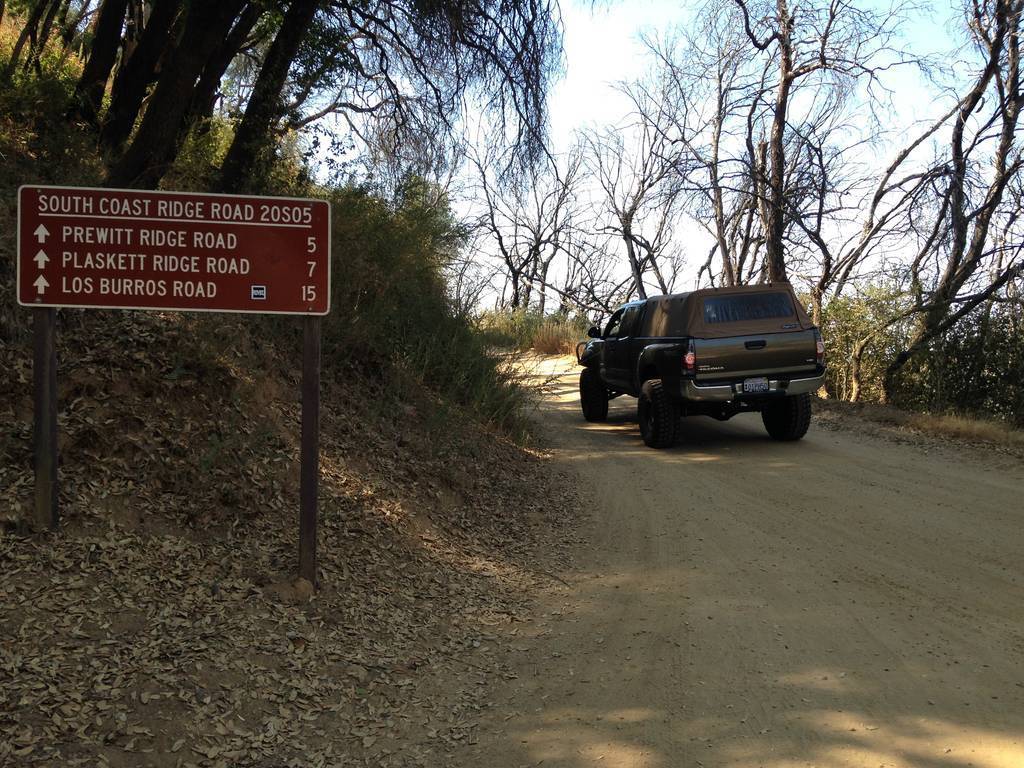

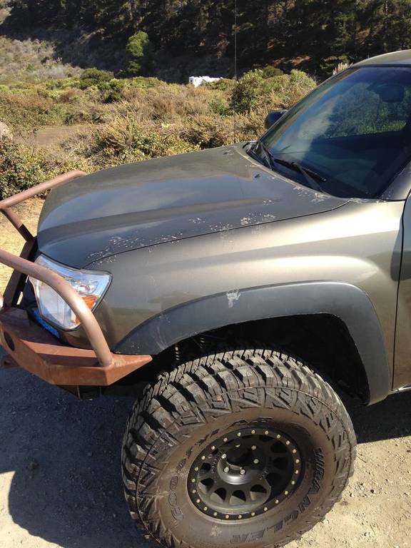

    A few from the Big Sur trip[​IMG]
    Saw a bunch of paw prints on my truck one morning. Coons payed me a visit over night trying to steal some chow. They have the softest hands.
    When exploring on South Coast Ridge Road. There are tons of trails up there that lead to more camp sites(primitive) and amazing views.
    quick adjustment of the ORI's :mudding:
    Overall it was a great time spent in Big Sur. Our camp ground was Kirk Creek. Lots of things to do, hiking, kayak, sightsee, beach, mountains and much more. I'll for sure being going back but maybe camp up in the mountains.
