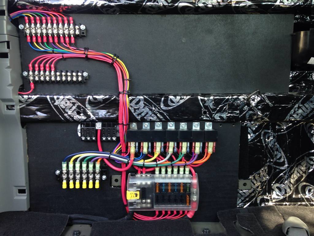

    Small update on the dual battery wiring. Got it mostly done. All the ground work is in. It'll serve as the backbone of the system. Just need to run the accessories to their respective terminal blocks and done.

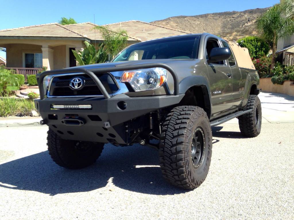

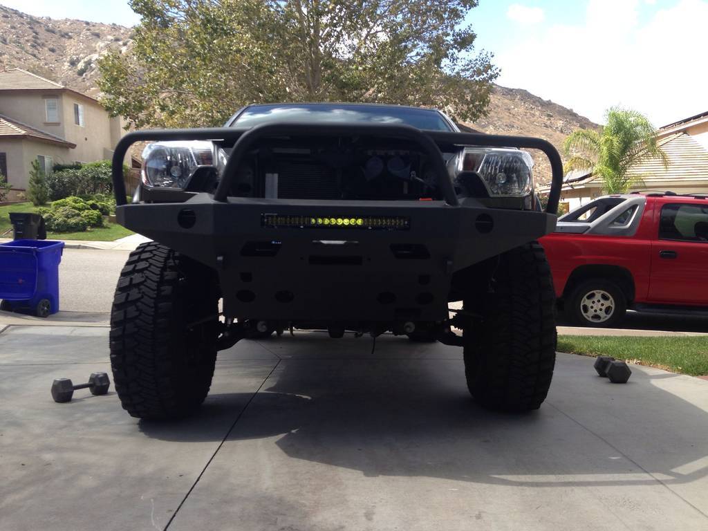

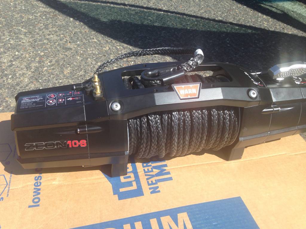

    Next was putting the front bumper back on after the powder coat with the winch and light bar. I removed these black plastic pieces to give the bumper more wiggle room. Don't know what they do, maybe just help index the factory bumper :notsure:
    Rigid Industries SR2 20 with Hyperspot mounted

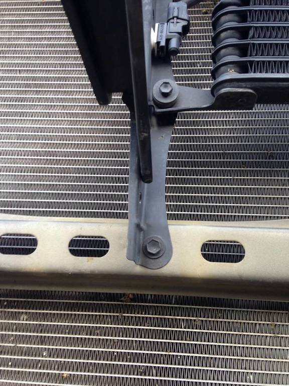

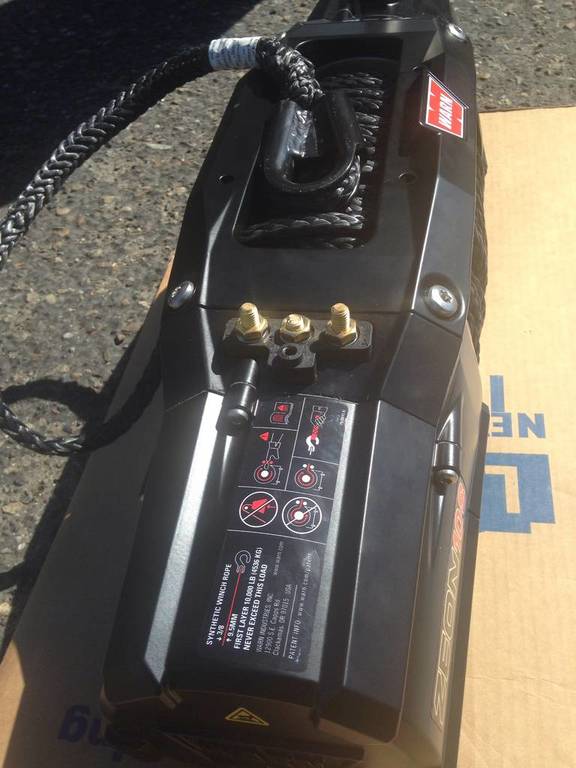

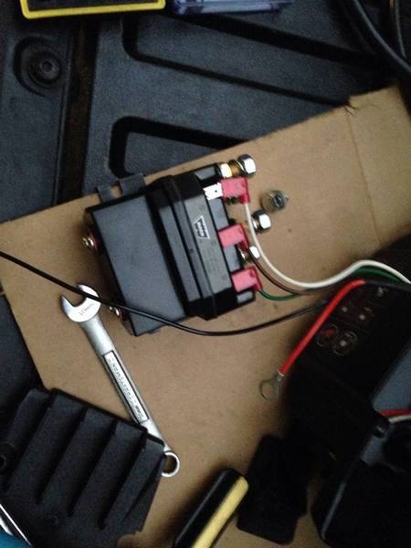

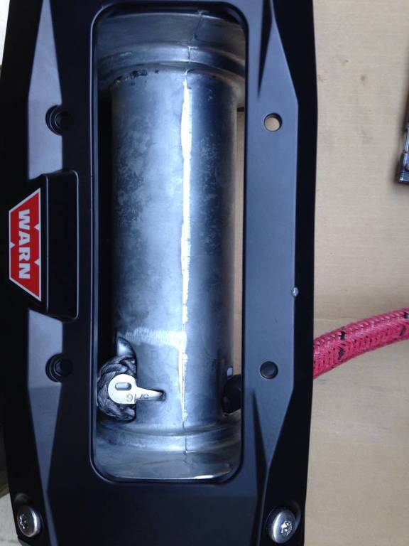

    I went with a Warn Zeon 10-S. I got the 78" Zeon control pack relocation kit to more the contactor into the engine bay. With the control pack removed, there was minimal clearance issues. The winch just touched the center grill support. You can see on the right the rub mark.
    Then here on the support
    This is the contactor to be relocated. You have the option of relocating the entire top module or gutting it and just mounting this piece. I figured it'd be easier to mount and relocate this than the huge encased piece.
    Unfortunately there was a snafu. One of the motor studs broke up while installing :eek:. Followed the instructions and used an IN/LBS torque wrench. installed one nut good then the second one kept spinning, and spinning then snap, off it came :mad:. They are brass so care should be taken not to over tighten.
    The crappy part is I tried to see if Warn would just send me that bolt stud to replace but turns out they entire left motor assembly had to be replaced!! Brand new, never used and already have to do a warranty claim. Warn referred me to their authorized SoCal repair location, Tri County Gear. They were able to get it taken care of. Shitty part is I was headed out of town for work and there were some nice trails where I was going and wanted the winch just in case.

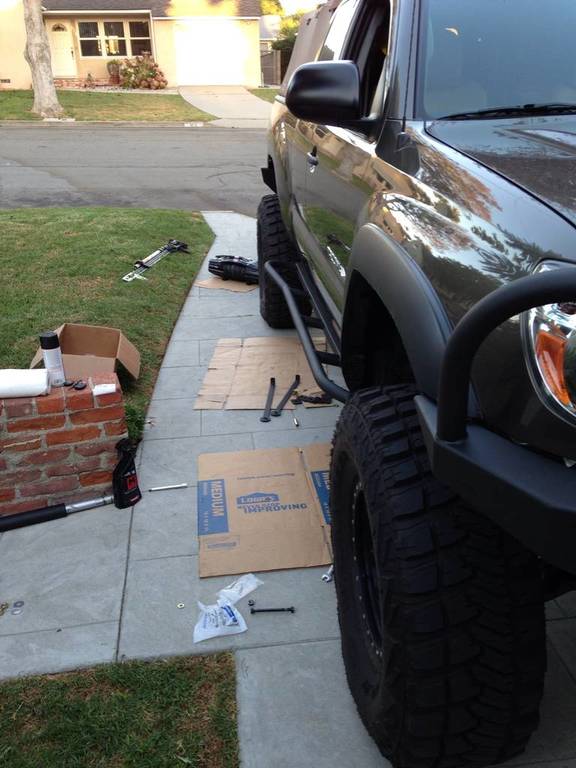

    Next was time to install the Relentless Fabrication Bolt on sliders.
    OCD kicking in

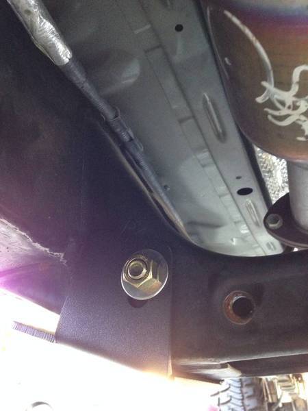

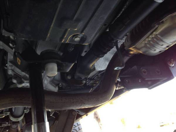

    I was confused as hell trying to get these things in. The only thing I could think of was to jack up the tranny/transfer case and remove the cross member
    That was the only way I could think of to get the bolts in and held in place for the cross member bolts. If someone has a better option without having to remove the cross member, please let me know. It's these on the inside

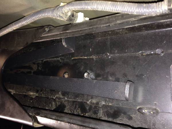

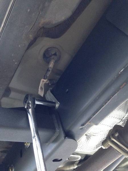

    They hold in this piece that the slider will bolt to.
    This bracket on the passenger side frame was in the way so it'll need to be removed then reinstalled later.

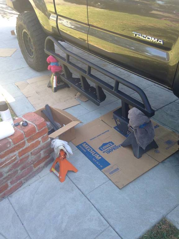

    One side done!

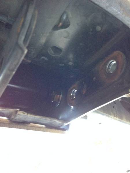

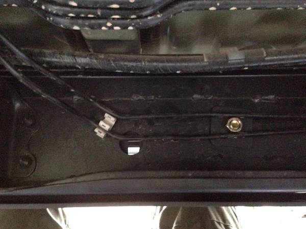

    The driver side requires you to move a few things around, like brake and fuel lines, to clear the bolts. I just unclipped them and set them aside. I will put some rubber fuel hose around the hard lines to protect them from rubbing and damaging the lines. Crappy photo.

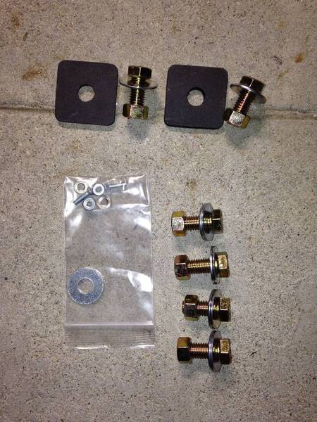

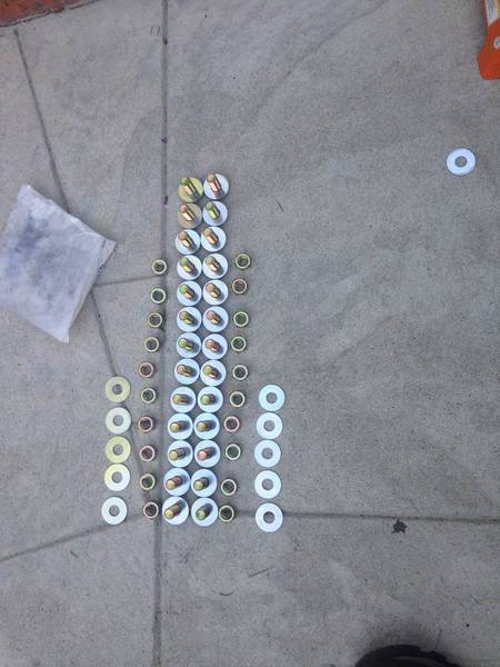

    I forgot to take photos of these before install(you can see them on the ground two photos up). They are extensions with nuts welded to them on the ends. They allow you to get the nuts deep into the boxed part of the frame and hold them in place while running the bolts through them. Saves the headache of reaching in with a wrench or whatever. A nice touch for sure.
    This is what was left after the install. I can't remember what they were all for but I know the 4 on the right were if you wanted extra bolts on the bottom of the frame coming up. Two on each side. You'd need to drill a 1/2" hole to put them in. They will go in eventually.
    The truck looked funny with the front and rear bumpers on and no sliders. Seemed long and skinny so now it looks much better.
    Sidenote: I need to learn how to take good photos.
    After getting home the rear flares were put on to be cut
    Looking better
    I did a quick test with the Hi-Lift on the sliders and there was very minimal deflection. As mentioned though, I'll eventually put in those extra bolts.
