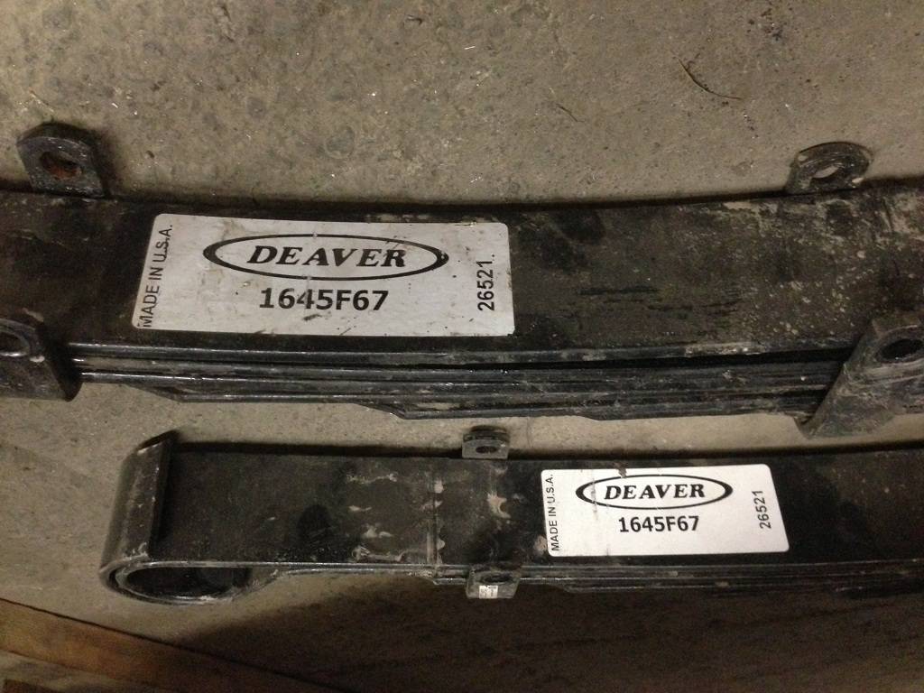

    The leafs have a F67 sticker on them, and they measure 62" eye to eye.

    are we 100% sure they're F67's? i've heard in the past of giant sending people F55 packs.
    post a pic of the stickers on the leafs.

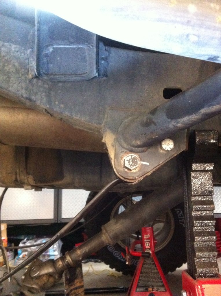

    Wait a second...I just had a rather unusual epiphany.
    Don't take this the wrong way, I'm just trying to rule everything out. When you're cycling the suspension with just the main leaf, the sticker side of the leafs are towards the front of the truck right? Can't tell from the pix.

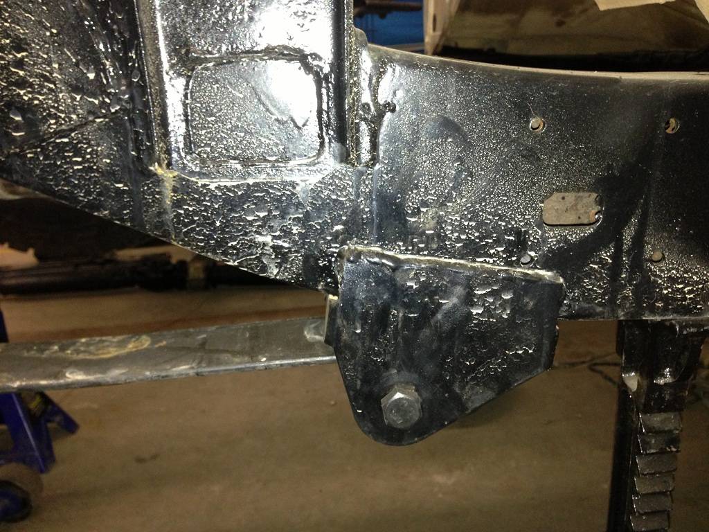

    ^^No, I was looking at that too, the first pic is def a rear eye, the 2nd pic is the front eye. The fronts go in "level" with the top and the rears go in the middle of the eye

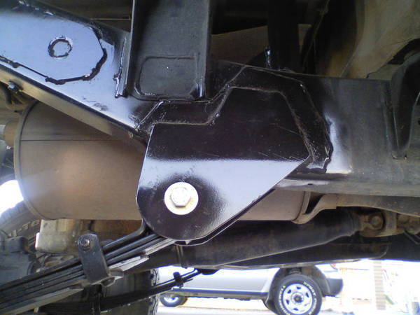

    8D6EBB37-21D1-412E-9AB4-8E420CE2BC10-155_fe7c270d99fe1974917383fb546c1b902bde8cf7.jpg

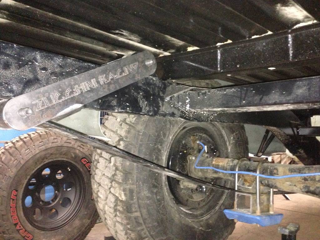

    Not yet lol, I still think something is up with those leafs, your front mounts are farther forward than mine are and your axle is still pushed back
    No, here is mine VS his

    Wow, wtf. We are all 3 pretty different
