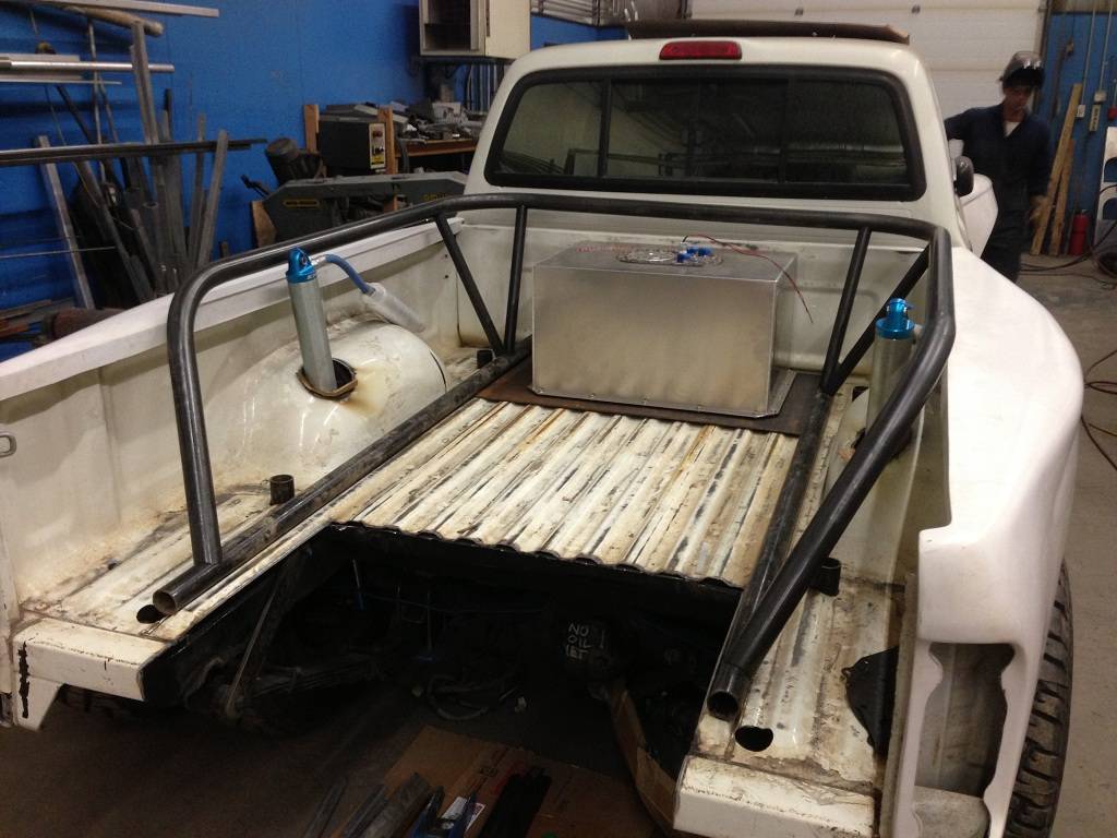

  13. Nov 8, 2012 at 6:41 PM
    #253
    Conman117
    Conman117 [OP] AWESOME MEMBER
    Mar 10, 2012
    #74659
    1,496
    Nathan
    BC, Canada
    98 Brap-coma
    Blue LED dash lights
    Mocking up stuff. Don't worry about it being crooked, it'll get fixed.
    The top piece was tough to bend. All one piece.

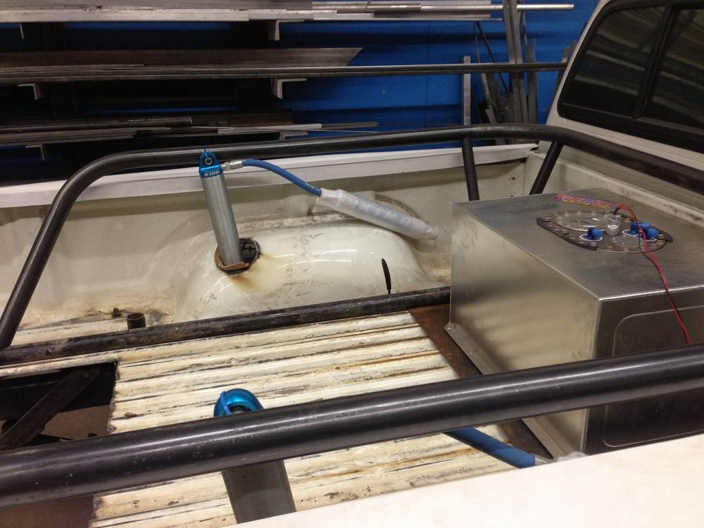

  14. Nov 8, 2012 at 6:43 PM
    #254
    Jacob78
    Jacob78 Well-Known Member
    Nov 6, 2012
    #90619
    58
    Jacob
    San Diego, CA
    2013 tacoma d-cab prerunner
    Looks good. Doing dual stand up spares? What are you going to do for a shock mount?
  15. Nov 8, 2012 at 6:45 PM
    #255
    Conman117
    Mar 10, 2012
    #74659
    1,496
    Nathan
    BC, Canada
    98 Brap-coma
    Yep, duals just like everyone else and their dog.
    And I'm not sure what I'm doing for mounts yet, but the shock will sit off the pipe because I didn't want to bolt right onto the pipe.
  16. Nov 8, 2012 at 6:50 PM
    #256
    Jacob78
    Nov 6, 2012
    #90619
    58
    Jacob
    San Diego, CA
    Yeah definitely don't do single shear. Learned my lesson with that haha.
    Would be pretty simple to just add another tube that wraps around the shock.
  17. Nov 8, 2012 at 8:02 PM
    #257
    Joels98taco
    Joels98taco Well-Known Member
    Mar 10, 2011
    #52782
    2,220
    joel
    chino hills
    98 5 lug tacoma
    fabtech 3" spindles, icon aal, 10" bilstein 7100 rear shocks, daystar coil spacers, AFE Pro Dry-s drop in filter, sony head unit, 2 12" pioneer subs, pioneer 6.5s all around, custom 1.25 lift shackles, custom lower ball joint brackets fabbed by me
    what size bolts are going though your mis spacers?
  18. Nov 8, 2012 at 8:25 PM
    #258
    Conman117
    Mar 10, 2012
    #74659
    1,496
    Nathan
    BC, Canada
    98 Brap-coma
    Yeah thats kinda what I'm planning.
    Thats a great question. I will say 1/2" for now:p maybe someone else will say, or I'll check tomorrow.
