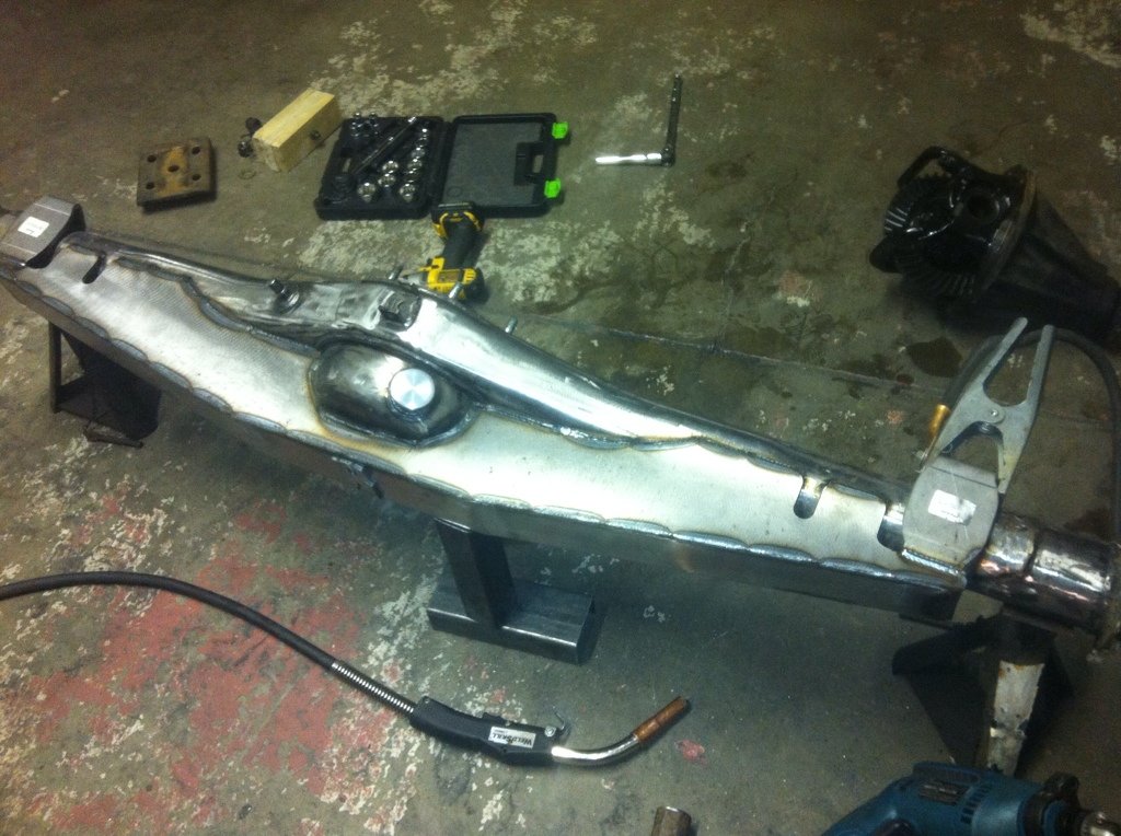

    you drill the the bedcage tubes and set the bungs in there. hang on

    I see, good idea. Maybe I'll make some, ordering stuff takes to long

    yeah i think you just need some 1" .25 wall tube but id double check and make sure the bolt is snug

    Yeah just push a 1" .50 piece of chromo through the hole you drill in the tubing and weld it. Just make damn sure both side line up or youll have a hell of a time getting a bolt in. lol

    yes use a bolt with washers or another piece of the same material as a spacer and tighten it :) dont waste the money on chromo if theres DOM available

    ^^and it is 1" .25 not .50. 1"- .25 and .25 =1/2 hole ;)

    Thanks dude, maybe weld it with a bolt in them already? That way it should line up easily

    yes depending on the mounting width of your shocks (not sure if yours are 1.25 or 1.5 width) stack up washers or a piece of the same 1" .25 as a spacer and center it and weld them up

    I had to go back to work, and I ran out gas for my welder. But some stuff is getting done. Put in my new marlin crawler clutch. Its a little heavier than stock, so we'll see how it goes.
