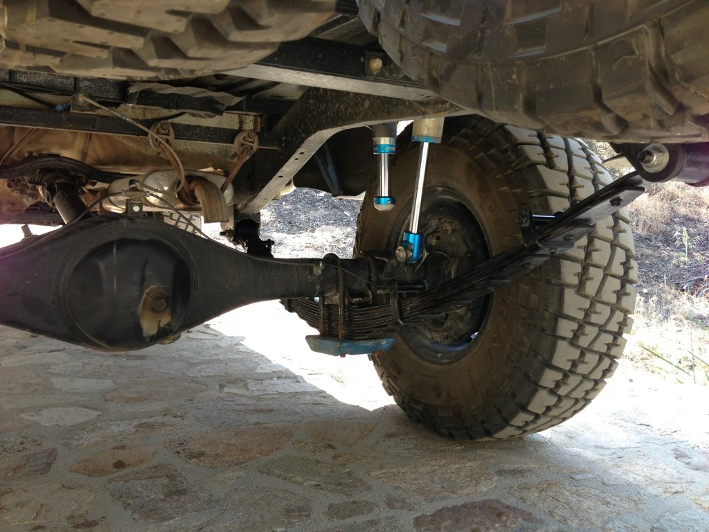

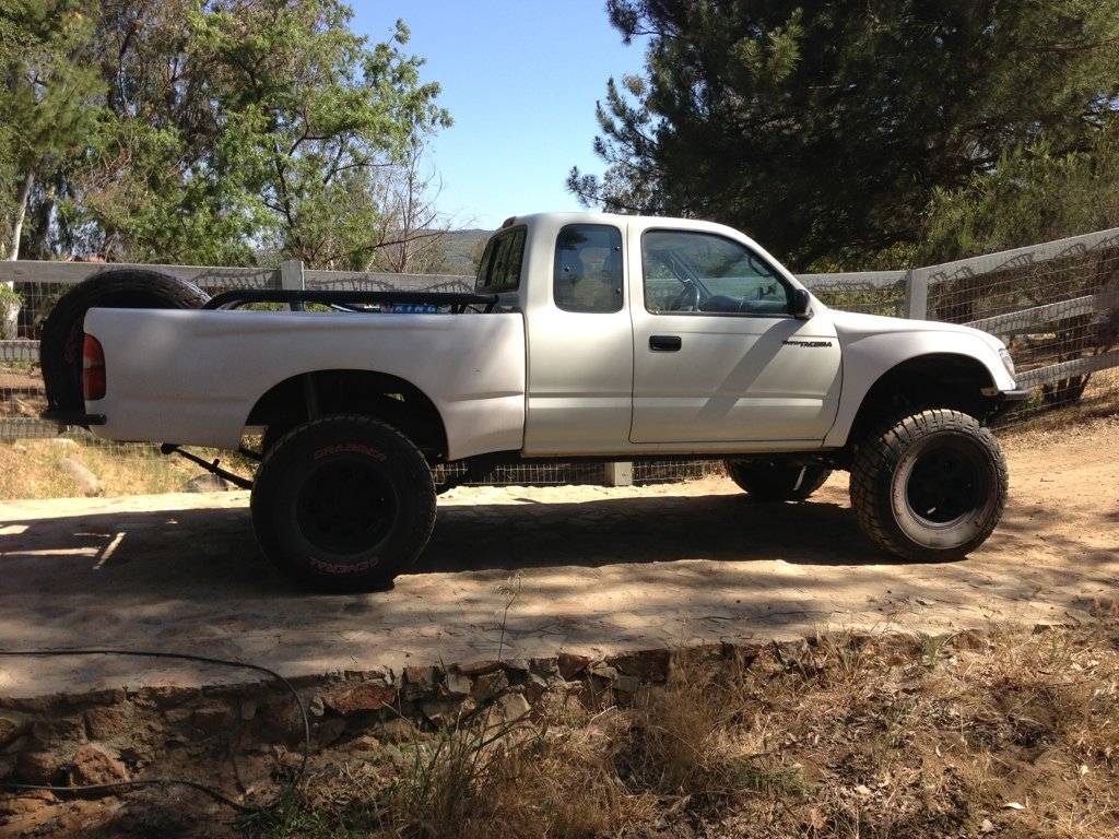

    Well it sits a lot better now. Level at least, maybe a little higher than the front.
    C0EBC6F6-CAF0-4CBB-8142-E16D9900D6A9-642_eee97be68b45188209e3b5b39183c57fcfc06a4d.jpg
    around 8" up travel
    A3EA479D-29AE-4A11-91CF-9D6667EFE16B-642_2d29337a17cbb4bf3eda764179e2d8a3537185fe.jpg

    They will settle about 1-1.5" after about a month and a good workout.
    If it ends up being too stiff and tall for you, try pulling the 6th leaf from the bottom and optionally the bottom two.

    Cool. I'll see how it goes, I may end up putting more stuff in the back anyway, so it might be ok. Thanks for the tip!

    Yeah that was my conundrum too. As soon as I put the two 5 gallon jerry cans full of gas, the ride and height ended up being exactly what I was looking for.
    I just keep the gas cans full all the time...good for emergencies (aka i'm a dipshit and forgot to fill up) too.
