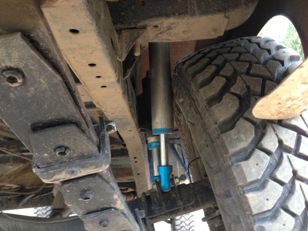

    Ok, rear shock talk. Since I always know exactly what I'm doing, my tires hit my rear shocks when I'm flexed out. So I flexed it out with no shocks and it looks like I have around 4" between tire and frame.
    Should I try to squeeze my 2.5 shock in there, or notch my frame?
    Having 3/4" on either side of the shock doesnt seem like enough to me.

    EDIT: and thats not with the bumpstop compressed either, so the gap might be a tad smaller on big rocks or rough landings

    Notch your frame! 05tacorunner did his, no clearance issues at all

    What axle? What wheel offset? Was the other side close to full droop?
  8. Oct 4, 2013 at 9:02 PM
    #728
    Conman117
    Conman117 [OP] AWESOME MEMBER
    Mar 10, 2012
    #74659
    1,496
    Nathan
    BC, Canada
    98 Brap-coma
    Blue LED dash lights
    Probably whats going to happen.
    Tundra axle, 4" BS on the wheels IIRC. Yeah the other side was pretty close to droop.

    Well they "should" clear, theres 4". Its just really tight. I might notch the frame just to gain some breathing space, in case theres any axle movement :notsure:

    From what im guessing (im by no means an expert) your shock is goin to be near the location of the red-line. I think you may need to move the shock mount closer to the frame and notch the frame for clearance. As it is right now the shock is really close to the tire at bump but has plenty of clearance on the frame side. (I assume it is the opposite when the suspension is drooped: clearance tire side, close frame side)

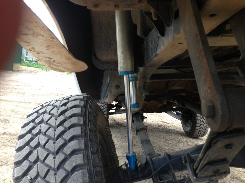

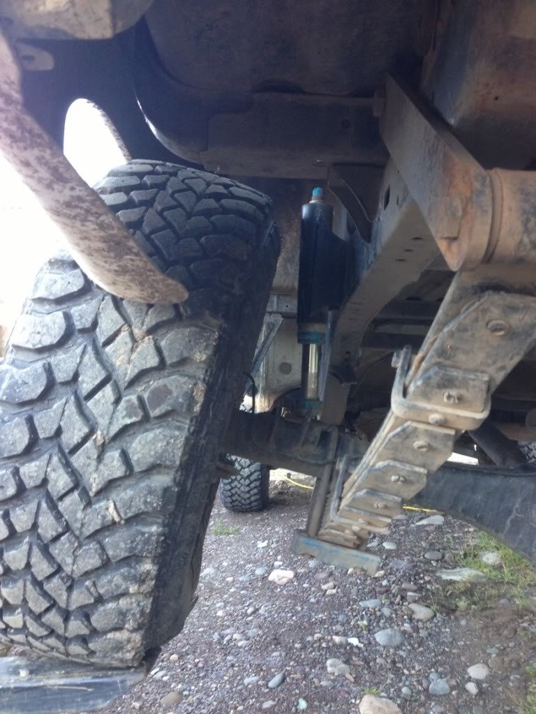

    Couple pics with shocks.
    Bumped
    Drooped
    Theres actually some room between the shock and the frame at droop, although its not "fully" drooped, its as drooped out as it will be with the other side tucked up.

    only real solution im seeing is to move the shock inward will it doesnt rub and notch the frame accordingly (if at all). The clearance can be tight because this is max articulation (assuming the bumps are compressed when everything clears and the other side is drooped out fully) i would say even 1/2 inch clearance at max articulation should be adequate (just my opinion)

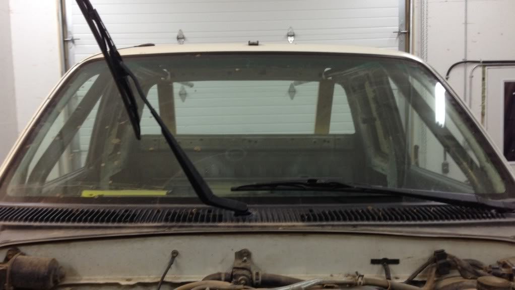

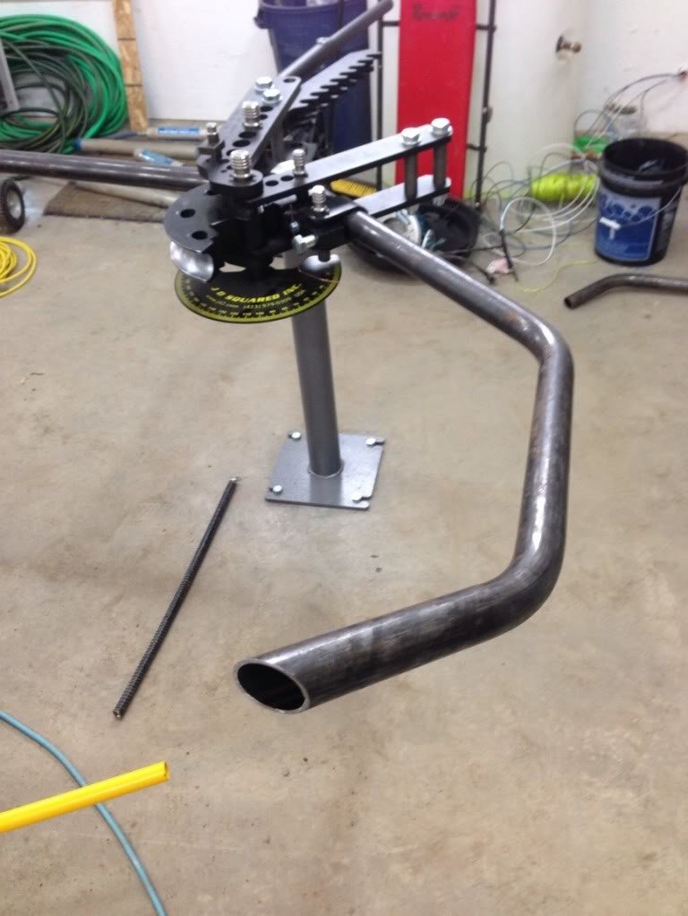

    Finally started bending tube.
    DF7227D7-83D5-4299-AFE9-C628D5FF1EF6-208_e513884183cc7a23fdaa8ef74e8f3137f31fe8eb.jpg
    Trying to get it pretty tight to keep as much head room as possible. As I'm pretty tall, I don't want to smash my head on tubes
    D6A35DAB-CDE3-4810-9600-E789D6D6002C-208_1380f8506312d8de8ed785b8001e9719b8d8c5bd.jpg
    It's really annoying me that the tubes on either side are not the same distance off the cab. In the bottom corners of the windshield, the passenger side one is in farther. I'll just live with it

    looks great so far! how do u like that jd bender? I'm thinking of picking up one of those
  19. Nov 3, 2013 at 10:06 PM
    #739
    Conman117
    Mar 10, 2012
    #74659
    1,496
    Nathan
    BC, Canada
    98 Brap-coma
    Thanks!
    Yeah its good, wish I got the hydro ram. but the bends are great, I can get consistent bends so I can't complain. A draw-through bender is a must for tubing
