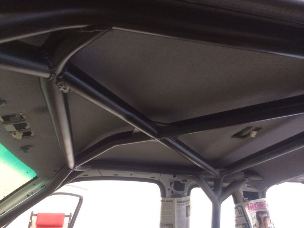

    Well, I should have known better.
    The front pillars of the cage pulled in when I welded the top. I think I can spread them back a bit. I thought about that happening before I welded but I didnt think it would do it too much. Word of warning to novice welders, stuff pulls way more than you think it will.
    But on the bright side, its back up.
    92730F01-10AB-4BA0-AF7D-1A08A65D9964-288_fa3fdf64d2d3389a1eca6c82e0ad6b2f978b5153.jpg
    Didnt really take into account the thickness of the ceiling piece so its pretty snug in some places. But thats not a bad thing

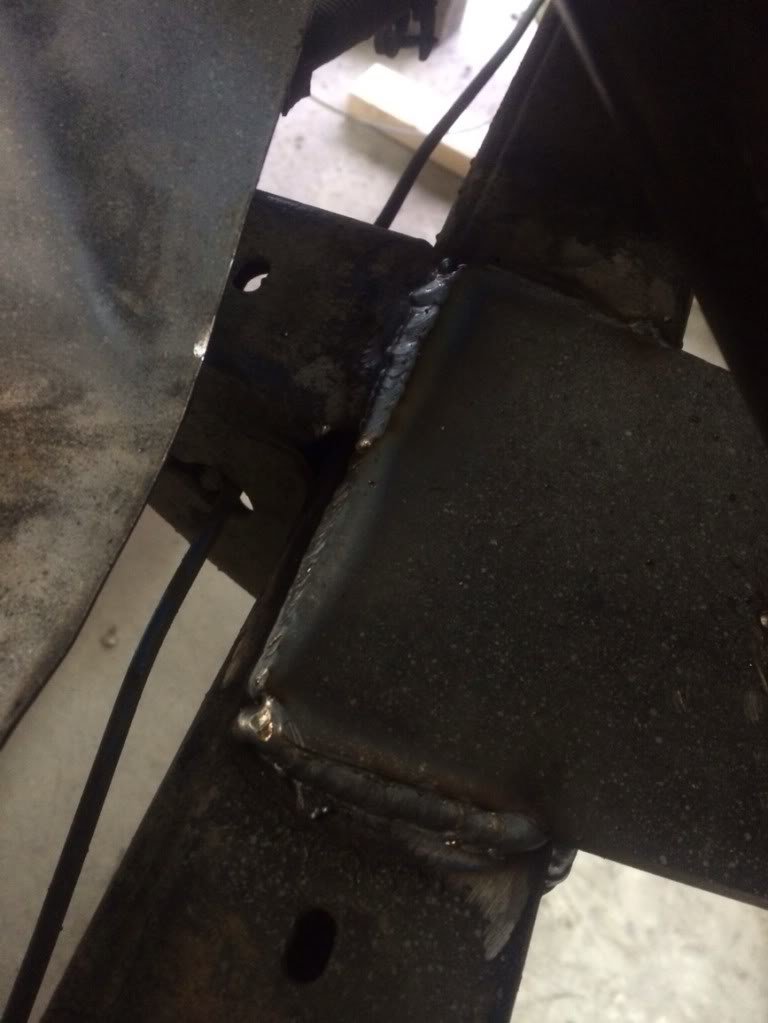

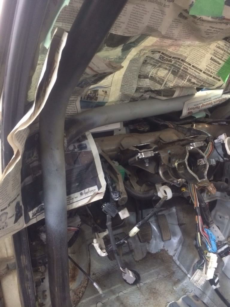

    Weekend report.
    Dash crossmember in
    5593ADF7-40EF-4167-B7E8-7F95308303FF-958_a688e1ce01af6e604ad9dab74493ee517e297f10.jpg

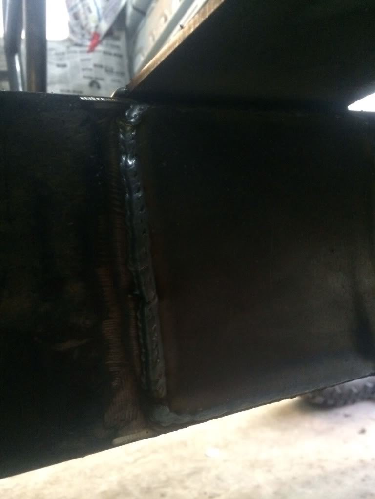

    Frame plates
    389B65F1-A35B-4775-B868-286D42691D2A-958_6d8968b4ca30d484ca238f2946d53db765e869b5.jpg
    CDE0E7AB-74AA-4E40-BF0C-76D96415C523-958_bf3fac3b86f94208204e57d904d6572c8650d394.jpg

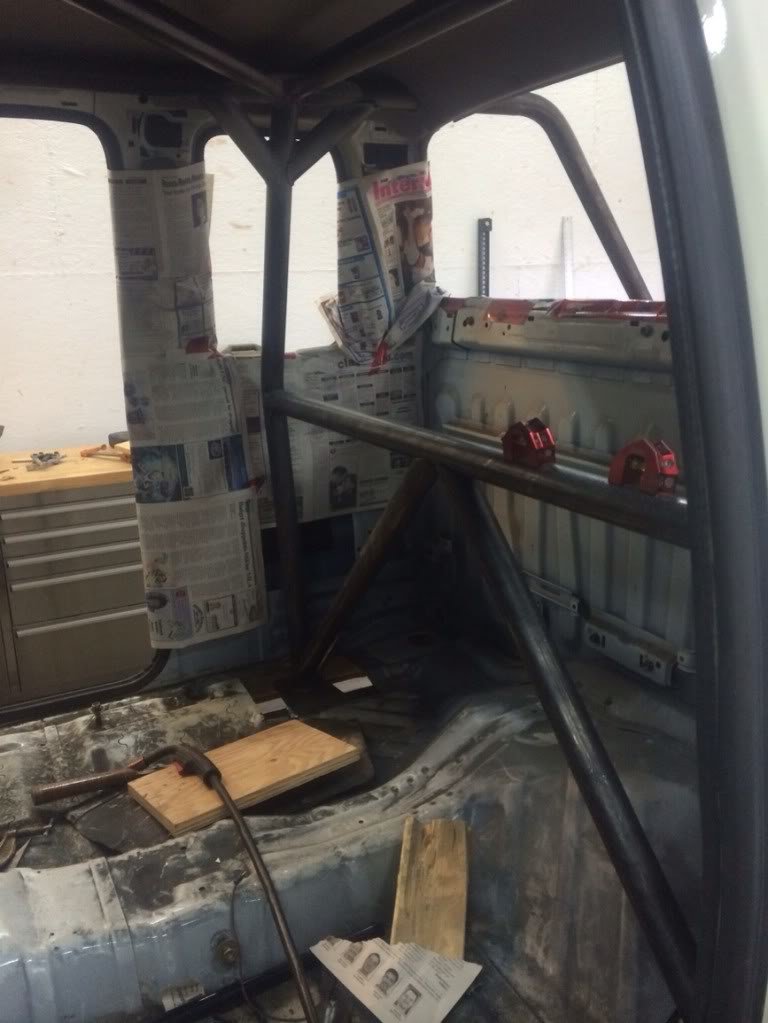

    More tube
    6221D0B2-3FC3-4C83-B8EA-98F25CA8DF7F-958_8517aabd0160109bd2d243721a632754d5e8f123.jpg

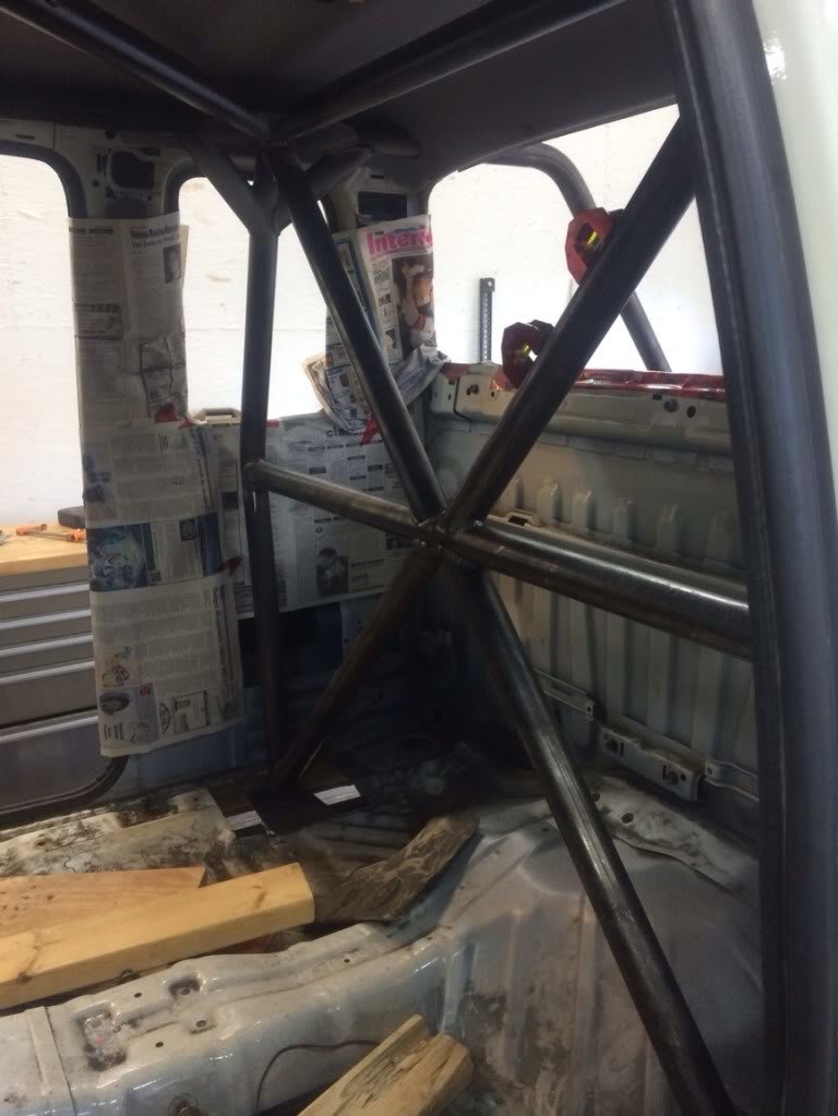

    Got the star thingy brace welded up

    gotta ask, why did you end the cage at the b pillar and not the c pillar?
    just seems like your losing alot of space by ending the cage there
  17. May 7, 2014 at 3:50 PM
    #797
    Conman117
    Conman117 [OP] AWESOME MEMBER
    Mar 10, 2012
    #74659
    1,496
    Nathan
    BC, Canada
    98 Brap-coma
    Blue LED dash lights
    Thanks!
    Theres no reason. I could have put it farther back but its there now so I'm not going to think about the pros and cons of where it sits.
    I could have only gone ~10 inches farther back, and I'm sticking my subs back there so its not a huge deal.
