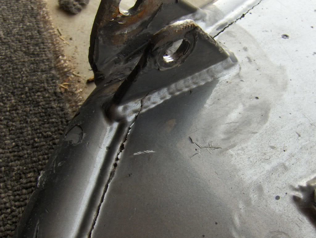

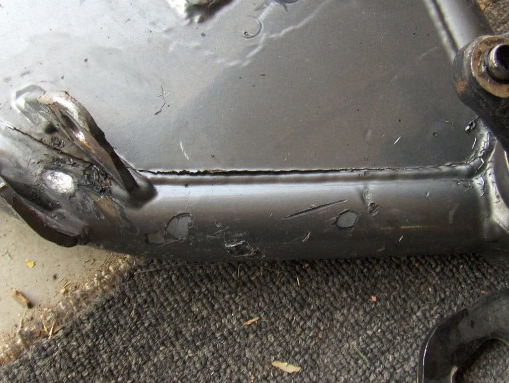

    i finally re-found the pics i was looking for...
    i know you were considering bumping a hyrdo bump off the LCA. do not do so with out a strike pad and proper interanl gusseting of the lower arm. otherwise bad things will happen

    ^ Mildly amused that they gusseted the shit out of the spindle and welded on a strike plate to the UCA bolt....and yet the bumped off the LCA. :rolleyes:

    it's the thought that counts, right? lol

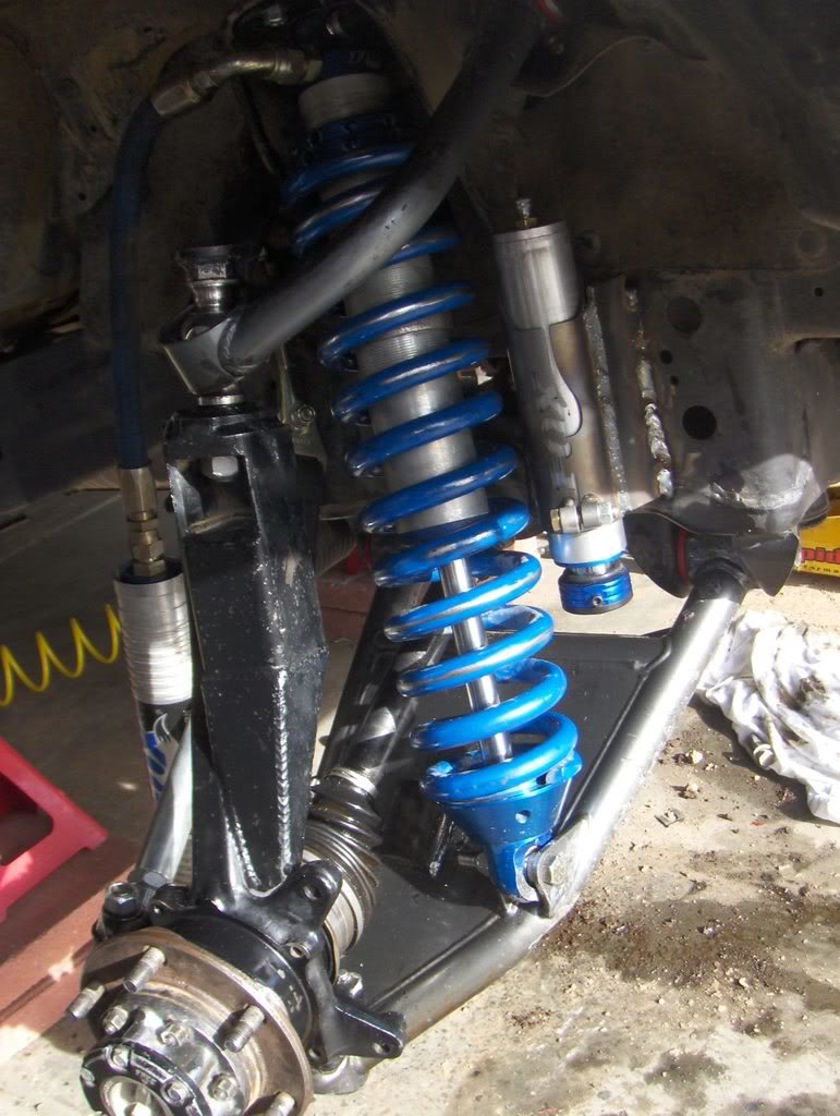

    LOL, nice. King color matched calipers. :p

    Yep, everything is blue or black (except the lettering on the grabbers:mad:)

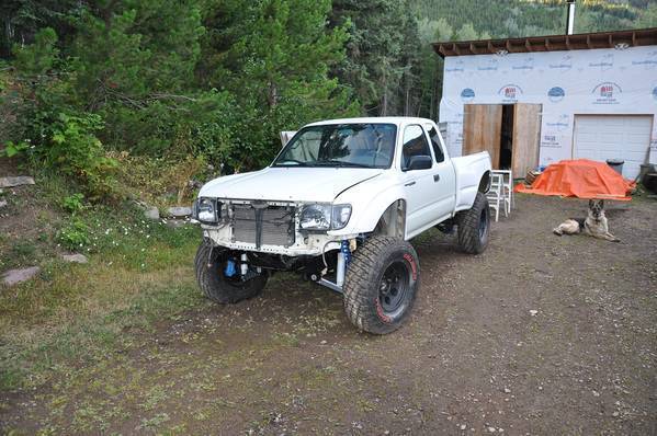

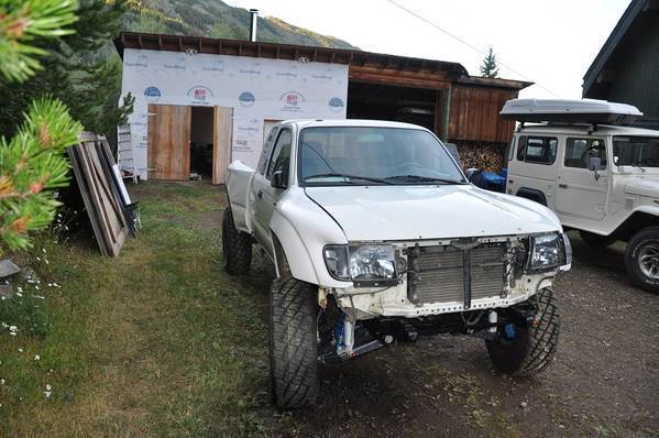

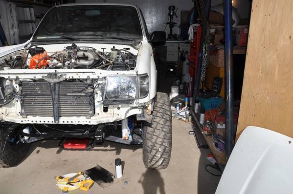

    Ok lots has been happening, but theres still so much to do.
    Put my cab back on.
    Heres the tire sticking out of the stock fender.
    Aw yeah:cool:
    Took my fenders and bedsides off and placed my flares on, but they are not fitted or attached yet. The bedsides stick up higher than they'll sit.
    So its coming along, nothing is really permanent yet but its getting closer.

    Holy hell you have been busy. It looks like a truck again.

    Well, the engine is only half hooked up and theres no gas tank:p so its looks only. You've been busy too, busy spinning lies. You had me worried.

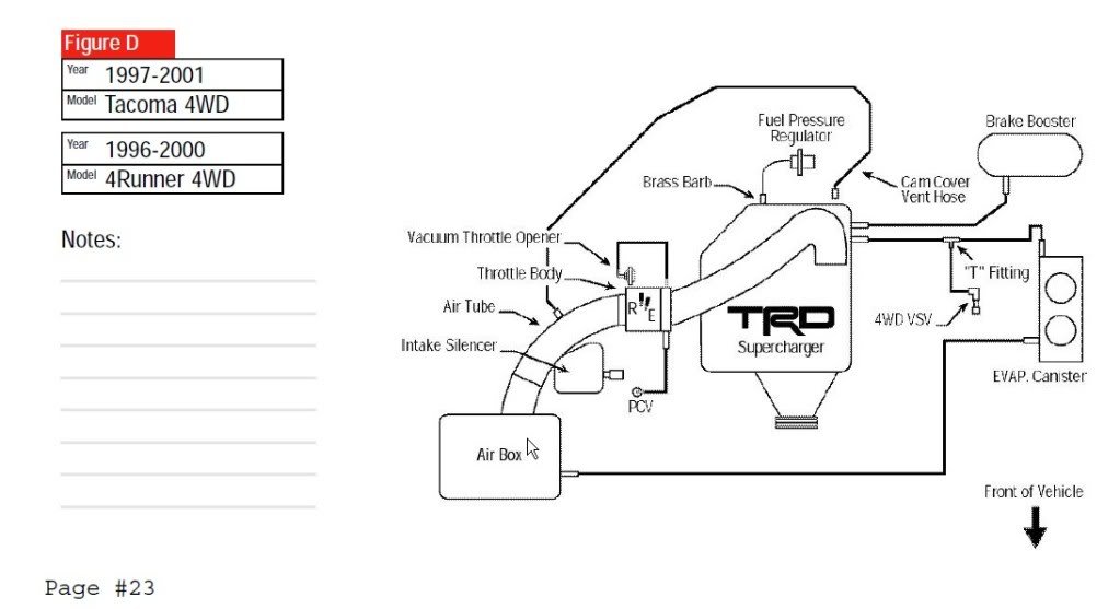

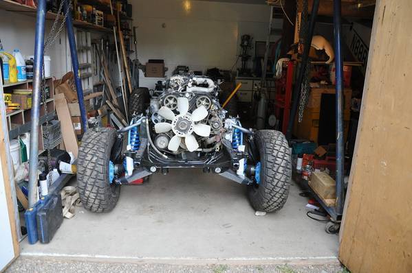

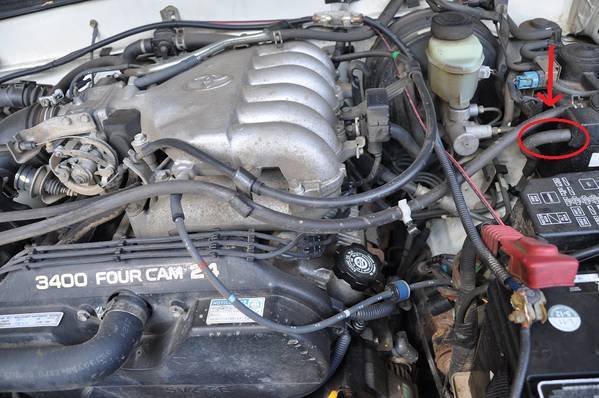

    So...
    I took lots of pictures before I pulled my truck apart, but...
    I don't know where this hose goes. Derp.
    If someone could tell me where the other end of this hose attaches/drains/does something, that would be fantastic.

    Maybe this will help. Pretty sure it just goes to the airbox. Just replace the supercharger with intake plenum.
