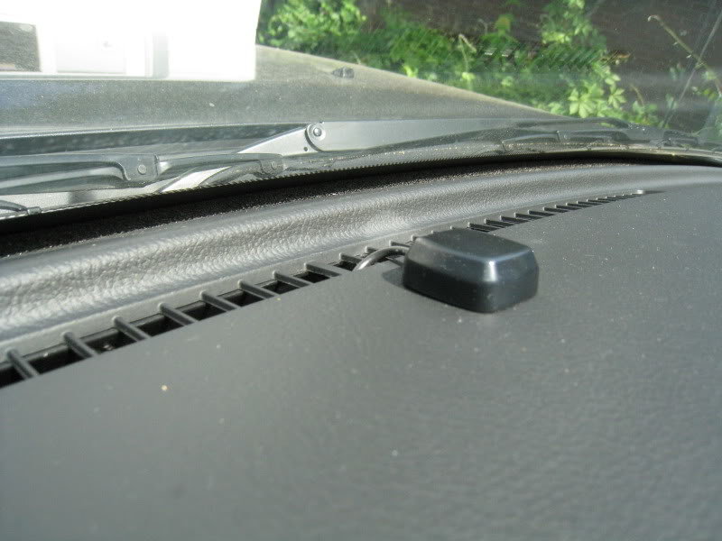

    I popped mine right through the defroster vents and its sits dead center on top of dash. Was a bitch to get the plug end through but with a little patience it can be done.

    I would like to see a close up of this so I can tell where the wire is run if you don't mind. Thanks

    Yea sure here ya go

    I like it, where does the connector end come out?

    under the dash right behind the head unit. You have to send the connector in from the top down, if you feel inside the holes you can feel the duct work for the defrost vent. put your hand through the hu hole. you have to kinda push up on the dash from the inside to create a gap to push it through and do an immediate uturn with the connector. Its a bitch like i said.
    I have a kenwood dnx7160 not sure what the other brands look like or if its even possible with them.
