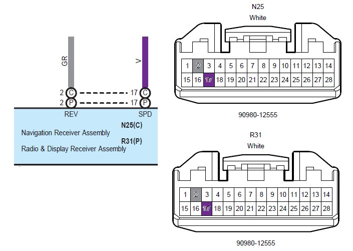

    is there an easy way to get to this wire 17 to cut it? Thanks.

    Short of pulling the head unit, is wire 17 accessible anywhere else that’s easier to get to?

    saw on you tube the head unit is super easy to pull. Remove the nav surround panel just by carefully pulling it off, head unit is held on by 4 bolts, and its easy to get to the 28 pin connector to cut that wire 17. Thanks all!

    this literally took me longer to find the 10mm socket and ratchet and extensions and heat shrink and side cuts, and put those tools away, than it did to do the mod. Thanks all, nav works now while driving and has zero issues upon startup or anytime after the mod.

    So did just cutting wire 17 work? Navigation works fine but no lock when driving?

    Yes and yes. It's a great mod.

    Cutting wire 17 didn't work on my 2019. Technically it did, you could access what was normally grayed out. But my truck stayed in my garage the whole time i was driving. Reconnected the wire.

    Instead of cutting, can you just de-pin the wire? That way it is reversible. But I have just been using voice recog and haven't had an issue yet. It is a little slow though.

    That’s my recollection from the anytime backup camera mod... flipping the switch allowed input, but killed updates. That’s what the switch was for.

    My switch is steady off. It updates.
