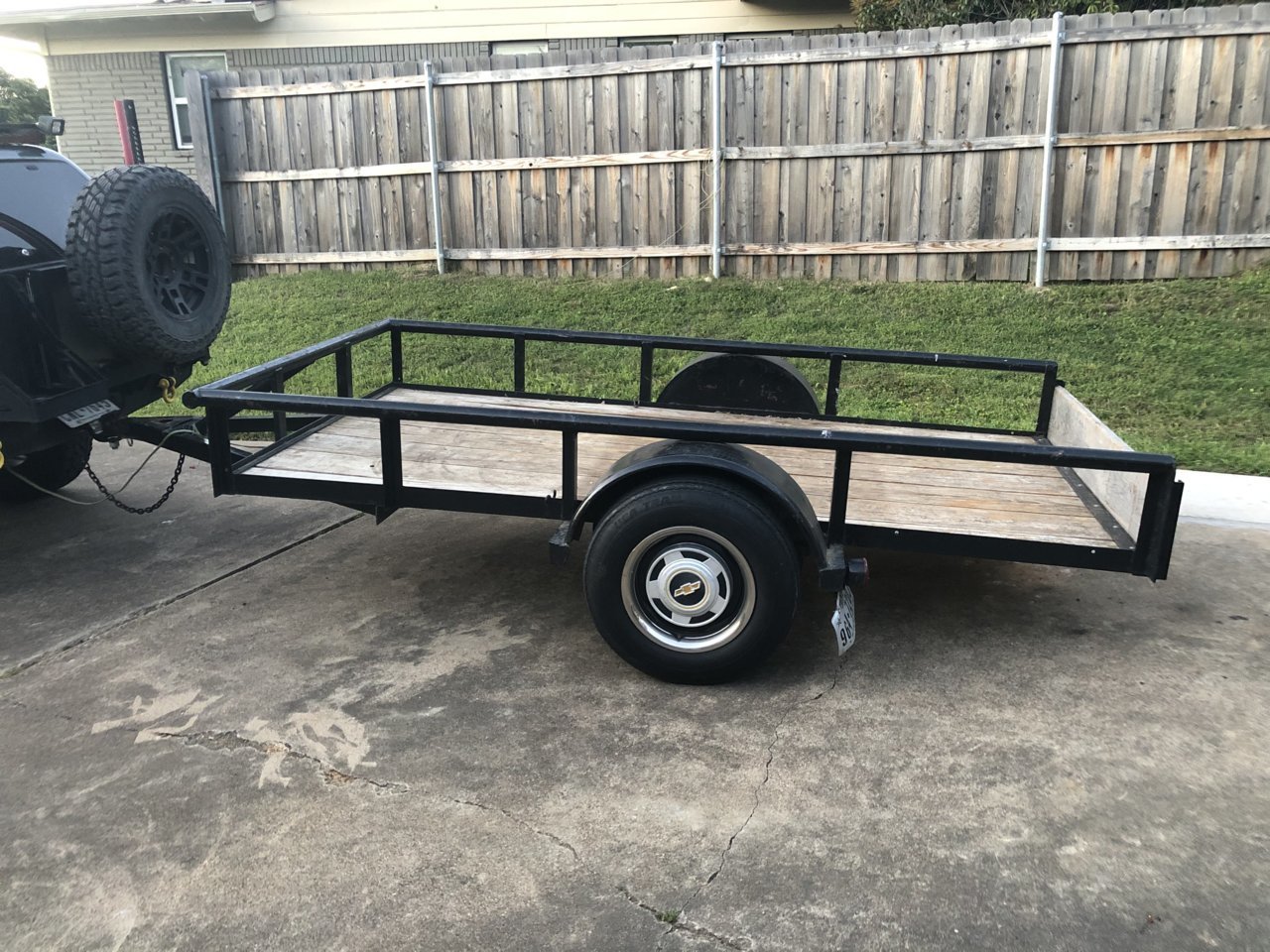

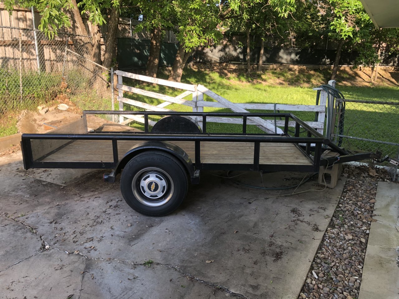

    Started out like this:
    April 16, 2020

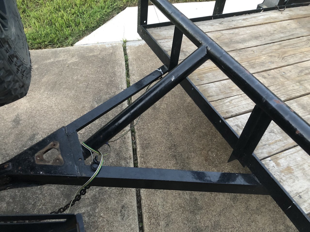

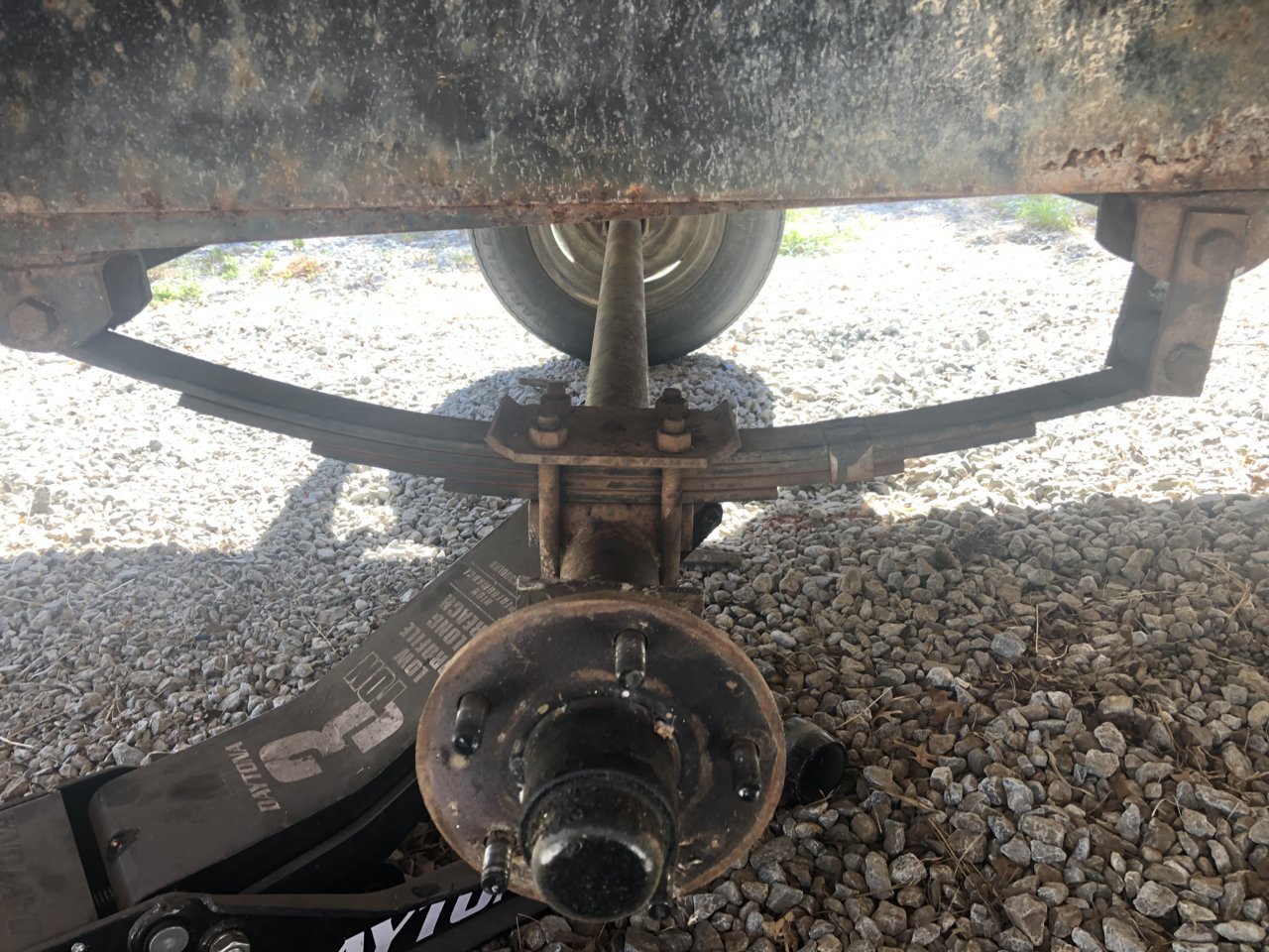

    Once I had it home, I could start making a list of what needed to happen. Elongate the tongue, remake the fenders, move the axle, lose an arm.
    Had to pull off the stock jack to even attach it to my truck. 4D8298FC-11EB-4A5D-8918-42818C8AEEE0.jpg
    Hitch and cross piece also had to go.

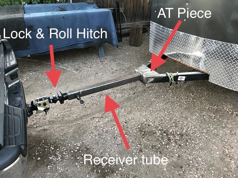

    Something like this would work nicely, so ordered the conversion plate from @atoverandoutsky

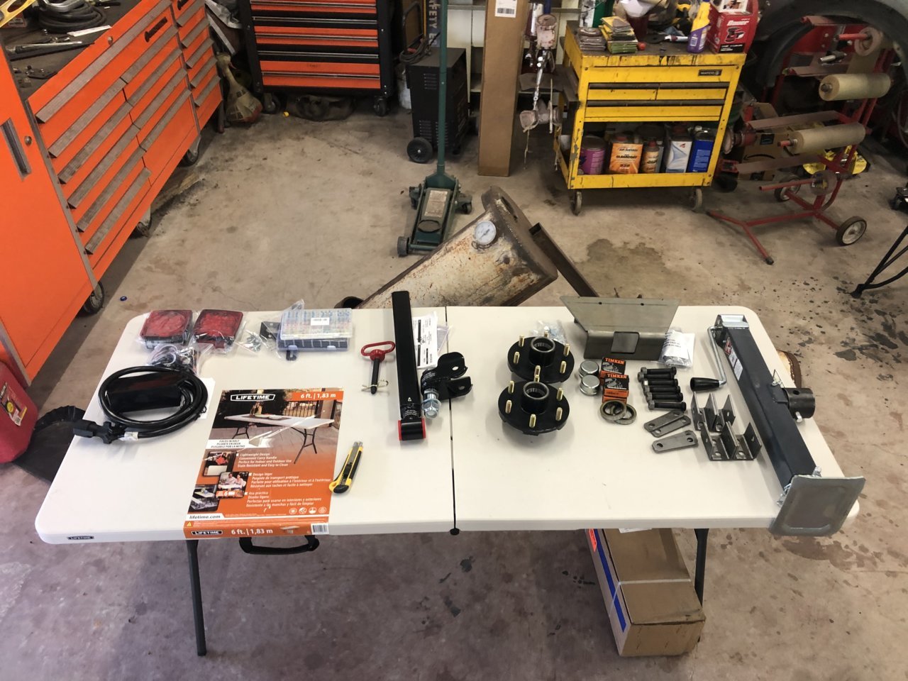

    Axle flip done, time to pull and replace hubs.
    Parts starting to arrive... and they haven’t stopped.
    New hubs, wheels and tires are on. September 15th.
    Big difference.
    Take the trailer out one last time before major mods.
    Time to start cutting the hitch off!
    Grind to make it pretty.

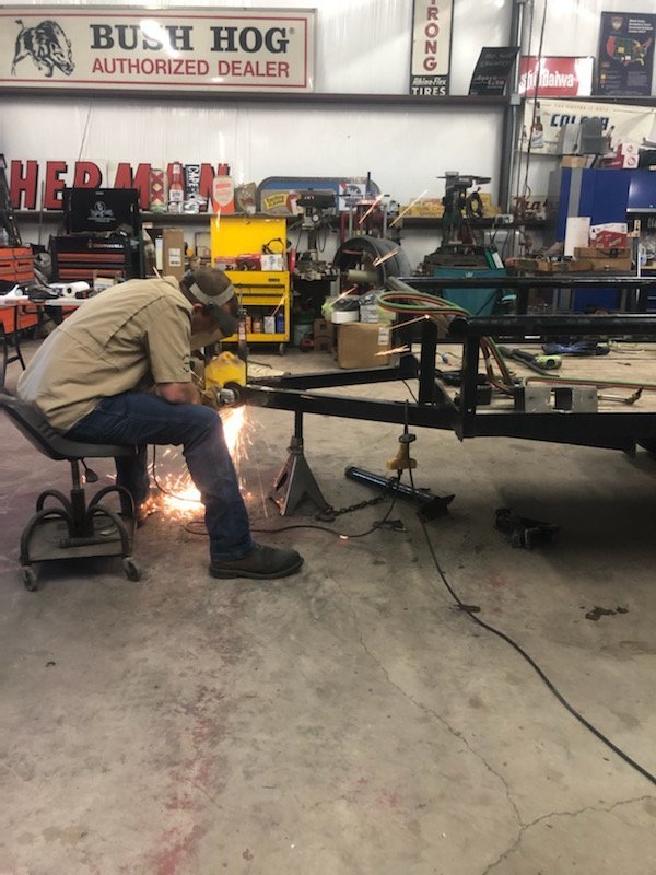

    Tongue extended 32”, better jack tacked on, AT plate in place.

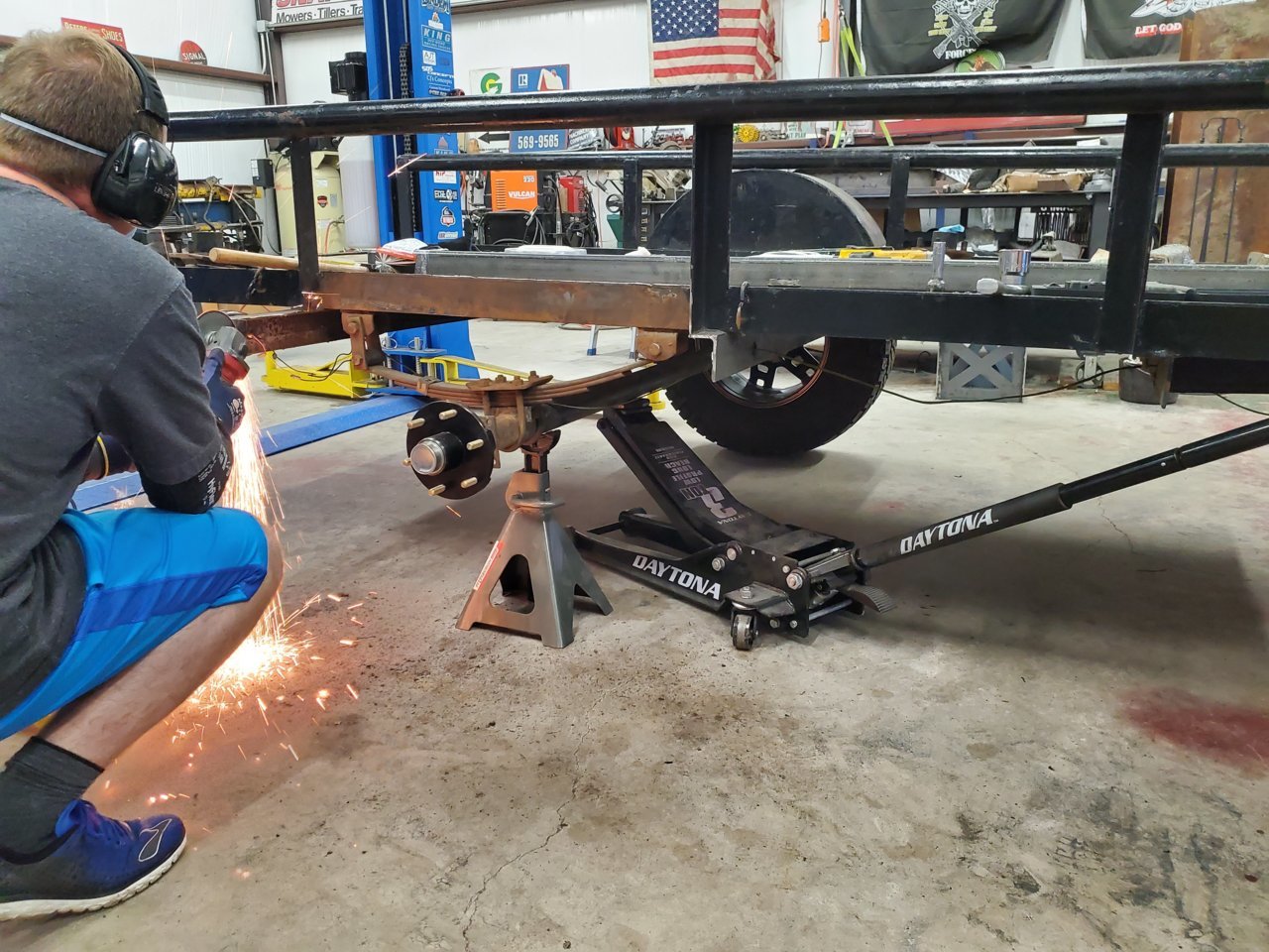

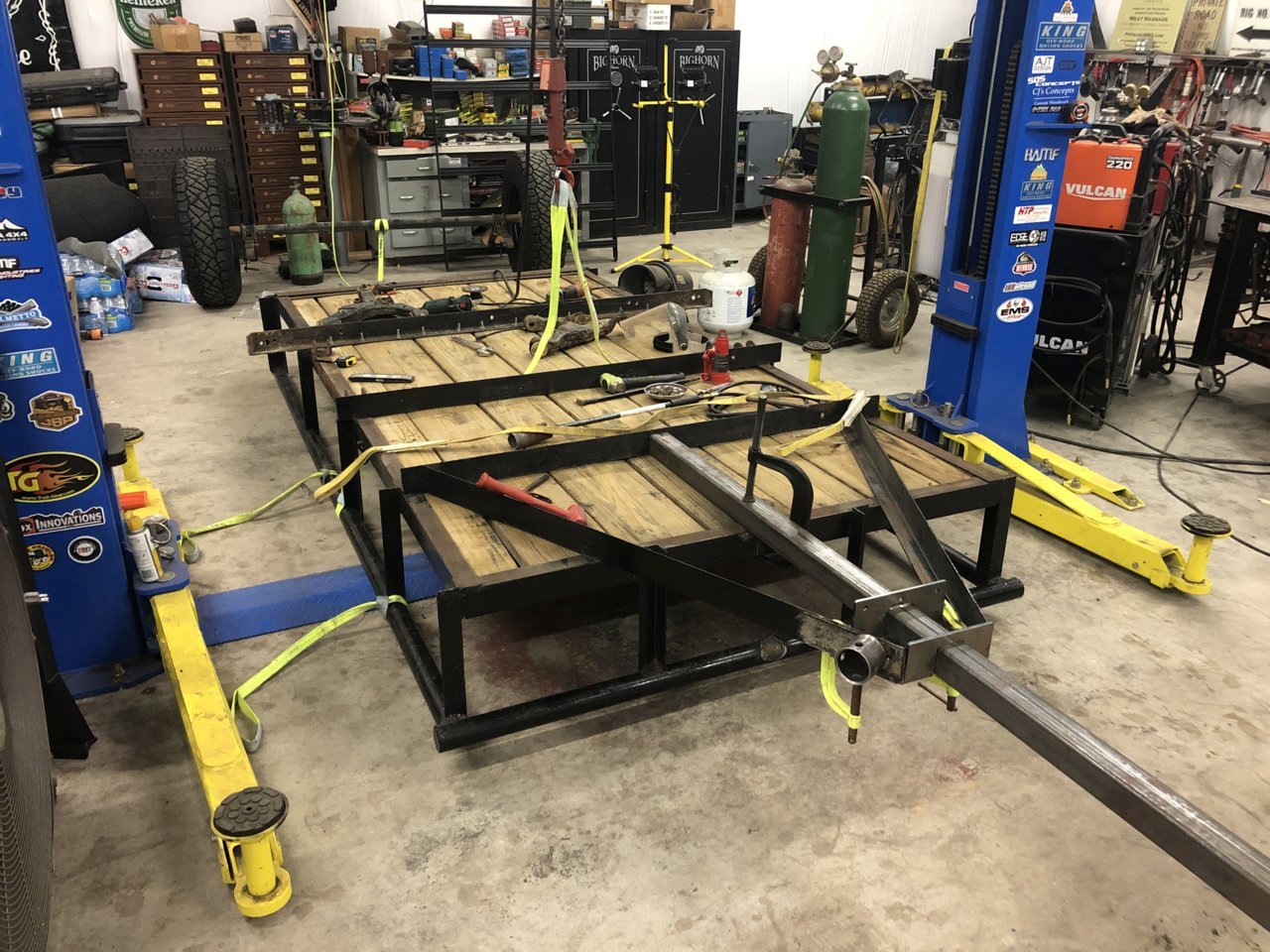

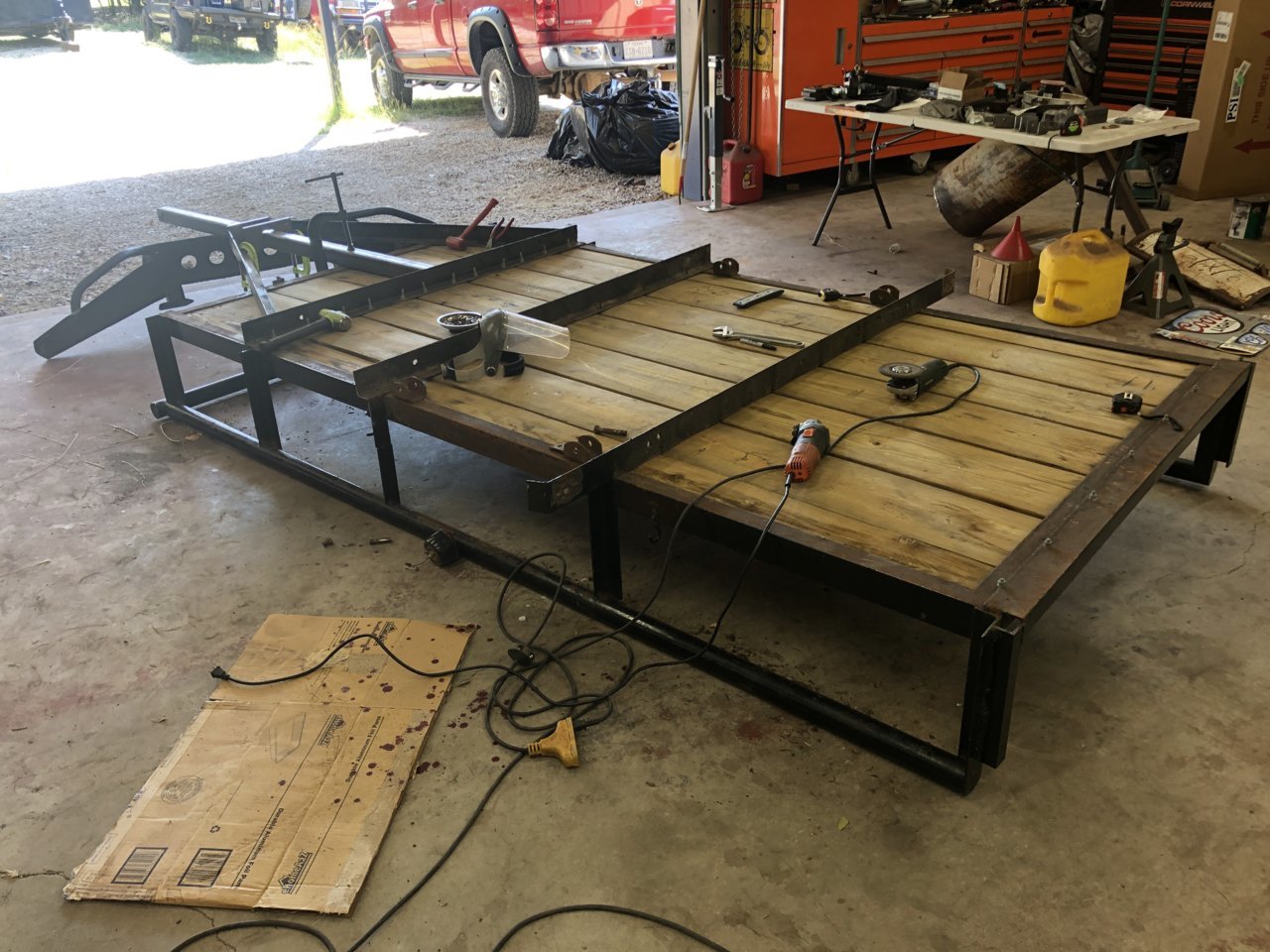

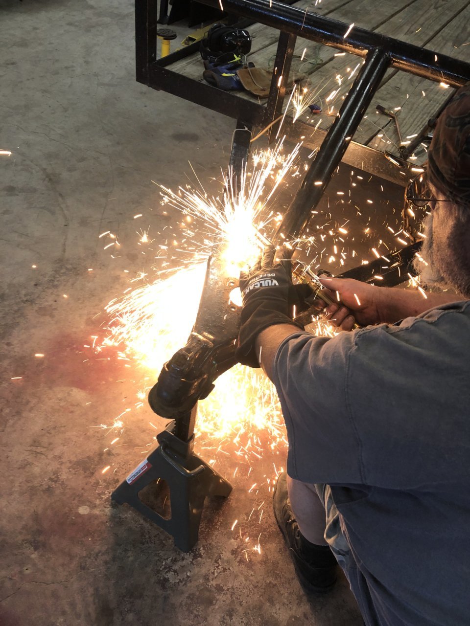

    Flip it and cut off the old suspension hardware. Need to move the axle forward ~5” to counter extra weight. We end up centering it on the body of the trailer.
    Yikes. See the blood? That’s mine. Trailer just got expensive.

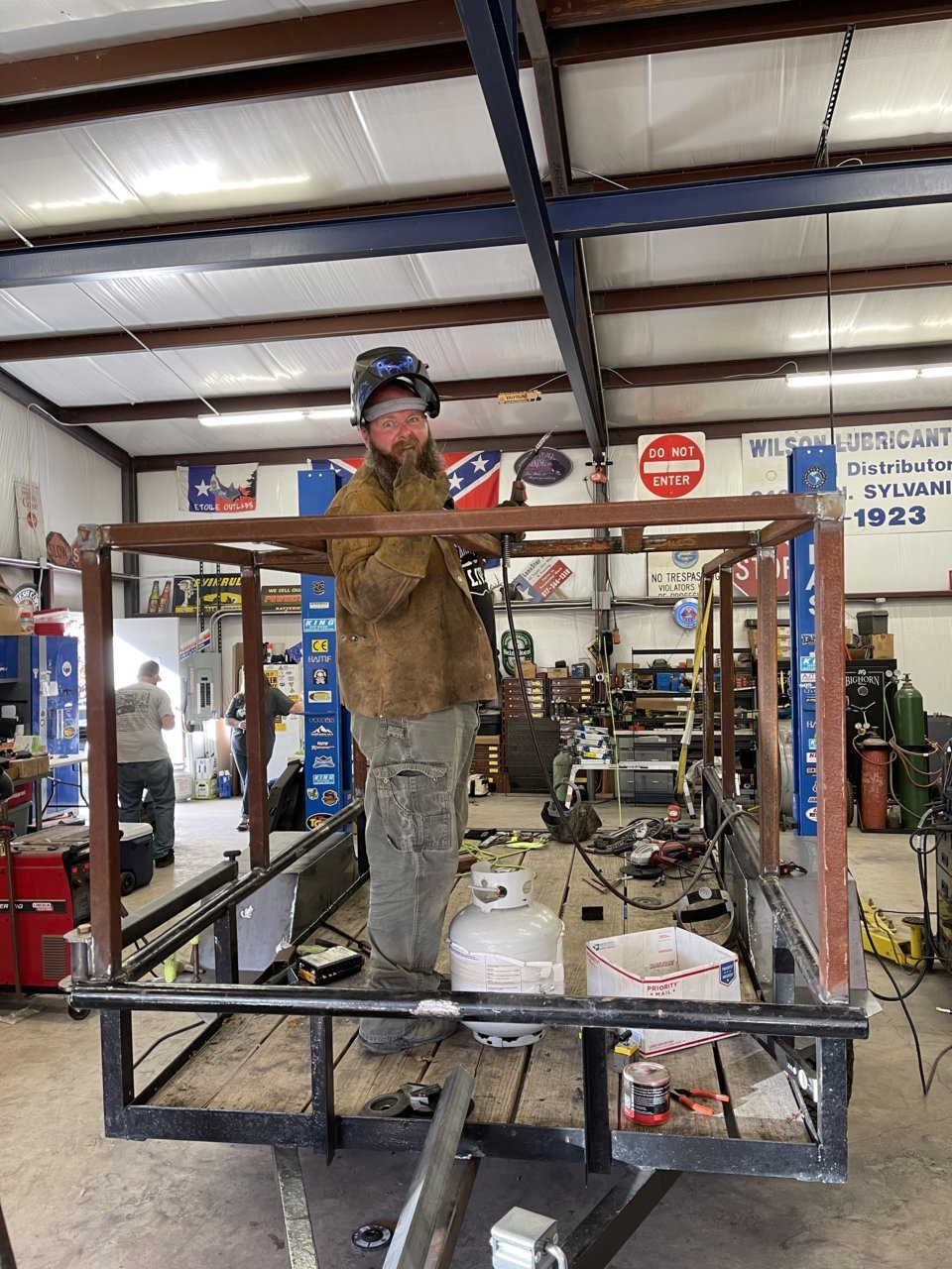

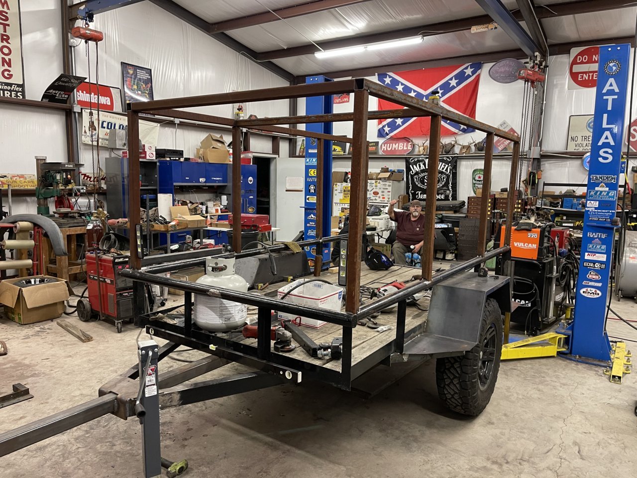

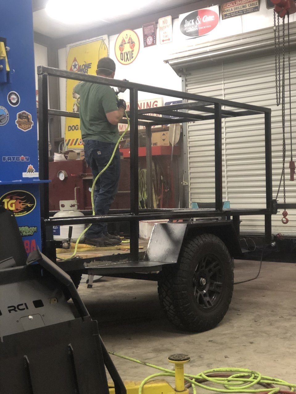

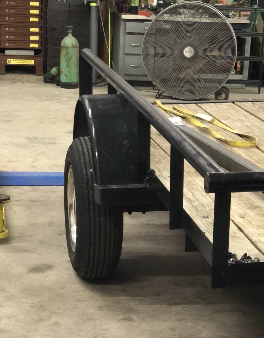

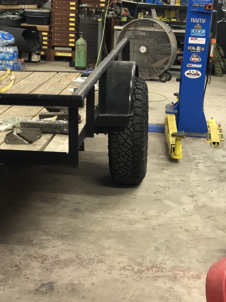

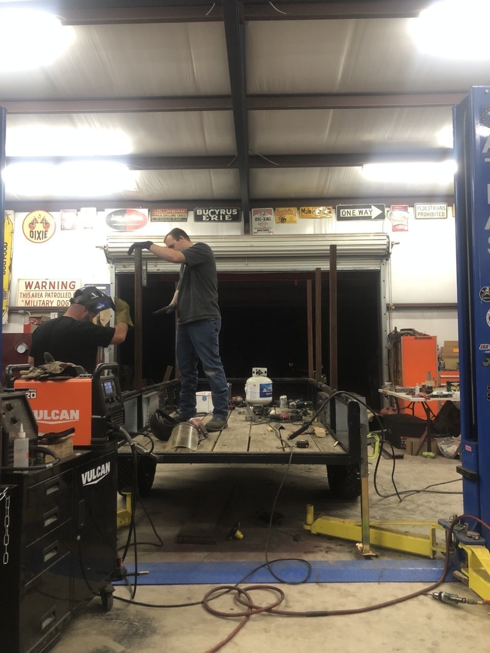

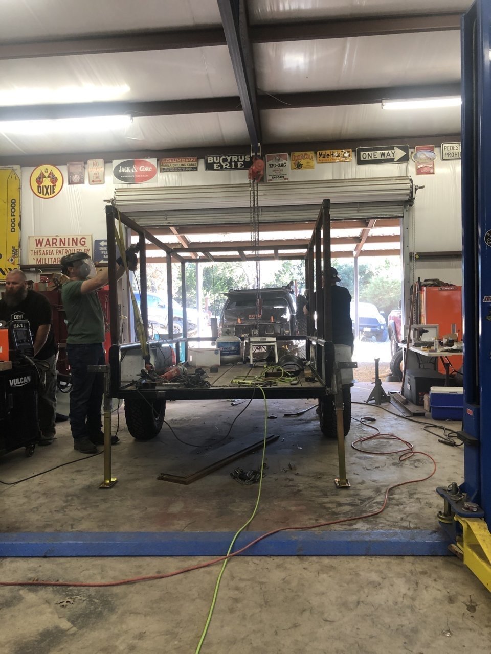

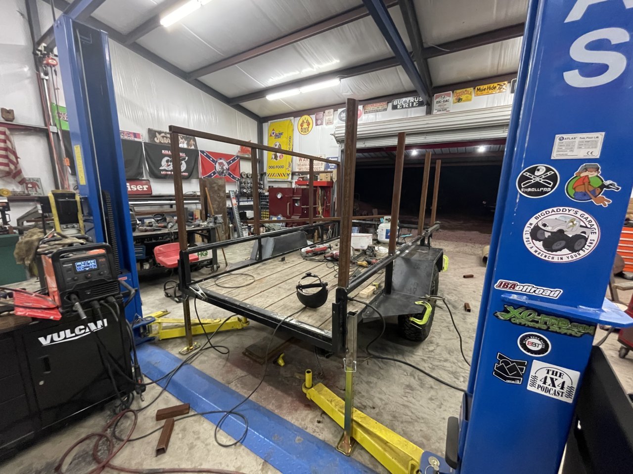

    While I was healing, @Bigdaddy4760 really went to town. Fenders tacked, stabilizers on, axle is back in place.
    Then @Nopro came to town and it was time to get taller.

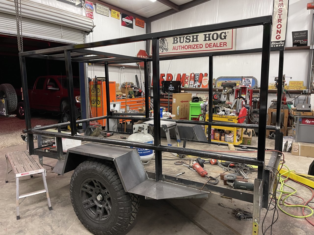

    He loves this. I think. Maybe.
    Gotta test it... and maybe start a calendar.

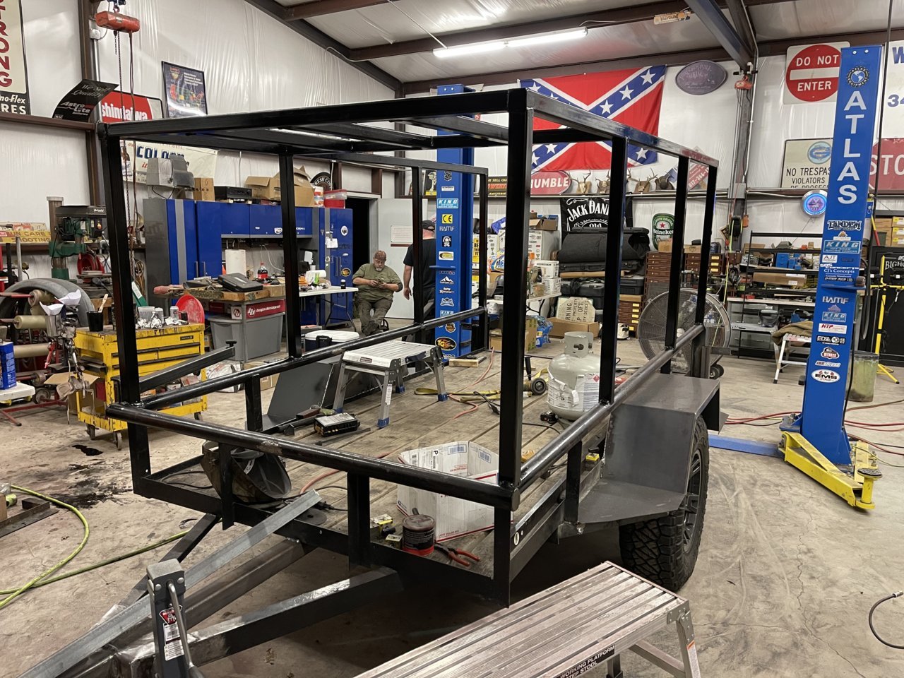

    Grinding all the rust off. Big thanks to @Beef Nachos for the help here.
    And paint! First coat to prevent more rust.
    Paint looks good, this is really coming together.

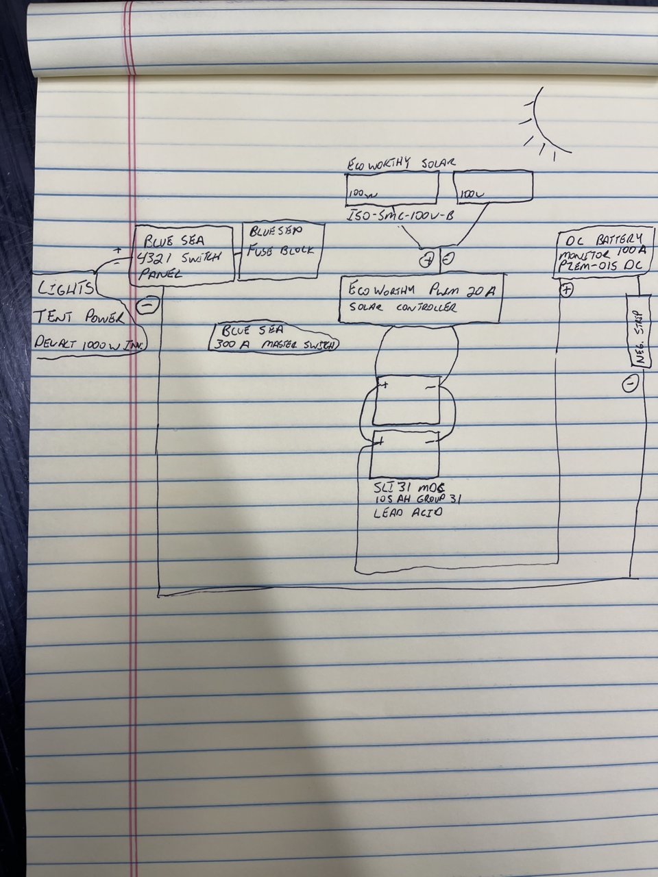

    Any wiring experts out there?
    My solar controller says to wire everything through it, but I’m instead thinking of doing batter hot to blue sea switch -> fuse block.
